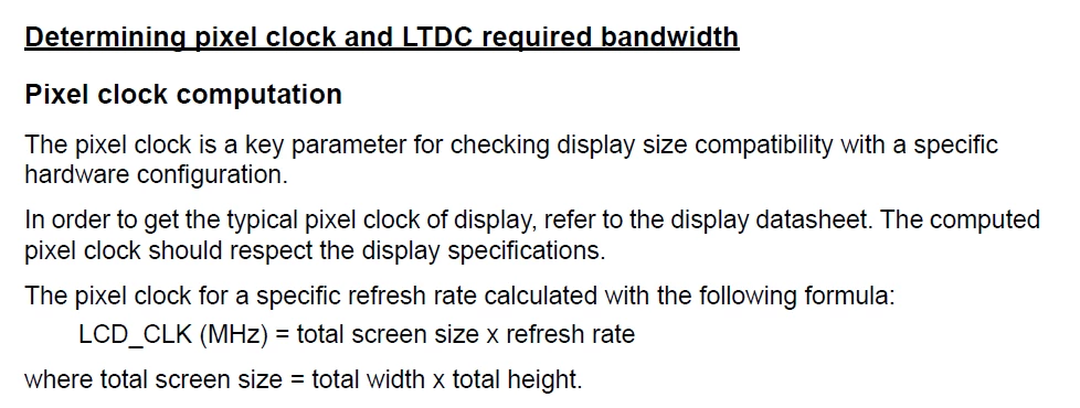

ausera uirwaij
Nov 12, 2022 12:50 AM UTC
I tried 1000ms delay it seems work, but I need 40hz fresh rate at least. I check the LTDC guide which writes:
0693W00000WIA2LQAX.pngAnd total width = 523,total height = 286, so the refresh rate can reach 66.8hz when LTDC clock is 10Mhz, my tft-lcd can work between 8Mhz~12Mhz's clock.
