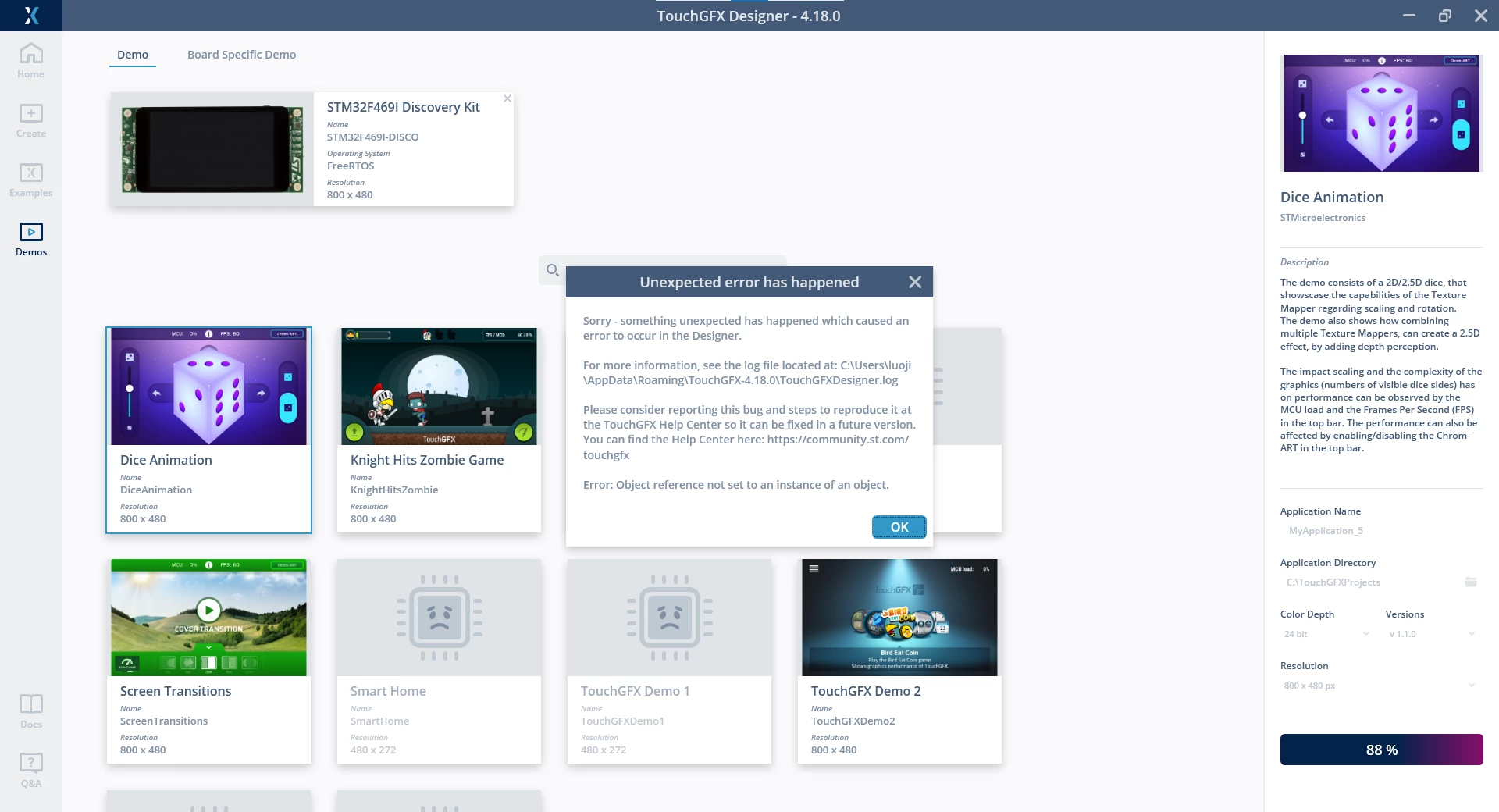

4.18.0 Generate Code Failed
  • November 15, 2021
  • 975 views
I created an simulator project, but I can’t run it.
The log is as follows:
Generate Code
 Copy Framework
 Copying TouchGFX framework version 4.18.0 to E:\ljc\Projects\STM32Projects\touchgfx_test\Middlewares\ST\touchgfx
 Done
 Generate
 Wrote config/gcc/app.mk
 Wrote config/msvs/Application.props
 Wrote generated/gui_generated/include/gui_generated/common/FrontendApplicationBase.hpp
 Wrote generated/gui_generated/include/gui_generated/common/FrontendHeapBase.hpp
 Wrote generated/gui_generated/include/gui_generated/common/SimConstants.hpp
 Wrote generated/gui_generated/include/gui_generated/screen_screen/screenViewBase.hpp
 Wrote generated/gui_generated/src/common/FrontendApplicationBase.cpp
 Wrote generated/gui_generated/src/screen_screen/screenViewBase.cpp
 Wrote generated/simulator/gcc/Makefile
 Wrote generated/simulator/include/simulator/mainBase.hpp
 Wrote generated/simulator/include/simulator/video/DirectFrameBufferVideoController.hpp
 Wrote generated/simulator/include/simulator/video/MJPEGDecoder.hpp
 Wrote generated/simulator/include/simulator/video/SoftwareMJPEGDecoder.hpp
 Wrote generated/simulator/msvs/touchgfx_prebuild.targets
 Wrote generated/simulator/msvs/touchgfx_sdl2.props
 Wrote generated/simulator/msvs/touchgfx.props
 Wrote generated/simulator/src/mainBase.cpp
 Wrote generated/simulator/src/video/SoftwareMJPEGDecoder.cpp
 Wrote generated/simulator/touchgfx.ico
 Wrote generated/simulator/touchgfx.rc
 Wrote generated/simulator/touchgfx.res
 Wrote gui/include/gui/common/FrontendApplication.hpp
 Wrote gui/include/gui/common/FrontendHeap.hpp
 Wrote gui/include/gui/model/Model.hpp
 Wrote gui/include/gui/model/ModelListener.hpp
 Wrote gui/include/gui/screen_screen/screenPresenter.hpp
 Wrote gui/include/gui/screen_screen/screenView.hpp
 Wrote gui/src/common/FrontendApplication.cpp
 Wrote gui/src/model/Model.cpp
 Wrote gui/src/screen_screen/screenPresenter.cpp
 Wrote gui/src/screen_screen/screenView.cpp
 Wrote simulator/gcc/Makefile
 Wrote simulator/main.cpp
 Wrote simulator/msvs/Application.sln
 Wrote simulator/msvs/Application.vcxproj
 Wrote simulator/msvs/Application.vcxproj.filters
 Done
 Generate Assets
 make -f simulator/gcc/Makefile assets -j8
 'MySQL' �?是内部或外部命令,也�?是�?��?行的程�?
 或批处�?�文件。
 或批处�?�文件。
 Failed
 Failed
I tried demos and examples and got the same error.
'MySQL' is not an internal or external command, nor is it an executable program or batch file.
I don't know how to solve it, can anyone help me?:loudly_crying_face:

0693W00000GXXhhQAH.pngAn exception occurred when I opened the demo.

JLuo.3
JLuo.3Author
November 15, 2021
I solved this problem myself.
The reason is that mysql is installed on my computer, and everything is normal after uninstalling.
