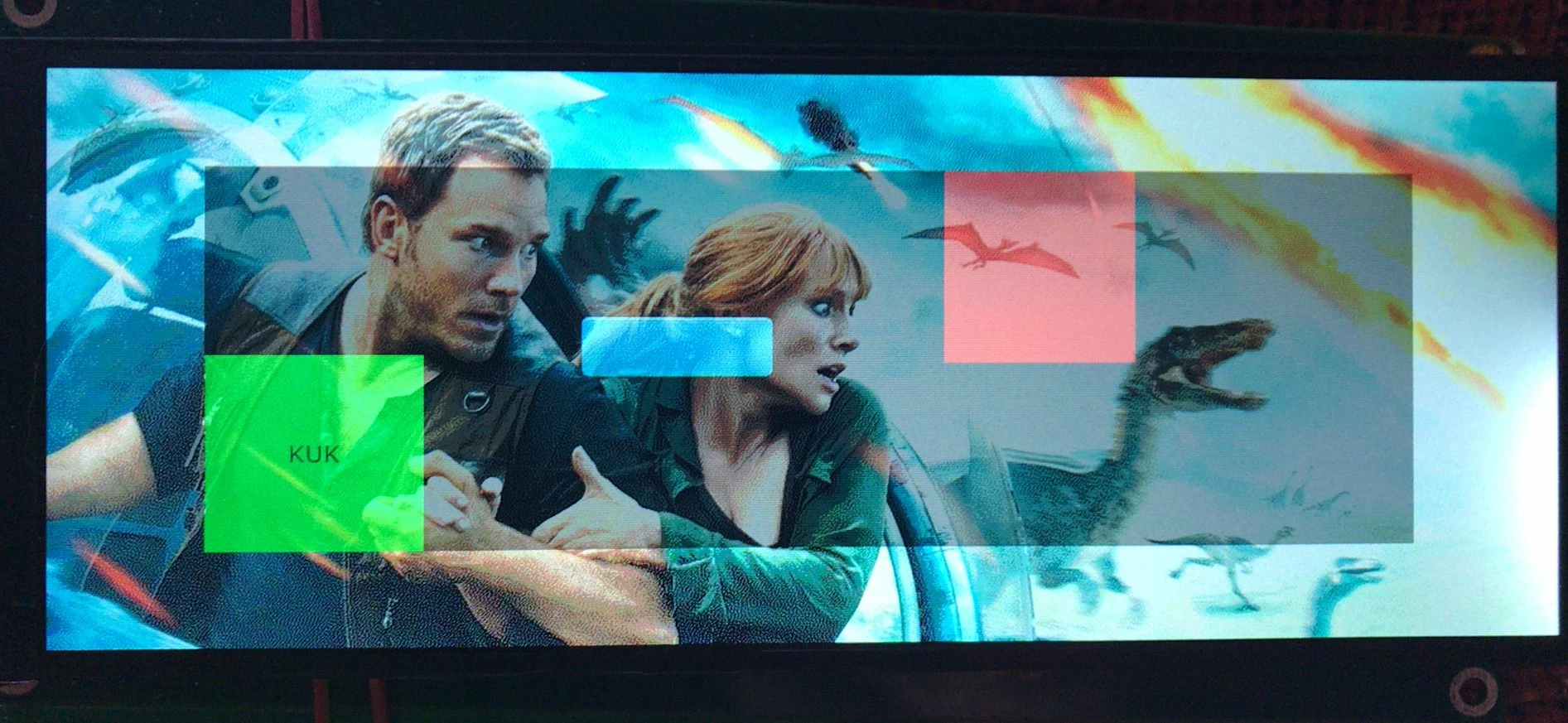

Sep 12, 2022 5:23 PM UTC
0693W00000AMRWmQAP.jpgMaybe you need more study DMA2D is for migrate + convert data from one place to other .
Layers and buffers is different things.
And LTDC is hw interface between memory and RGB type LCD...
About HW JPEG speed is next pdf...
and ofcourse you mean 320x240...
One my example F469 320KB internal SRAM LCD 1280x480
SRAM dynamic area Layer 1 1024x320 L8 color palete
FLASH (internal or QSPI) Layer 0 1280x480 static image background RGB888
