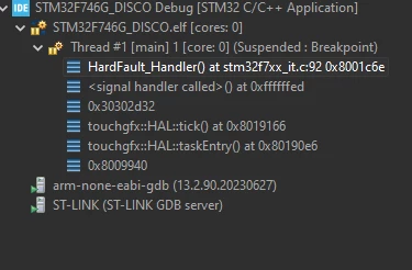

I am developing an application on the 32F746GDISCOVERY board. The application reads data from a Python script that send certain strings to the MCU via USB connected to the USART1. The data from USART1 is then passed through the queue to the Screen1View where it is displayed in the TextArea field. Once this is done, the MCU sends a reply back to the "Python script" and then a new command is executed.
The application runs fine for some time, but after a few seconds, the hard fault handler is called. Here is the function stack:
I currently do not know what is located at the address 0x30302d32. Does anyone have any insights on this?
Also looking at the memory map, the address 0xffffffed is associated with the Cortex M7 internal registers and there should not be a function call to it, right?
I have found a relatively similar post about this here, but it suggests increasing the stack size. Looking in the stack size of the task the default value is 4096 bytes, which is more then enough of memory I would say.
Can anyone help me with this? Thanks in advance.

Sorry for my incomplete post - I am trying to find my bug in the application. I am playing with the TouchGFX capabilities and trying to understand how to develop an application. In TouchGFX designer I have created 4 text areas where I am trying to update them with the python script. When I press the USER button from the Discovery board, the communication starts - the Discovery sends a command via USART to the Python script and then the Python script replies with a string response. When this string response is received, it is passed to the Screen1View where data extraction is performed and this data is updated in the text areas. A new command is then sent to the PC after the view updated the text area. It is a closed loop between the Python script and the Discovery Board.
What happens when you increase the stack size as the post suggest ? What state is your board on when the error occurs?
I have increased the stack size to 5120 bytes and the error still occurs. This is a huge stack size for an embedded application. However, the error is very sporadic. Sometimes it somehow misses the command from the Python script and waits there. When I press the USER button again , it starts from the begging again. I can do this couple of times before a hard fault is happening.  Other times it jumps directly in the hard fault after the timeout as shown in the picture above.

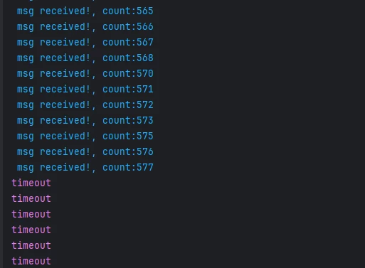

The Python script simply listens for the command, responds to it and then listens again. The serial library has a timeout. Of course, if no data is received in that time, a timeout text is generated. Here is the code:

Here is the image of the python script output:

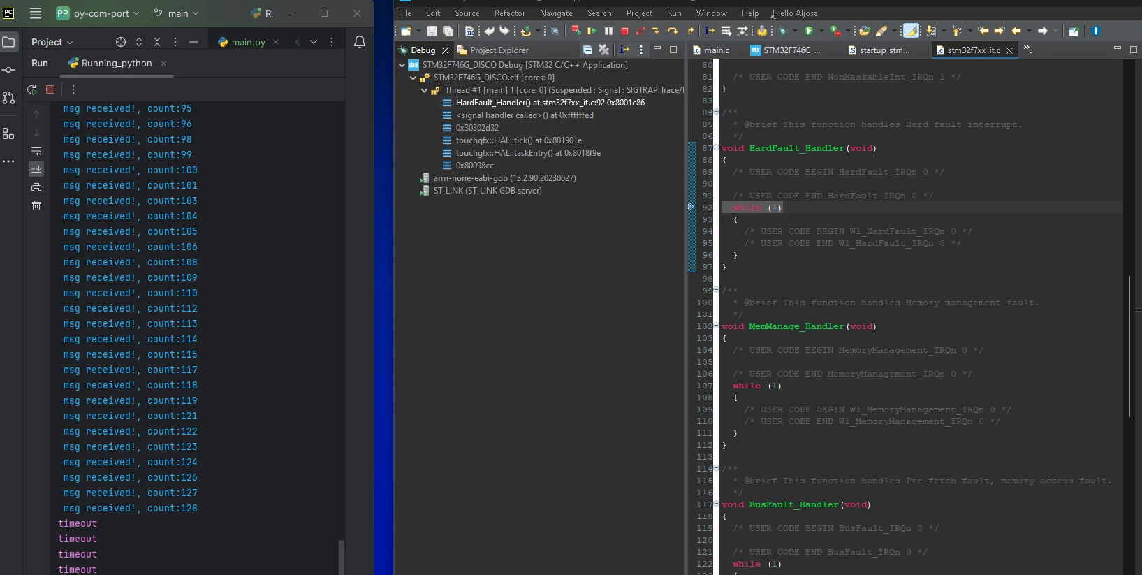

Here is also an output, where the discovery jumped after the first timeout:

I am using the arm-none-eabi-gcc and arm-none-eabi-c++ compilers respectively. I think it always happens when the TouchGFX_Task is called. However, I cannot find out exactly where in the code it is because the developer of TouchGFX defined as a virtual function and finding out exactly where the declaration is linked to is a bit of a challenge for me.
Stack getting trashed with ASCII string data,ie "2-00"
Look for where you have ridiculously large auto/local variables or arrays.
Add some stack depth checks, so you can isolate / bisect the issue. ie fill stack with a pattern and determine a low-water mark for how far it descends.
waclawek.jan
Jun 15, 2024 7:14 AM UTC
+1 to "2-00", but not necessarily at stack - i.e. it may be not just return to thrashed stack content, but also indirect jump to corrupted function pointer.
Look at disasm (best mixed with C) couple of instructions before the offending address (0x8019166) to find out, which one of these it was.
