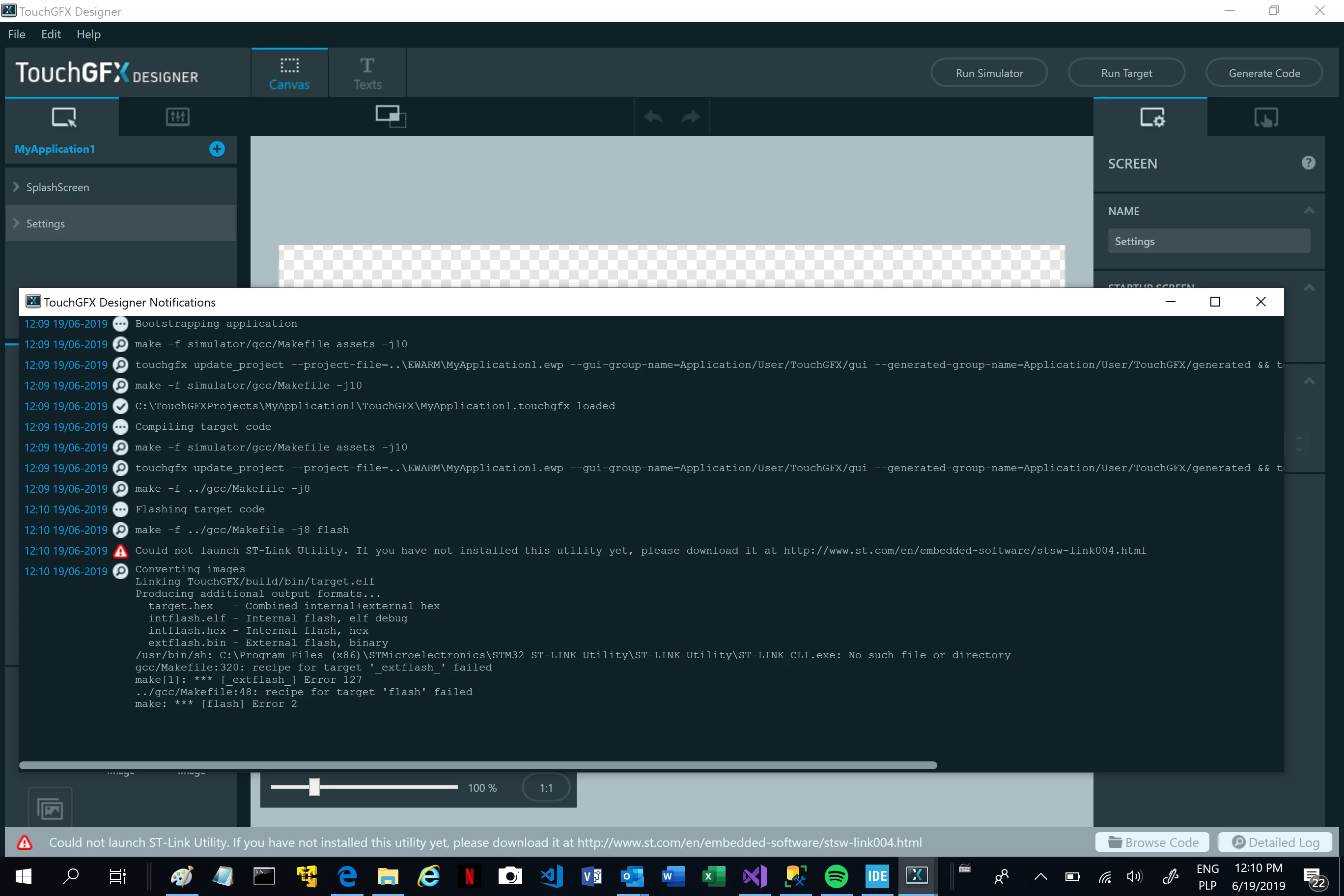

1. TouchGFX Designer looks for ST-Link utility in:
C:\Program Files (x86)\STMicroelectronics\STM32 ST-LINK Utility\ST-LINK Utility
while recent ST-Link version gets installed in:
C:\Program Files (x86)\STM32 ST-LINK Utility\ST-LINK Utility
and different folder selection during installation is not even an option.

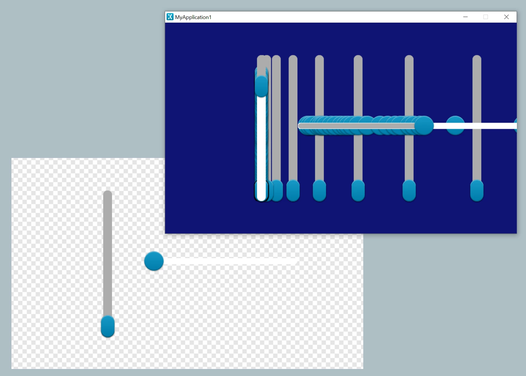

2. Slider control has a bug, handle leaves a trace while moved - both in emulator and on STM32F769i-DISCO. See screenshot.

1) I'll investigate. Could you show me a log/screenshot of the error you're getting?
2) It's not a bug =) You're missing a background. Right now you're basically drawing (and invalidating) on top of garbage data in the framebuffer which will leave "traces". It's a common mistake by users and we've considered always adding a default background to avoid confusion.

1. Screenshot attached. Btw, line-wrapping may be a good log viewer improvement.
2. OK, let's call it a feature:) Although I think in YouTube presentations it worked as expected without additional settings.

  1. Thanks. We're discussing options for this. The path is hard coded in the Makefiles.
  2. It's a feature for now, at least : ) Maybe we'll do something to notify the user that unmodified framebuffer memory is visible.
