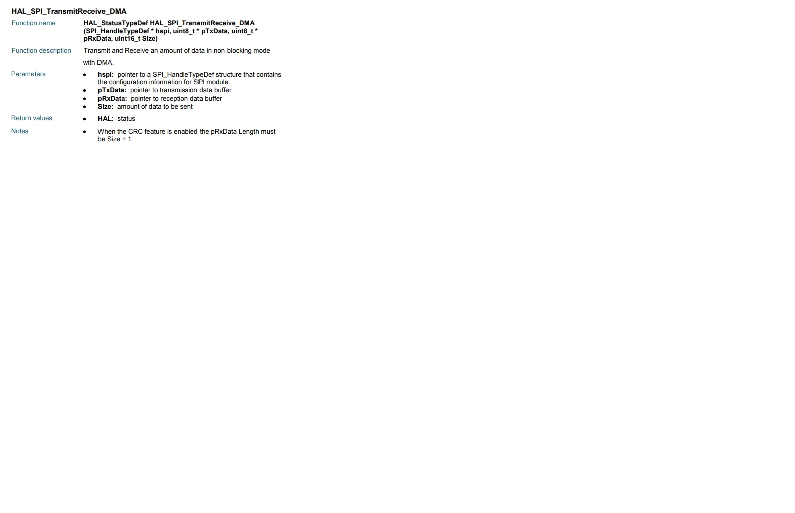

When I set my SPI to full duplex mode and CRC is enabled then what should be the value of bufferSize in HAL_SPI_TransmitReceive_DMA(&hspi1, (uint8_t*)aTxBuffer, (uint8_t *)aRxBuffer, bufferSize ) function?
for ex size of buffers is 4 bytes (excluding CRC bytes). Then What should be the value of bufferSize in following function?:
HAL_SPI_TransmitReceive_DMA(&hspi1, (uint8_t*)aTxBuffer, (uint8_t *)aRxBuffer, bufferSize ).
Note: CRC is enabled on both master and slave side.

The question I think relates to the awkward mechanics of the CRC generation and checking on the SPI bus, for which I'm not aware of any robust examples.
I see ZERO test cases across a number of libraries. If the hardware and software has been validated, please provide a working proven example using a real world component supporting CRC via SPI. Thanks. @STOne-32​
 * @brief Transmit and Receive an amount of data in non-blocking mode with DMA.
 * @param hspi pointer to a SPI_HandleTypeDef structure that contains
 *              the configuration information for SPI module.
 * @param pTxData pointer to transmission data buffer
 * @param pRxData pointer to reception data buffer
 * @note  When the CRC feature is enabled the pRxData Length must be Size + 1
 * @param Size amount of data to be sent
 * @retval HAL status
HAL_StatusTypeDef HAL_SPI_TransmitReceive_DMA(SPI_HandleTypeDef *hspi, uint8_t *pTxData, uint8_t *pRxData,
                                             uint16_t Size)

Regarding this request, and at this time, there is no STM32 board with a SPI chip supporting CRC.
So, there is no plan to support this request.
Regarding the buffer Size question: Inside HAL, the buffer length for transmission/reception is excluding the CRC size. CRC is received and computed directly by the SPI peripheral and this is transparent for user.
If CRC receive is not well, an error is generated, otherwise, HAL_OK is returned by the API.
