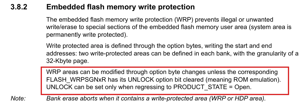

In RM0481 rev 4 April 2025 I find the following text:
7.6.8 Write protection
A write-protected group of sectors cannot be erased nor programmed. As a result, a bank
erase cannot be performed if one group of sectors is write-protected, unless a NVSTATE
transition to OPEN is triggered (erasing the whole user flash memory).
It is not clear what NVSTATE is in this context. Is this a left-over from documentation of a different MCU?
I don’t think it is PRODUCT_STATE. Because to my understanding you can have a PRODUCT_STATE > OPEN and not enable TrustZone and then write to FLASH_WRP1R_PRG to turn off write protection - you should be able to do a bank erase on bank 1. You can set initial values with an OB but I can’t see any documentation that this also makes changing FLASH_WRP1R_PRG illegal and the relevant OBs are not protected by PRODUCT_STATE the same way as e.g. SECWM and HDP.
Same reasoning for flash bank 2.
And if you enable TrustZone, it is stated that FLASH_WRP[1, 2]R_PRG is non-secure. So as long as you don’t set part of the flash to secure watermarked, bank erase should work.
Also note that a AFAIK a regression of PRODUCT_STATE do not restore the WRP OBs to their default state.
The only other place NVSTATE is mentioned in RM0481 is in Table 507 TAMP interconnection:
tamp_itamp6     JTAG/SWD access when NVSTATE ? OPEN
Here, “NVSATE” should be “PRODUCT_STATE”?
  Best regards, Jesper

This is a feedback for the team:
“Based on the content of section 3.8.2 Embedded flash memory write protection of RM0481, the WRP is intended to prevent any unwanted write or erase operation on specific Flash areas, and this protection follows a content immutability logic. The WRP configuration can no longer be modified when the product is in PRODUCT_STATE = TZ-Closed, Closed or Locked, and in particular it is no longer dynamically modifiable in CLOSED state.
When a firmware is defined as immutable, the WRP is set together with the CLOSED state, which means that it is no longer possible to modify either that code or the WRP configuration afterward. In such a case, a firmware update can only be performed in a Flash area that is not write-protected.
