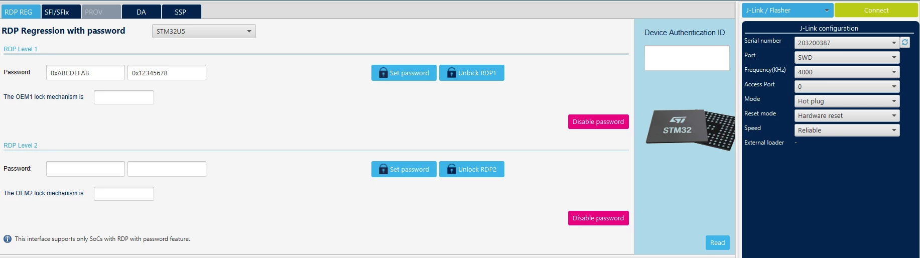

Here’s a screenshot of my settings in the GUI tool, all the settings line up with my CLI arguments as far as I can tell:
My IWDG and WWDG option bytes are also checked, so the watchdog shouldn’t be interfering with the unlock process.
Am I missing something? Are there any other steps I need to perform to unlock RDP1 through the command line?

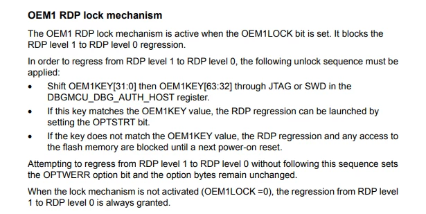

According to RM0456, section 7.6.2, RDP protection state, OEM1 RDP lock, to regress from RDP1 to RDP0 when RDP1 is locked, the following sequence must be applied:
  • Unlock the RDP 1 using OEM1Key.
  • Perform the RDP regression
Therefor, as the AN5347 section10: Demonstration of RDP transitions using OEM keys on STM32U5, demonstrated, specifically step 11 and step 12.  This is the process to follow:
1- First unlock the RDP level 1 using RDP OEM1KEY
STM32_Programmer_CLI.exe -c port=JLINK mode=hotplug -unlockrdp1 0xABCDEFAB 0x12345678
2- Then perform RDP regression
STM32_Programmer_CLI.exe -c port=JLINK mode=hotplug -ob rdp=0xAA tzen=0
