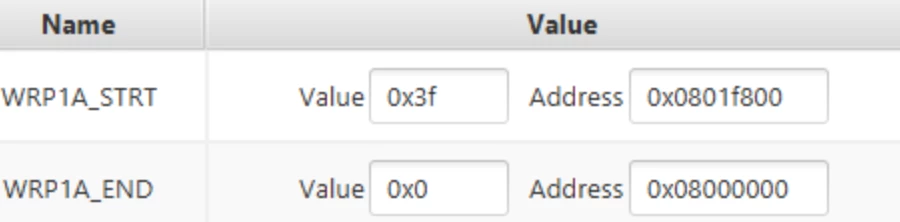

Unable to disable write protection on an STM32G431K using CubeProgrammer
I am trying to disable the write protection on an STM32G431K (on a Nucleo-G431KB) by settings the option bytes using CubeProgrammer:
However, “Apply” fails with the log showing:
11:14:40:365 : Option byte command : -ob WRP1A_STRT=0x3f WRP1A_END=0x0
11:14:40:367 : qCmd : -ob WRP1A_STRT=0x3f WRP1A_END=0x0
11:14:40:367 : PROGRAMMING OPTION BYTES AREA ...

I then need to power cycle the board to reconnect, and the WRP1A register has not been changed.
Readout protection is not set (level 0) and PCPROP is not active.
Any idea what’s going on here?

I think I have have got the device into an unrecoverable state.
The first two pages hold a boot loader that sets WPR1A to protect itself from being erased if the protection is not set at startup.
Using CubeProgrammer to reset this protection results in an option byte reset, causing the bootloader to run and protect itself again (there should be a check in there to say “don’t enable protection if the last reset was an option byte reset” Doh!
I have tried setting the boot option bytes to stop the bootloader from running:
nSWBOOT0 = 0 (BOOT0 taken from nBOOT0)
nBOOT0  = 1
nBOOT1 = 1 (Boot from system memory)
However, it appears as if my application code still runs.
Is there any way I can recover this? It needs the debug probe to assert reset before the application code gets a chance to run...

I’m not sure what hot plug mode is?
However, I’ve now managed to recover the device by setting RDP to Level 1 and then back to Level 0 - this erased the bootloader that was re-writing WRP1A and I was then able to remove the write protection.

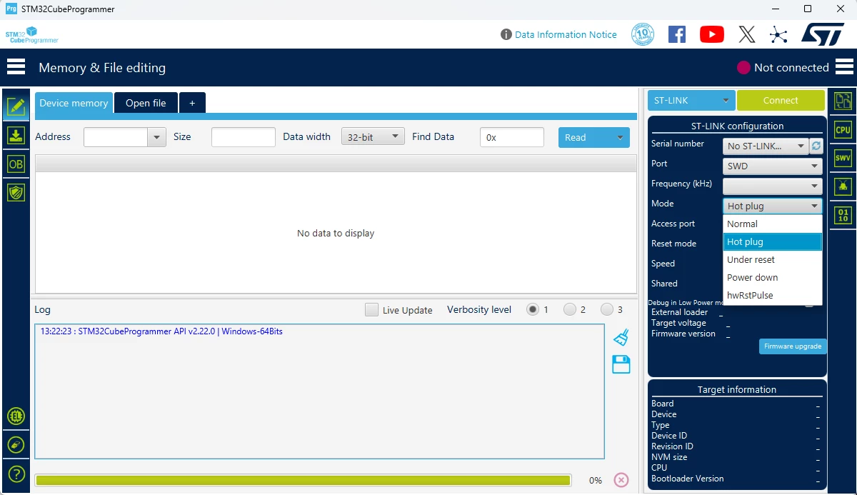

Moktar SELLAMI
Jun 24, 2026 12:54 UTC
Hello ​@CTapp.1 ,
In STM32CubeProgrammer, you can choose the connection mode you prefer when connecting to the device.
The available modes are:
  • Normal: the target is reset then halted.
  • Under Reset: Keeps the MCU in reset state while establishing the debug connection.
  • Hot Plug: enables connection to the target without a halt or reset.
  • Power Down: Used when the target is powered off or in a very low-power state.
  • hwRstPulse: Uses a hardware reset pulse to briefly force the MCU into reset during connection.
In your case CubeProgrammer triggers a reset after updating the option bytes, and target could not be reconnected after that reset. That is why I suggested Hot Plug, which avoids resetting the device during connection.
For more information on CubeProgrammer you can refer to the this UM2237 User manual STM32CubeProgrammer software description.
