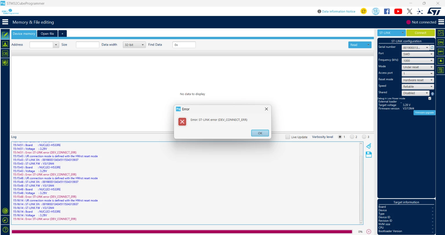

When CN7 pins 5 and 7 are connected (BOOT0 tied to VDD), the application runs, but STM32CubeProgrammer cannot connect through SWD. It reports:

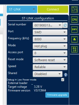

I have tried the following settings:
Port:        SWD
Frequency:   400–1000 kHz
Mode:        Under Reset
Access port: 1
Reset mode:  Hardware reset
If I remove the CN7 pin 5–7 jumper and power-cycle the board, SWD connection and programming work. After programming the signed/encrypted update image, I disconnect, power off, reconnect the jumper, and power on. The application then runs with the updated LED blinking behavior.
