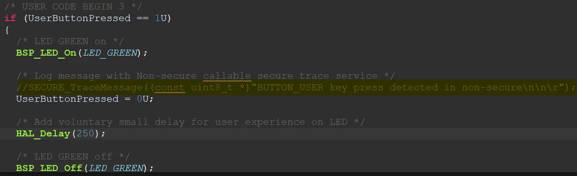

- UART_Trace_TrustZone_Secure:
Failed to run and debug regardless of the optimization level (Error: "Break at address "0x430027240" with no debug information or outside of program code"). However, when I commented the function "printf" and "Secure_TraceMessage" I was able to debug and run correctly.

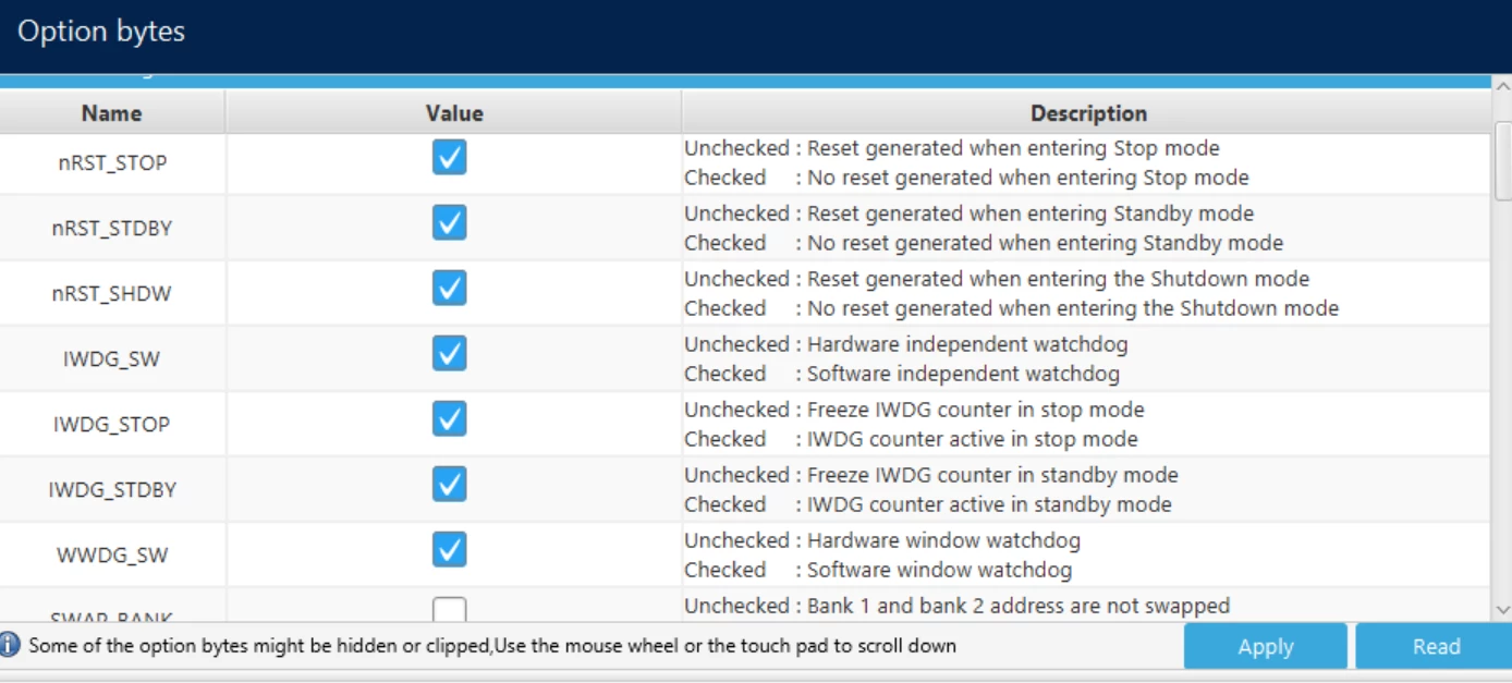

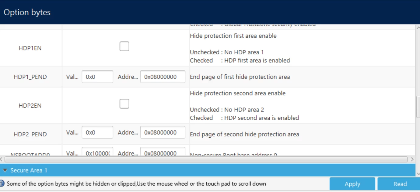

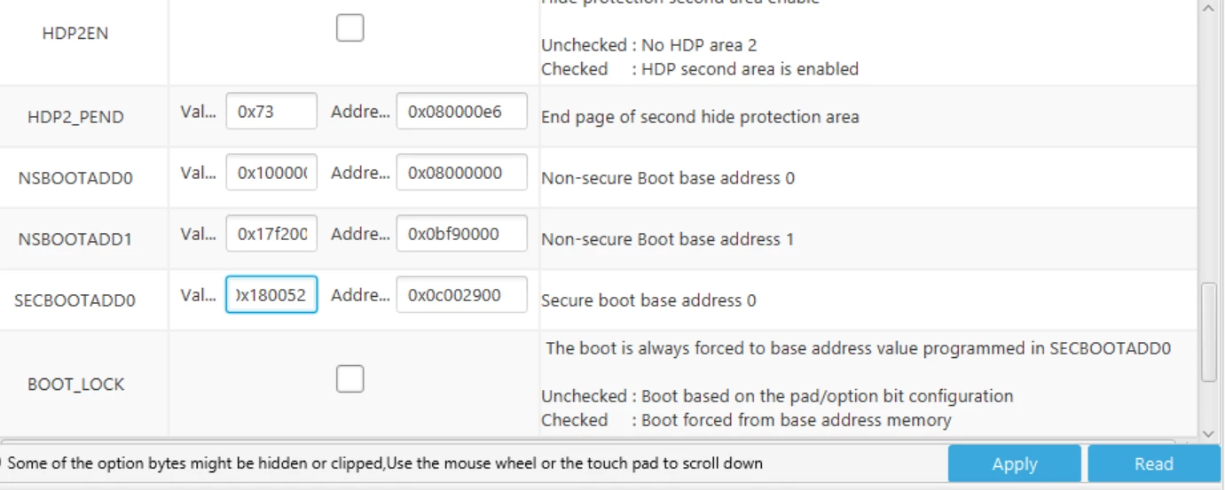

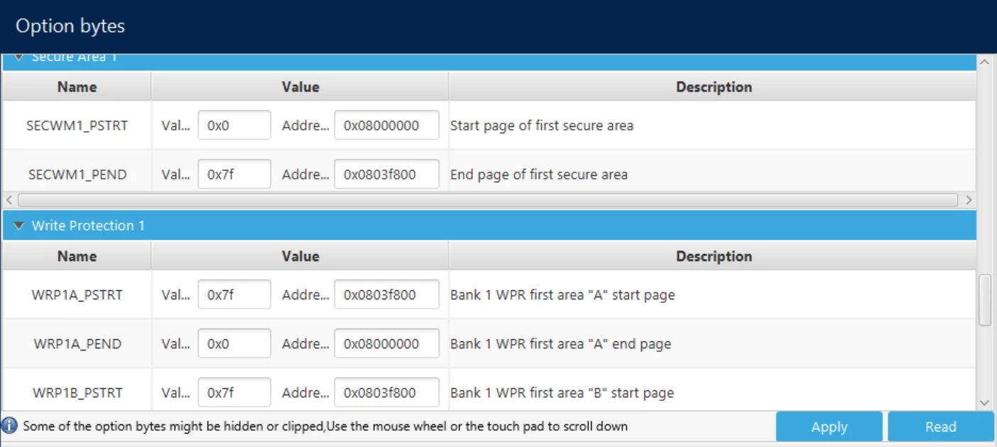

These are my Option Bytes:
Could it be something related with entering the secure side?

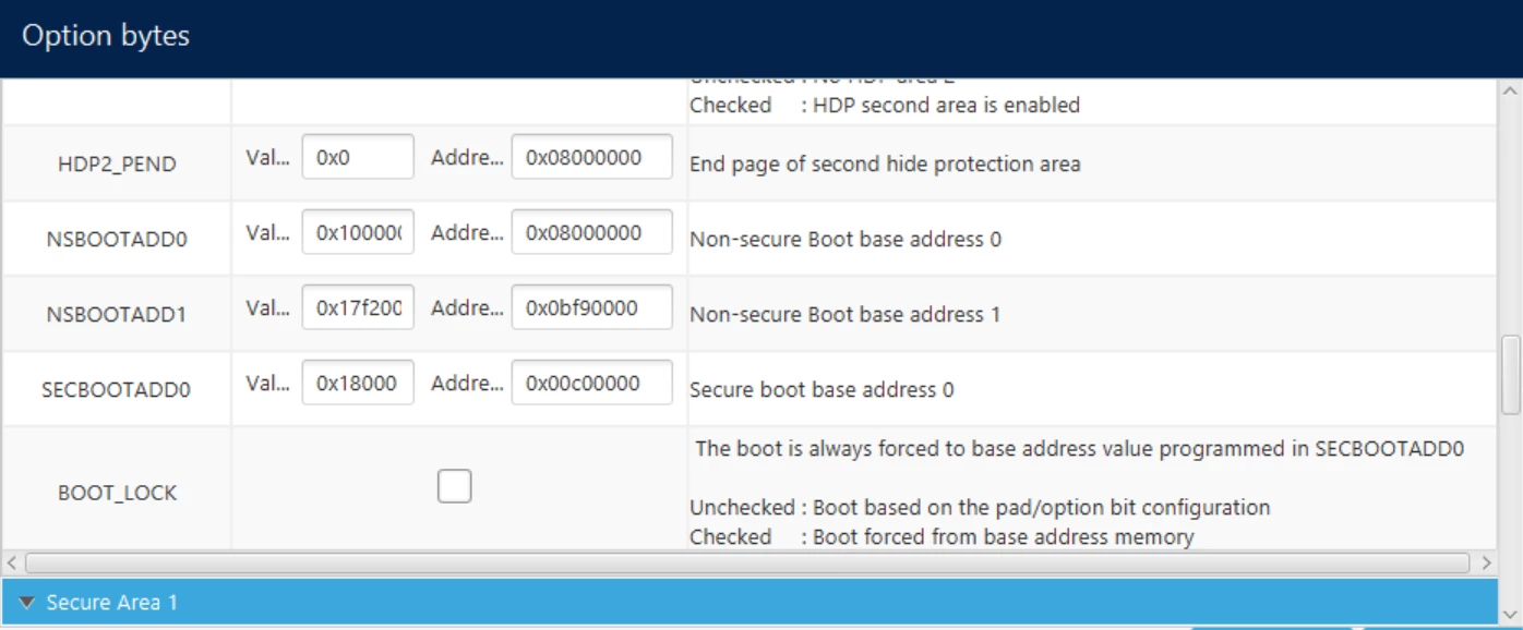

    Hello @Claudia ,
    The SECBOOTADD0 is set to 0x00C00000 which is wrong. It should be 0x0C000000.
    So when you launch the debugger, debugger forces the boot address to match the one from the elf file. But as soon as a reset is triggered the MCU jumps in wrong address.
    Setting the right boot address should solve your debugging issue
    Best regards
    Jocelyn

    Yes, you are right, I had a wrong SECBOOTADD0. Several weeks ago I tried with the following configuration and had the same problem:

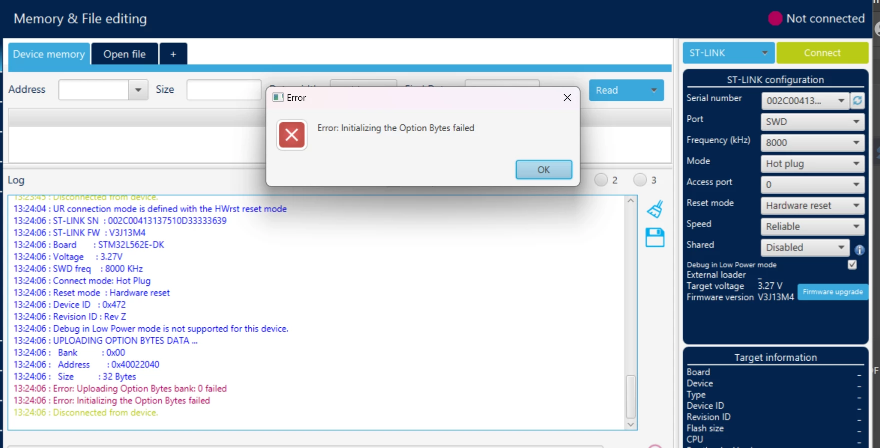

    I tried booting from RSS by connecting BOOT0 pin to VDD as suggested in um2617 (Chapter 6.4.2). However, I got the following message "Initializing Option Bytes failed":
    It seems that booting from RSS does not change things in my board.

    Hello @Claudia,
    One possible issue is that your CPU is already stalled before performing the reset.
    Please tray to have the BOOT0 connection upon power-on of the board.
    1) Connect BOOT0 to VDD
    2) Power-on the BOARD
    3) Attach to target with JTAG/SWD in hotplug.
    4) Set TZEN=0 and RDP=0xAA
    Alternatively, at step 3 you should be able to attach using USB-C connector directly to bootloader
    Select USB in STM32CubeProgrammer, check the USB1 port is available by pressing the double arrow button on the right
    Select TZEN Regression
    Press connect => This should directly launch the regression.
    Best regards
    Jocelyn

    I was able to connect to the board following your instructions and I was also able to debug everything perfectly. The only thing I had to do was to change the option byte SECBOOTADD0 as you advised.
