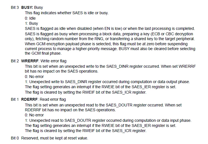

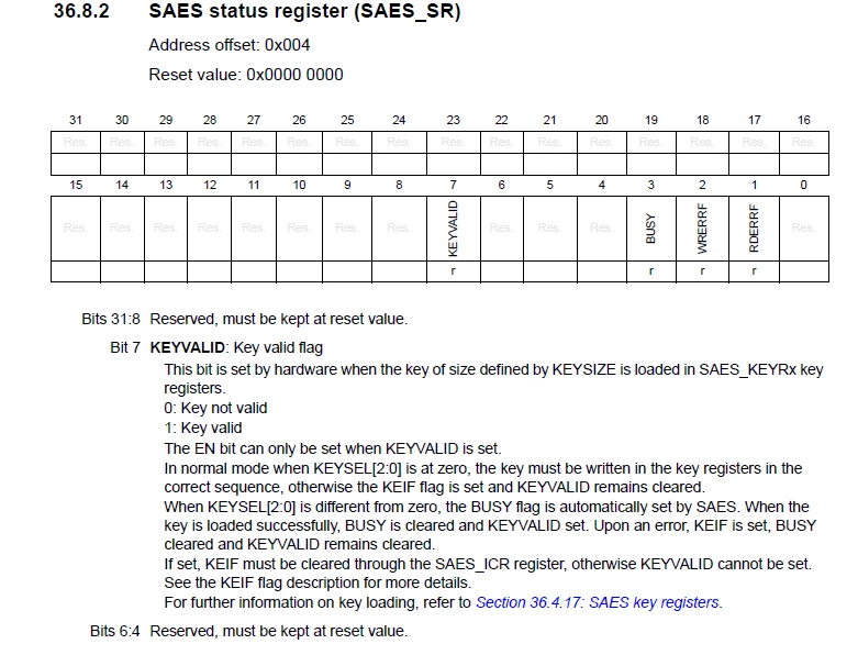

Possible discrepancy between HAL and RM0477
While investigating this, I noticed something that I would like to clarify. According to the STM32H7S3 RM0477, the `SAES_SR` register does not appear to contain a `CCF` flag that must be set when the encryption is completed.
The documented bits include:
Bit 7: KEYVALID
Bit 3: BUSY
Bit 2: WRERRF
Bit 1: RDERRF
However, in the HAL documentation, the flag `CCF` is implemented as the Bit 0 in the  `SAES_SR` register. Therefore, based on that, the result I obtain are:
SAES->SR = 0x80
    KEYVALID = 1
    CFF       = 0
SAES->SR = 0x81
    KEYVALID = 1
    CRR       = 1
This makes me wonder whether there is a mismatch between the HAL implementation and the SAES register definition for the STM32H7S3/H7S family.

Questions
Could someone from ST clarify the following?
1. Is `SAES_SR_CCF` actually a valid status flag for the SAES peripheral on STM32H7S3?
2. If not, why does the H7RS HAL use `CRYP_WaitOnCCFlag()` and wait for `SAES_SR_CCF`?
3. Is there any required reset, state clearing, or additional configuration that must be performed when switching from CRYP → SAES?
4. Is the expected behavior that `SAES->SR.CCF` should become set after the four `DINR` writes?
5. Could this be a HAL issue or an incorrect register definition for the STM32H7S3?
6. Is there a known difference between the SAES implementation described in the RM0477 and the one expected by the current `stm32h7rsxx_hal_cryp.c` implementation?
