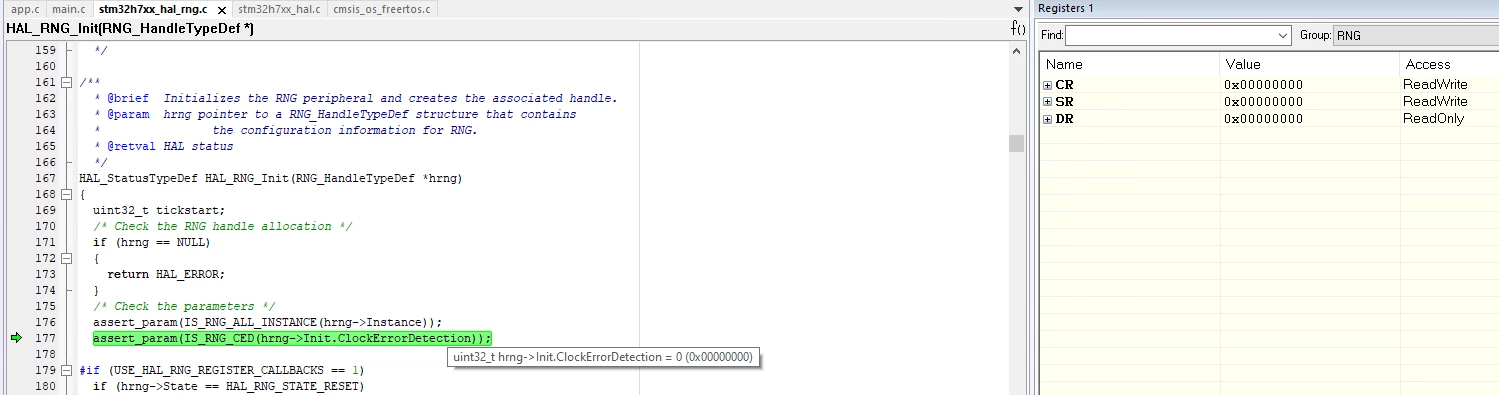

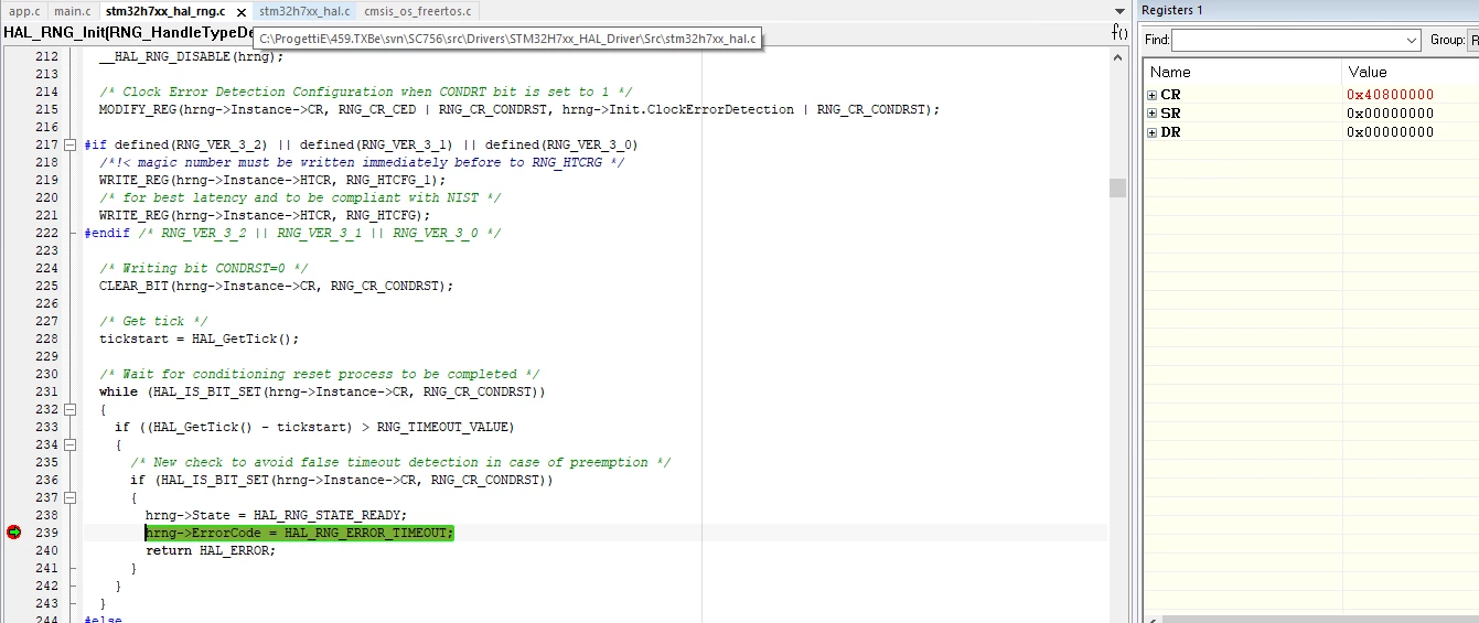

STM32H735AGI6 RNG non working
the function MX_RNG_Init fails
HAL_RNG_Init returns t.o.:
 while (HAL_IS_BIT_SET(hrng->Instance->CR, RNG_CR_CONDRST))
  if ((HAL_GetTick() - tickstart) > RNG_TIMEOUT_VALUE)
   /* New check to avoid false timeout detection in case of preemption */
   if (HAL_IS_BIT_SET(hrng->Instance->CR, RNG_CR_CONDRST))
    hrng->State = HAL_RNG_STATE_READY;
    hrng->ErrorCode = HAL_RNG_ERROR_TIMEOUT;
    return HAL_ERROR;

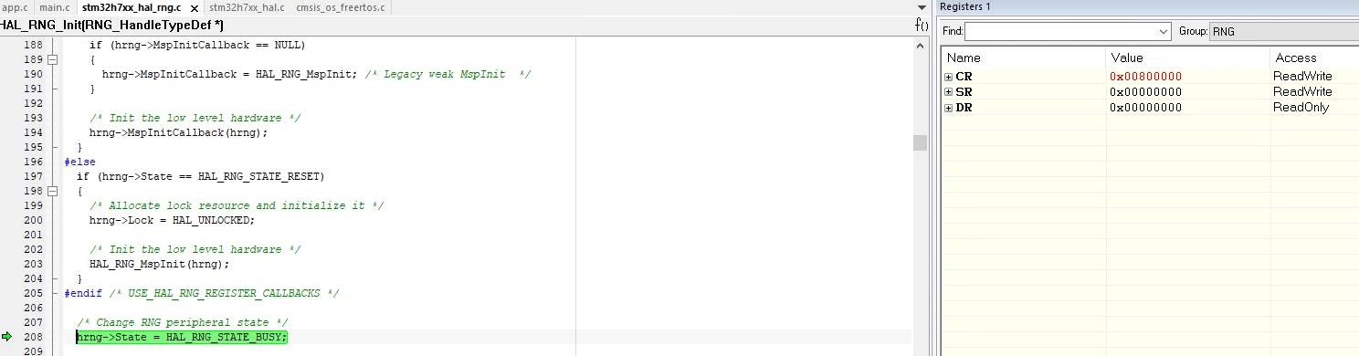

I am using the code genereted by cubemx:
int main(void)
  HAL_Init() ;
  SystemClock_Config() ;
  PeriphCommonClock_Config() ;
MX_RNG_Init() ;
I think that pll and clock are running
The funnction HAL_RNG_MspInit enables HSI48, so also this clock should be ok
Beginning:
0693W00000UnW6TQAV.pngafter msp init:
here the error:
