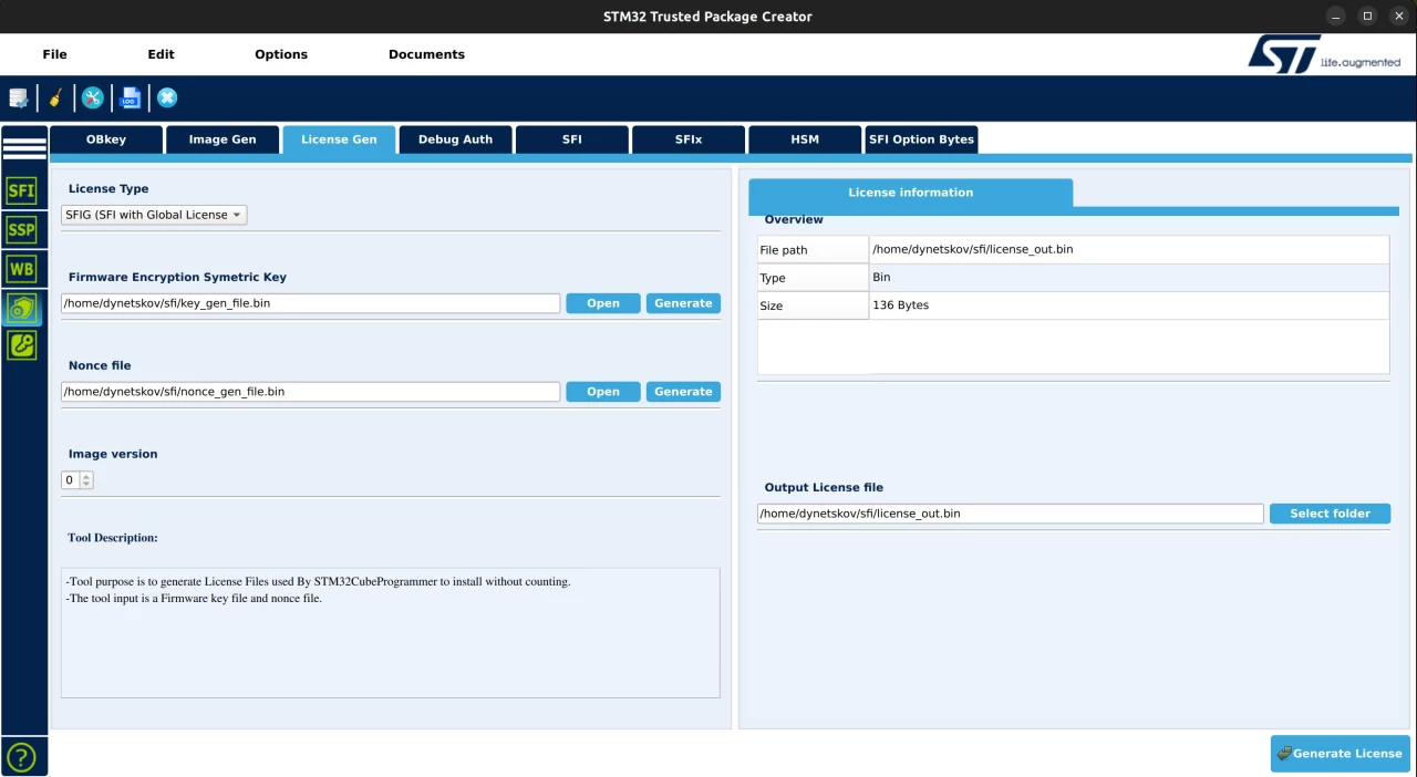

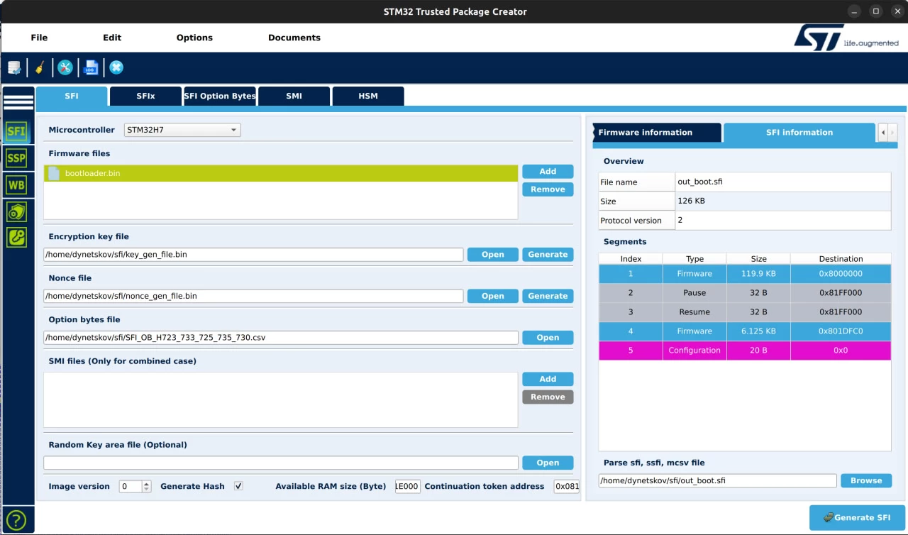

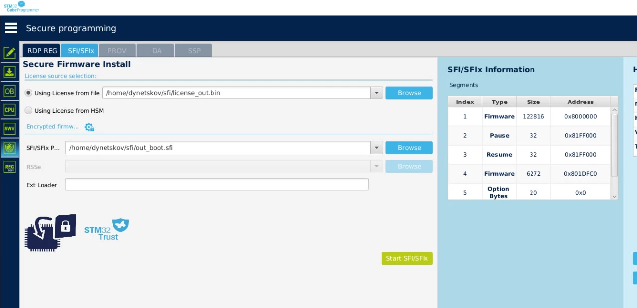

Get the next error during SFI performing via STM32CubeProgrammer v 2.17.0 using license file:
11:12:18 : Error: SECURITY State Fail
11:12:18 : Error: Invalid state after SFI install !
11:12:18 : Error: RSS internal system error or License is invalid !
SFi creation:
License generation:
STM32CubeProgrammer SFI tab:
Full log:

Hello @dynetskov ,
The global license does not apply to this product.
You need to use the STM32 HSMV2  to generate the license.
Please check wiki and X-CUBE-SFI
Best regards
Jocelyn

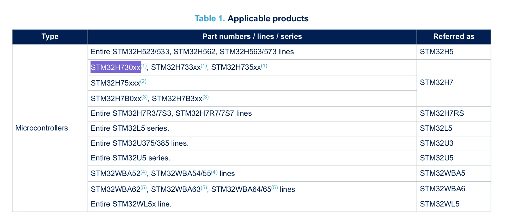

dynetskovAuthor
May 6, 2025 8:43 AM UTC
SMT32H730 is listed as supported product for SFI in AN4992
The full chip name is STM32H730IBT6Q
