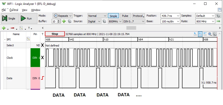

Hi there.
I'm struggling with the implementation of continuous SPI data transfer in Transmit only master mode with DMA in circular mode and enabled CRC calculation.

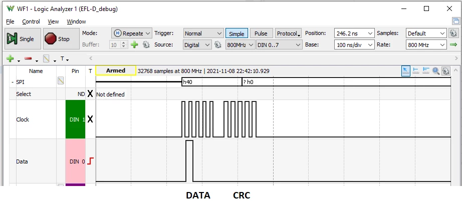

In any other configuration I've tried (DMA normal mode or SPI transfer with MCU polling) is CRC correctly added after data except after each data frame (5 bits) except circular mode.
In this case is CRC never generated and on physical SPI layer there is continuously transferring only data packet.
I can see that DMA transfer in circular mode is running correctly as data packet corresponds to continuously changing source data.
SPI clockrate = 50 MHz
SPI frame length = 5 bits
SPI CRC length = 5 bits
SPI inter data idleness = 1 bit
DMA mode = cicular mode
SPI communication with DMA in circular mode (configuration snippets below applied)

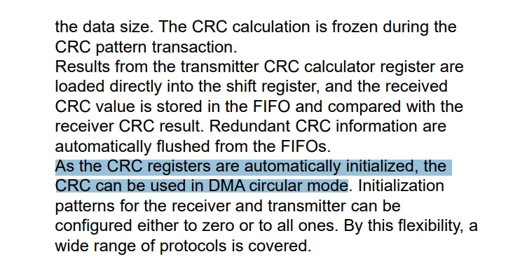

0693W00000GWrJ9QAL.pngSPI communication with DMA in normal mode {CRC is added)0693W00000GWrKMQA1.png STM presentation to the STM32H7 SPI says that combination of DMA circular mode and CRC should be possible LINK
Thanks in advance for any tips!
