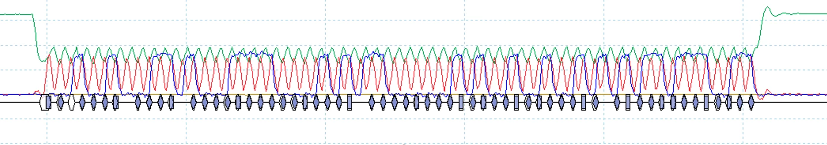

I make a simple test:
CRC32 with polynomial = 0x1EDC6F41, init value = 0x55555555. (no input/output reverse)
I send 4 bytes (0x12, 0x34,0x56,0x78) through SPI communication and on scope I measure what is phisically sent:
Frame: 0001001000110100011110000101011000000101001001001010101101110011
datas = 0x12347856 (00010010001101000111100001010110) --> the second half-word= 0x7856 is sent through little endian convention
CRC32 = 0x0524AB73 (00000101001001001010101101110011)
I can't get the same value (CRC32 = 0x0524AB73) with the algorithm
I use the same algorithm as you: CRCToCheck = Crc32(0x55555555, 0x12347856)
CRCToCheck = 0x27F11ABF ( != 0x0524AB73)
I also tried to fill with empty value 0x00000000 after these 4 Bytes, after 31999 iteration I stop it. CRC is still not equal.
Could you help me to know why the CRC is not good equal to hardware CRC?

I don’t reach the good CRC;
I will share you my source code:
SPI_InitStructure.TransferDirection = LL_SPI_SIMPLEX_TX;
 SPI_InitStructure.Mode = LL_SPI_MODE_MASTER;
 SPI_InitStructure.BaudRate = LL_SPI_BAUDRATEPRESCALER_DIV4; /* 64 MHZ input clk / 4 */
 SPI_InitStructure.BitOrder = LL_SPI_MSB_FIRST;
 SPI_InitStructure.ClockPhase = LL_SPI_PHASE_1EDGE;
 SPI_InitStructure.ClockPolarity = LL_SPI_POLARITY_LOW;
 SPI_InitStructure.CRCCalculation = LL_SPI_CRCCALCULATION_ENABLE;
 SPI_InitStructure.CRCPoly = 0x1edc6f41u;
 SPI_InitStructure.DataWidth = LL_SPI_DATAWIDTH_8BIT;
 LL_SPI_SetCRCWidth(SPI_CH1, LL_SPI_CRC_32BIT);
 LL_SPI_SetTxCRCInitPattern(SPI_CH1, LL_SPI_TXCRCINIT_ALL_ZERO_PATTERN); /* enable tx pattern with 0 */
Any idea where the issue could come from?
