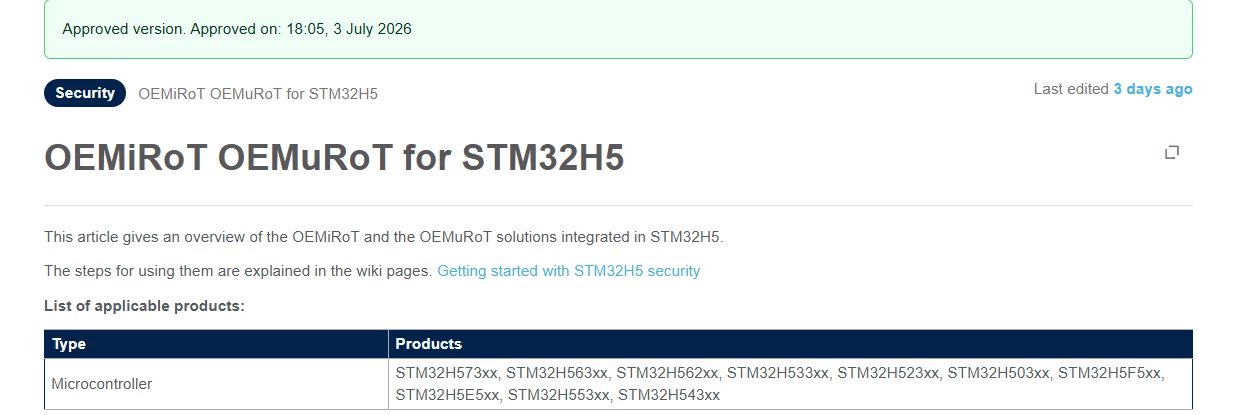

I am evaluating the secure boot and secure firmware update solutions for the STM32H5 family and plan to implement OEMuRoT  on an STM32H5F4 device.
While reviewing the wiki article OEMiRoT OEMuRoT for STM32H5, I noticed that the STM32H5F4xx is not listed as a supported device family.
Security:OEMiRoT OEMuRoT for STM32H5 - stm32mcu
I would like clarification on the following points:
  1. Is STM32H5F4xx intentionally excluded from OEMuRoT support?
  2. Are there any hardware or security-feature limitations in STM32H5F4 that prevent OEMuRoT implementation?
  3. My target device is STM32H5F4, and I am planning a secure firmware update architecture based on Root of Trust and authenticated firmware updates.
    Any guidance or roadmap information would be appreciated.
    Thank you,
           RJ

Hello ​@RJJ ,
This is very probably a mistake. STM32H5F4 is same as STM32H5F5 but without USB HS.
This means that anything running on STM32H5F5 not using this USB HS will also run on STM32H5F4.
Best regards
Jocelyn

Hello ​@RJJ ,
here you were referring to Secure Manager solution that is independent for OEMiROT/OEMuROT.
The Secure Manager is certified on a specific HW platform. Even if the differences are small, certification has a cost as well as Secure Manager maintenance. It was decided to address only STM32H5F5.
Best regards
Jocelyn
Jocelyn RICARD
Sep 24, 2026 2:11 PM UTC
Hello ​@RJJ ,
The installation of Secure Manager requires some secrets to be provisioned by ST inside the chip.
If STM32H5F4 is not supported, this means that these secrets are not provisioned.
So, no way to install the Secure Manager on STM32H5F4.
Best regards
