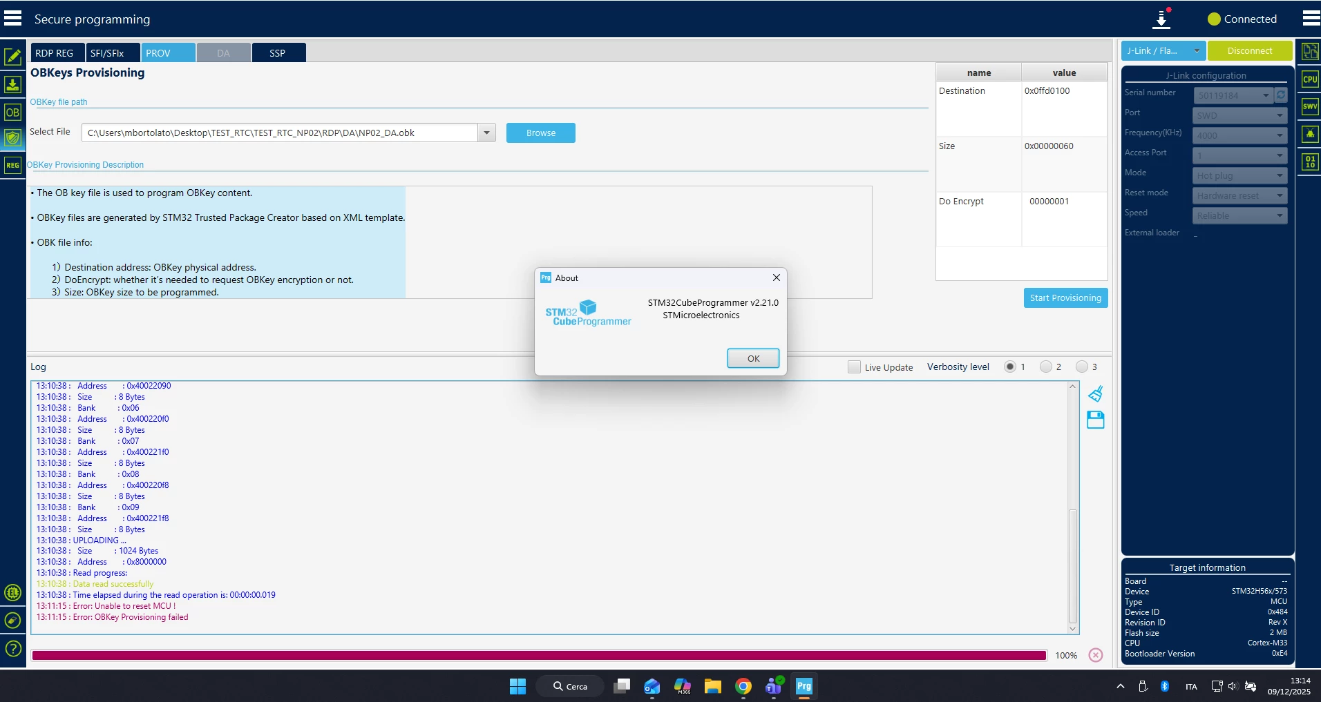

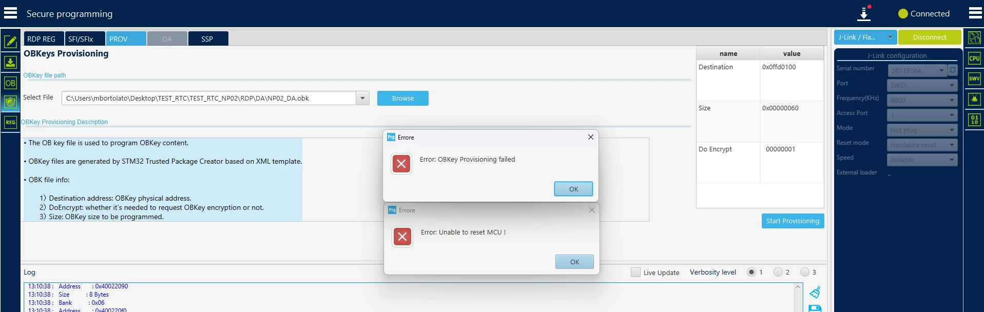

MattiaB
MattiaBAuthor
Dec 9, 2025 12:12 PM UTC
Hi @Jocelyn RICARD,
Also in hotplug mode I'm not able to provide the OBKey:
The STM32CubeProgrammer is the last downloadable:

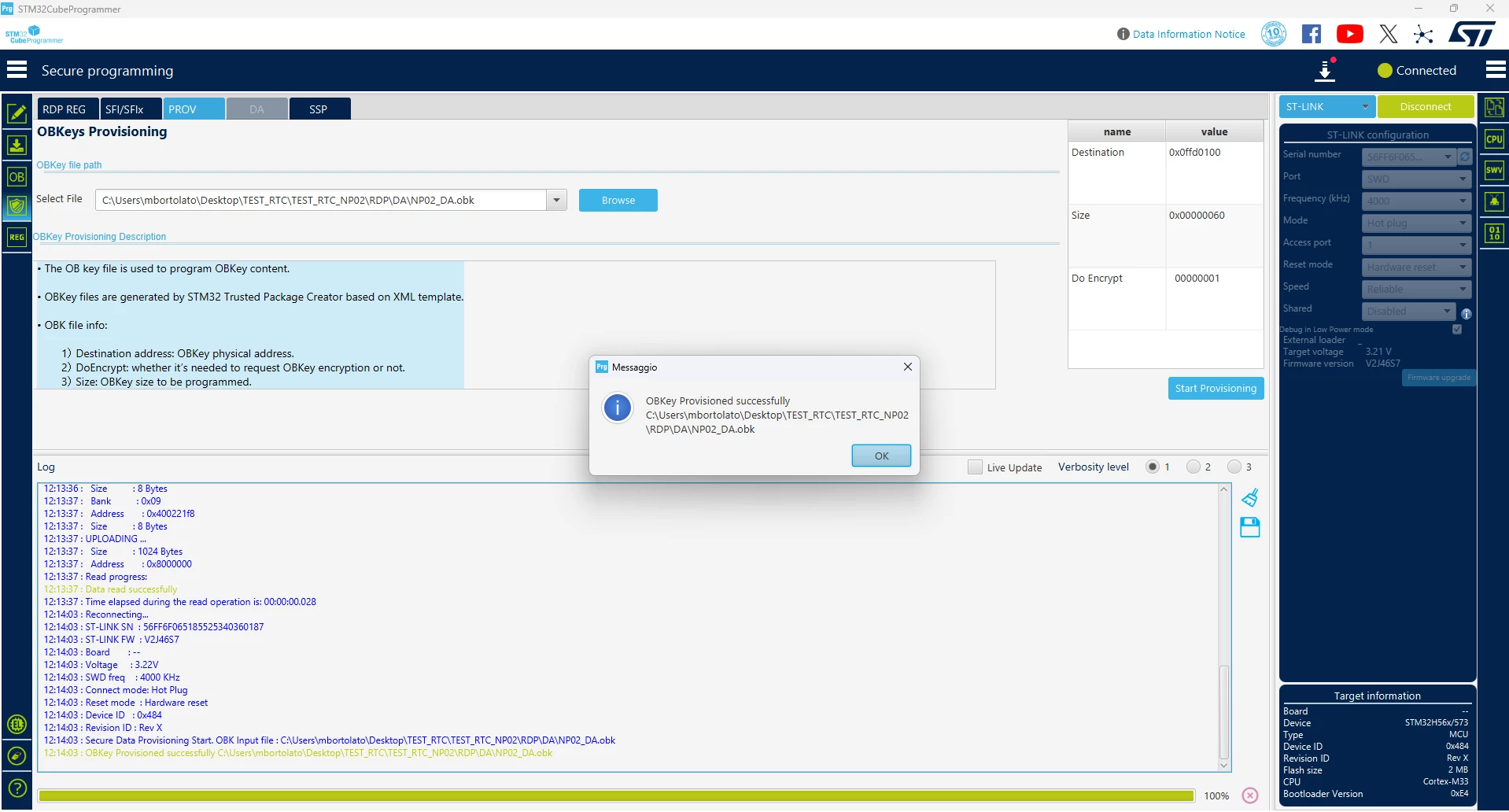

MattiaB
MattiaBAuthor
Dec 10, 2025 11:23 AM UTC
Good morning @Jocelyn RICARD,
Thank you — provisioning is now working.

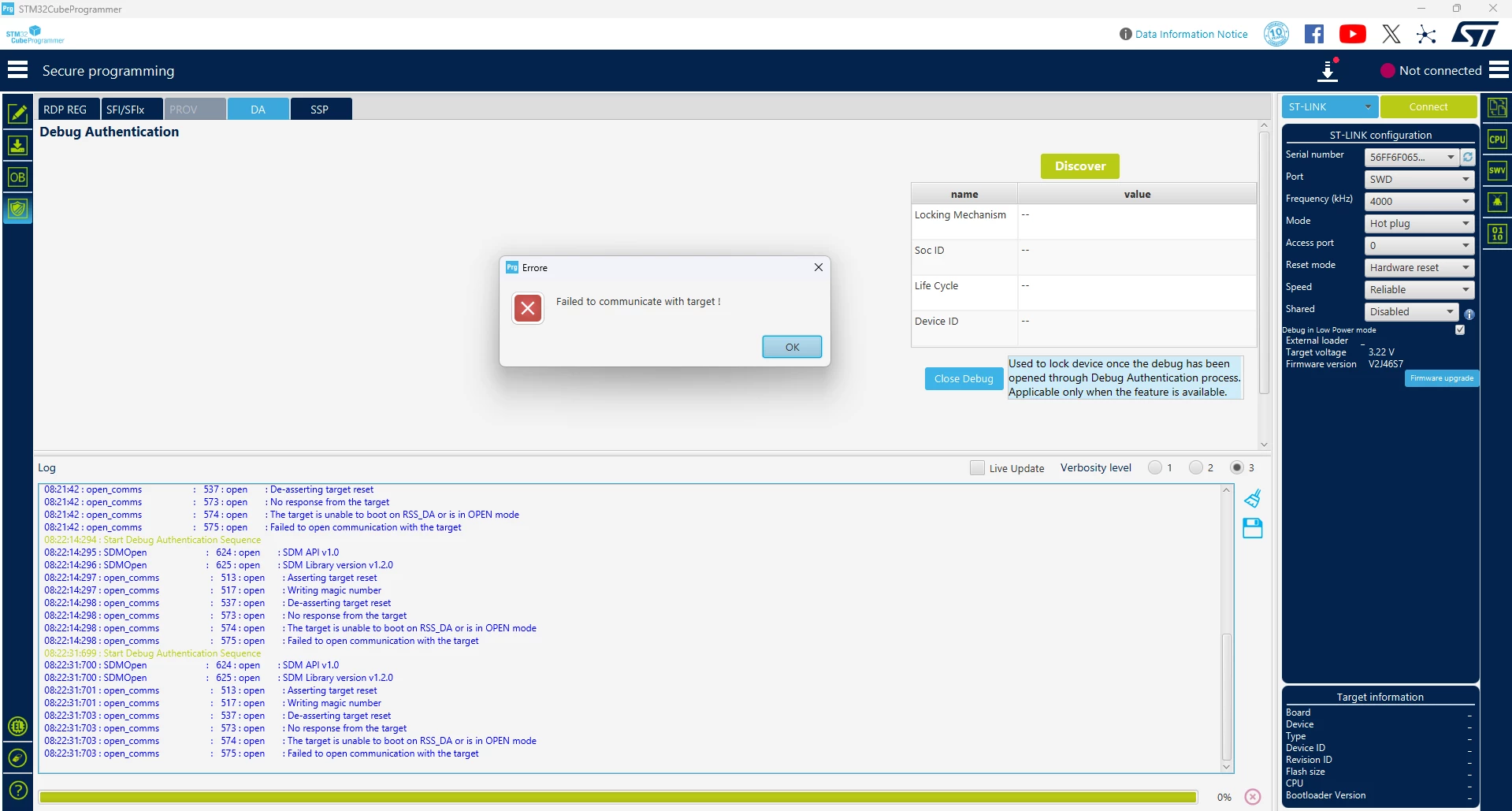

MattiaB
MattiaBAuthor
Dec 12, 2025 7:29 AM UTC

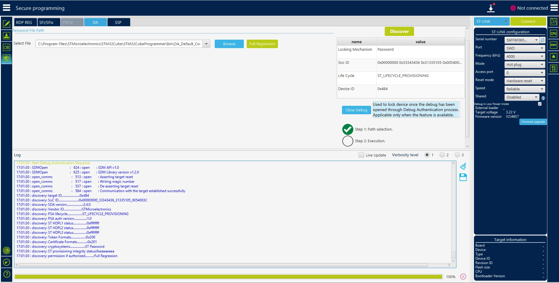

Thank you for the response @Jocelyn RICARD,
I powered the board, navigated to the "shield" icon, and pressed Discover.
Unfortunately, the discovery process failed.
When connecting to the target, I can see that it has clearly remained in the provisioning state.
I am not sure why the discovery fails. Do you have any idea what might be causing this?
Thank you again for your patience and the support you are providing. I look forward to your feedback.
Jocelyn RICARD
Dec 12, 2025 9:35 AM UTC
Hello @MattiaB ,
Can you check that you have connected the reset signal to the STLink Probe?
The Debug Authentication requires the control of this reset signal
Best regards
Jocelyn

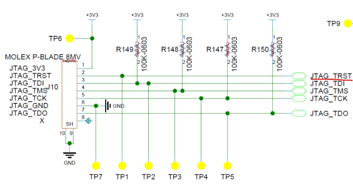

MattiaB
MattiaBAuthor
Dec 12, 2025 10:12 AM UTC

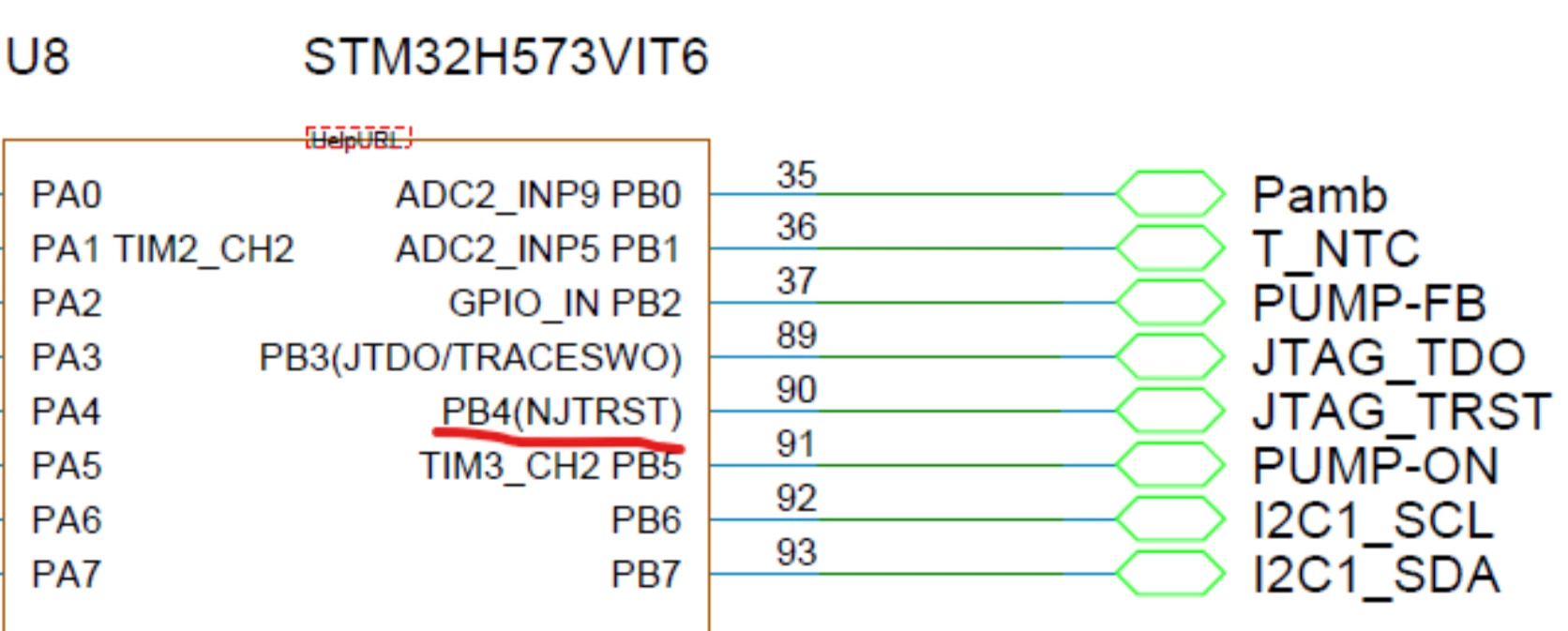

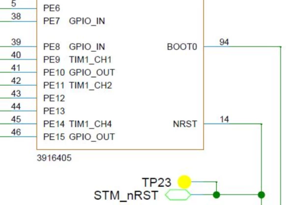

Hi @Jocelyn RICARD,
if you mean the NJTRST it's connected to the STMLink probe as follows:
If you mean NRST, it is NOT connected to the STLink probe:
Let me know if it's correct.
Jocelyn RICARD
Jocelyn RICARDBest answer
Dec 12, 2025 11:03 AM UTC
Hello @MattiaB ,
I confirm that you need to control the NRST pin to make Debug Authentication work
Best regards
Jocelyn

MattiaBAuthor
Dec 12, 2025 4:03 PM UTC
Thank you @Jocelyn RICARD,
connecting NRST to pin 15 of STLink V2 all works fine!
