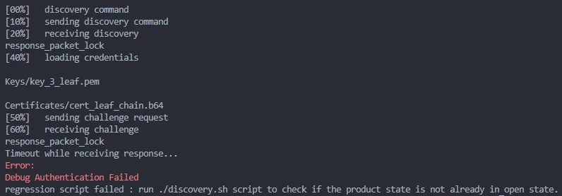

Problem
DA regression fails with timeout. I cannot recover the board.
I was trying to run the STiROT Template example (STiROT_Appli) on the STM32H573I-DK board.
1. I ran a custom provisioning script (based on ob_flash_programming.sh + obkey_provisioning.sh)
2. During image flashing step, I accidentally flashed an unsigned binary (appli.bin) instead of the signed image (appli_init_sign.hex)
3. OBKey provisioning (DA_Config.obk, STiRoT_Config.obk, STiRoT_Data.obk) may have failed due to the MCU being in an unstable state
4. I then set Product State to PROVISIONED (0x2E)
Discovery output Discovery succeeds and shows
- PSA lifecycle: ST_LIFECYCLE_IROT_PROVISIONED
- ST provisioning integrity status: 0xf5f5f5f5
- ST HDPL1 status: 0x1
- Permission: Full Regression is listed as available
Regression attempt Using default keys from the firmware package (not regenerated):
- Key: DA/Keys/key_3_leaf.pem
- Certificate: DA/Certificates/cert_leaf_chain.b64
- Password: DA/Binary/password.bin
DA/regression.sh Result
The provisioning integrity status 0xf5f5f5f5 suggests OBKeys were not properly programmed.
Is there any way to recover this board from PROVISIONED state when DA authentication fails due to missing/corrupt OBKeys?
Thank you

Hello @obrahimo,
I'm afraid your board may be lost, as the DA Auth shares storage space with the OBK. And without successful authentication there's no regression.
BR,

@obrahimo same happend to me. But I was lucky to have a bootloader up and running. I added a regression routine to new app and uploaded, run the routine over the CLI and the device was back to open state. In my case i’m using STM32H523.
So if you have an ability to change the application and run the routine, then use this snipped code:
static void make_regression(const cli_cmd_t *p_cmd, const char * const p_attr)
UNUSED(p_cmd);
UNUSED(p_attr);
cli_printf("Launching regression...");
/* Unlock the Flash to enable the flash control register access */
/* Unlock the Options Bytes */
HAL_FLASH_Unlock();
HAL_FLASH_OB_Unlock();
FLASH_OBProgramInitTypeDef flash_option_bytes_bank1 = {0};
flash_option_bytes_bank1.OptionType = OPTIONBYTE_PROD_STATE;
flash_option_bytes_bank1.ProductState = OB_PROD_STATE_REGRESSION;
if ( HAL_OK != HAL_FLASHEx_OBProgram( &flash_option_bytes_bank1 ))
cli_printf("Error while setting OB Bank1 config state!");
cli_printf("OB Launch ...");
/* Launch the Options Bytes (reset the board, should not return) */
if ( HAL_OK != HAL_FLASH_OB_Launch())
cli_printf("Error while execution OB_Launch");
NVIC_SystemReset();
It worked for me at least :)
