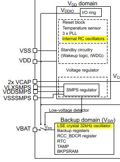

Sorry this is not what I am seeing - I have VBAT with a charged supercap and when I set the RTC to host time, power down and power up the next day and read the RTC I am getting date and time from yesterday when I powered down (I did this today). And it also shows in the H573 reference manual in chapter 10.4, Figure 40:
Only the LSE is in the backup domain but the internal RC oscillators are not, they are in the Vdd domain.
The second issue is that I can't switch to LSE since I cannot write to RTCSEL bits in the BDCR register in RCC. As the SM manual says: "The Secure Manager locks the RTC/Tamp clock source to LSI."
These two issues together mean that I cannot have a functioning RTC when I use Secure Manager (not even an inaccurate one which I could help with calibration).
