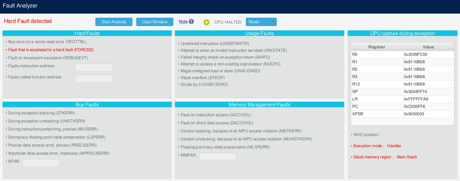

I am trying to create a very simple TZ-Enabled application on the STM32H573 in a CMake project. My application can build and flash to the IC and execute the main.c of the secure world but it hard faults, I believe when switching to the non-secure world. I am unsure of why it does this and would like help figuring that out.
I’ve attached the project to this post and I will provide information below:
Fault Analyzer Output
R0:      0x2009FC00 ← Non-Secure RAM (Non-Secure SP?)
R1:      0x08110B68 ← Non-Secure FLASH (See Vector Table Non-Secure Memory (Non-Secure Main Entry?))
R2:      0x08110B68 ← See Above
R3:      0x08110B68 ← See Above
R12:    0x08110B68 ← See Above
SP:      0x3004FF74 ← Secure RAM
LR:      0xFFFFFFA9
PC:      0x0C000FF6
XPSR: 0x09000003

cjacksonBest answer
Jun 25, 2026 05:10 UTC
Resolved.
The HardFault was caused because the Non-Secure RAM and peripheral regions in partition_stm32h573xx.h were defined but deactivated (set to 0) no matter how I changed the configuration in STM32CubeMX (This area is surrounded with the USER CODE BEGIN comments but still a confusing design choice).
For others that may be having the same issue. Navigate into Secure/Core/Inc/partition_stm32h573xx.h:
// Change
#define SAU_INIT_REGION1 0
// Too
#define SAU_INIT_REGION1 1
Do this for any other region you want to be defined as non-secure
