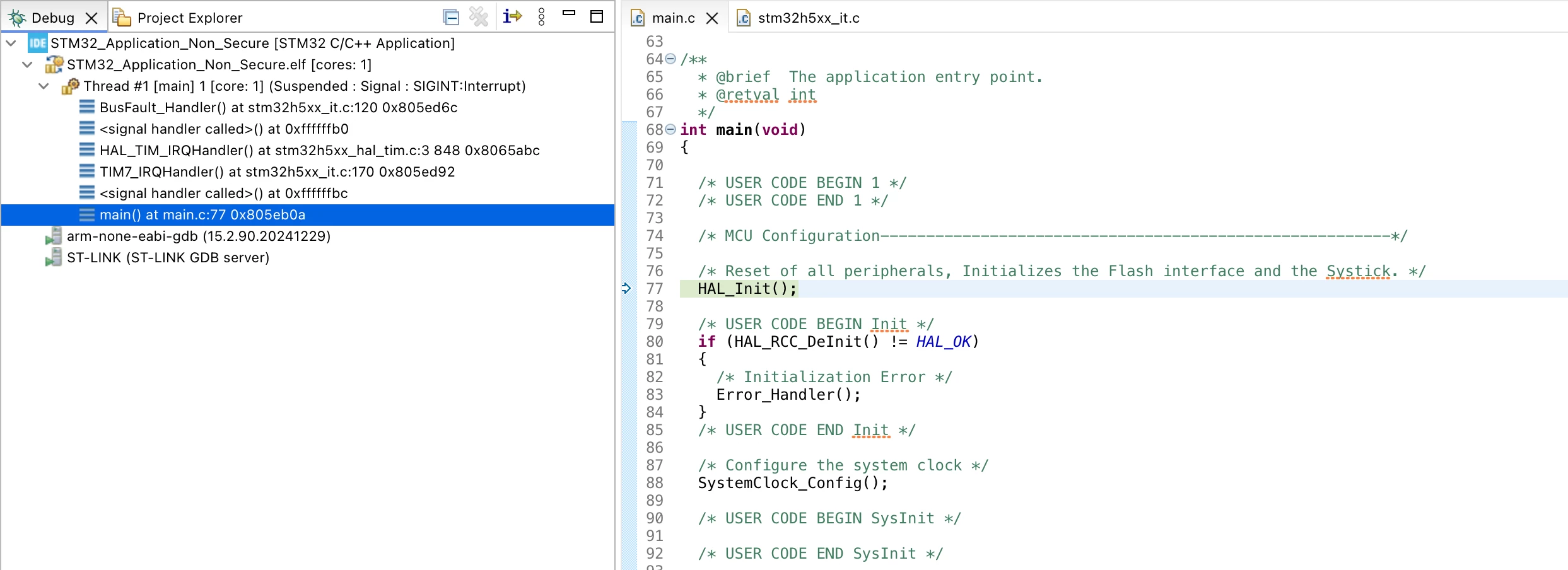

However, as soon as I integrate FreeRTOS and switch the HAL timebase source from SysTick to TIM7, the program immediately stops and goes into the BusFault_Handler() after TIM7 interrupt.
Steps to reproduce:
1) Follow the Secure Manager tutorial and set up SM provisioning
2) Confirm basic GPIO/LED blinking works
3) Add FreeRTOS middleware (no other changes)
4) In Clock Configuration → SYS, change Timebase Source to TIM7
5) Build and flash — program immediately hits BusFault_Handler()

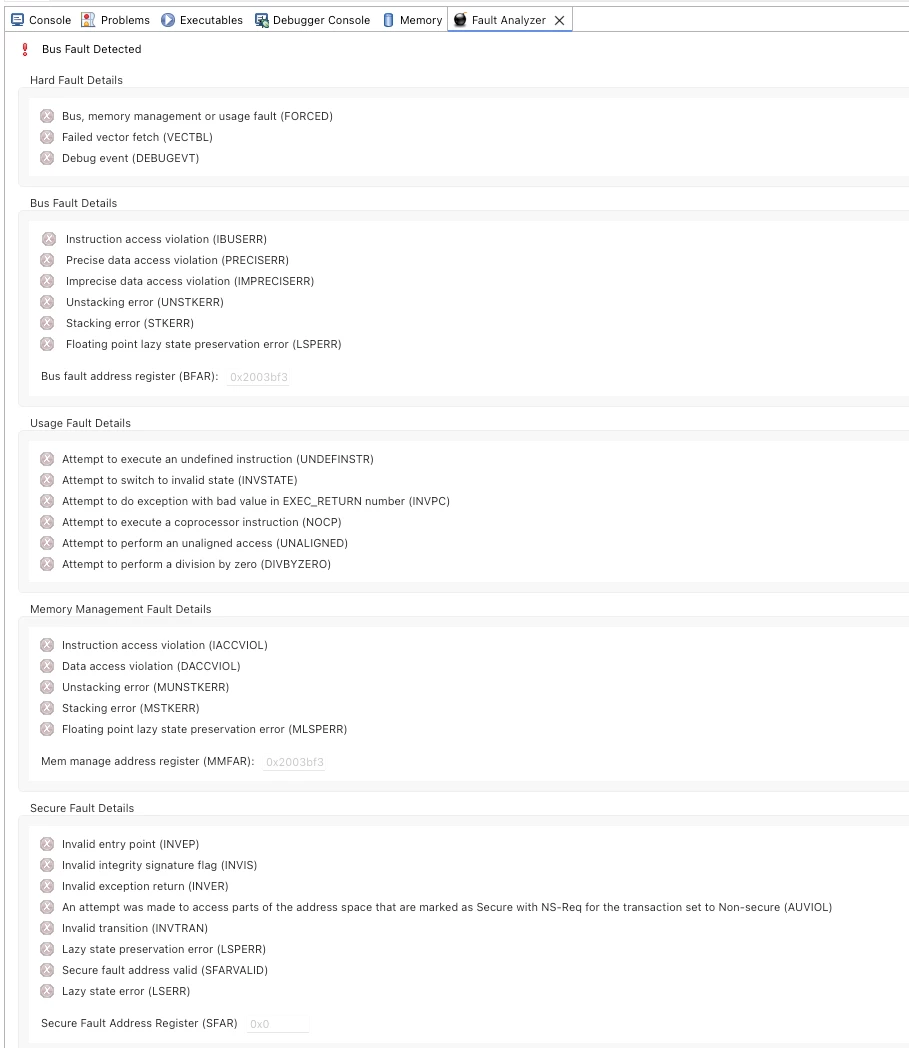

Hello @kicur ,
I tried the same, with same versions but don't reproduce the issue.
The TIM7 interrupts fires but does not generate any error.
You can check what exactly is causing the error using Fault Analyser window, and checking assembly instruction generating the fault. This should help understanding the root cause
Best regards
Jocelyn
kicurAuthor
February 25, 2026
Hello @Jocelyn RICARD ,
Thank you for your feedback.
I wanted to double-check everything and go through the steps again, but I found something interesting: after reconnecting my board, the application runs without any problems. However, when I debug it with ST-Link, it crashes again like before.
To summarize:
MyApp with FreeRTOS — works when running on the board normally
MyApp with Secure Manager + FreeRTOS/TIM7 — works only when not debugging
MyApp with Secure Manager, without FreeRTOS and TIM7 — works even when debugging
So maybe this situation gives a hint about where the issue is? I also attach screen of the Fault Analyzer.
Jocelyn RICARD
February 26, 2026
Hello @kicur ,
did you implement the STM32CubeIDE limitation workaround 138771 that you can find in STM32CubeIDE Errata here ?
Best regards
