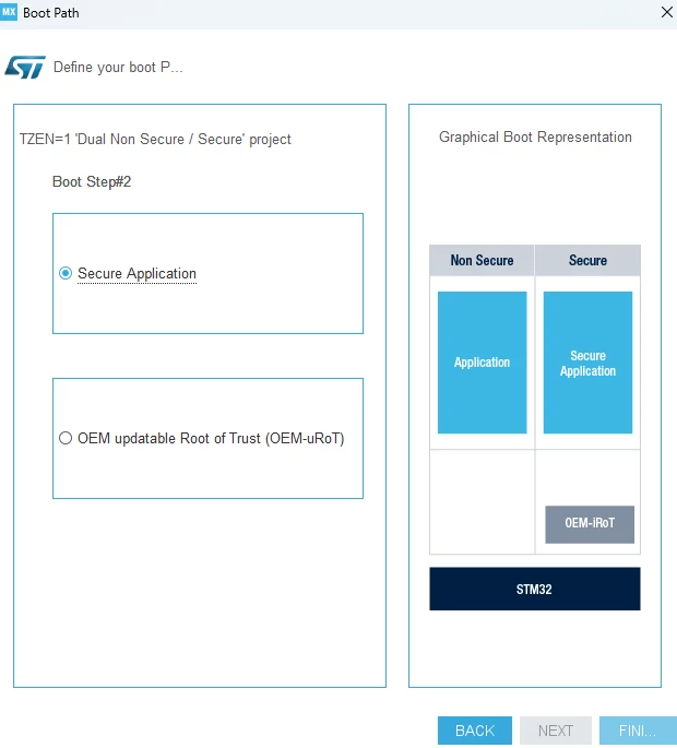

I'm using the link below to select boot path and do secure boot device provisioning for my STM32H563 board:
https://wiki.st.com/stm32mcu/wiki/Security:How_to_start_with_STM32CubeMX_OEMiRoT_Boot_path_on_STM32H563
Boot path is configured as follows:
I have run provisioning.bat, the product state was set to PROVISIONED. The provisioning was successfull, with logs at the end of ob_flash_programming.log:

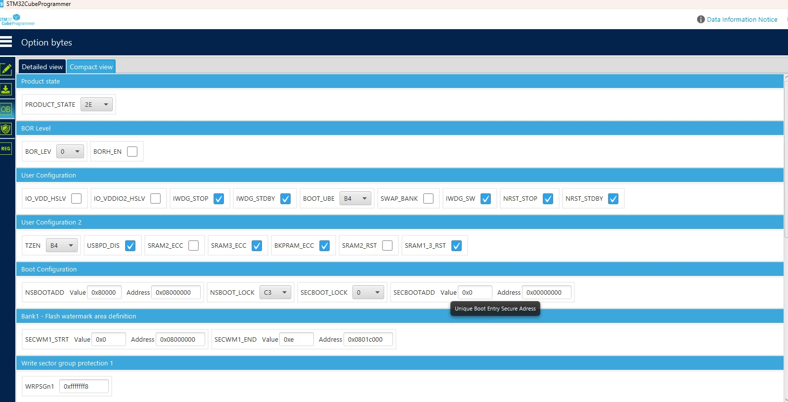

Below is the Option Bytes overview after provisioning:
Everything looks ok, but SECBOOTADD = 0x00000000, it should be 0xC000000 when TZEN = 1 and UBE = B4 (OEMiRoT). Could this be the reason that I can't do Debug Authentication discover and perform DA correctly?

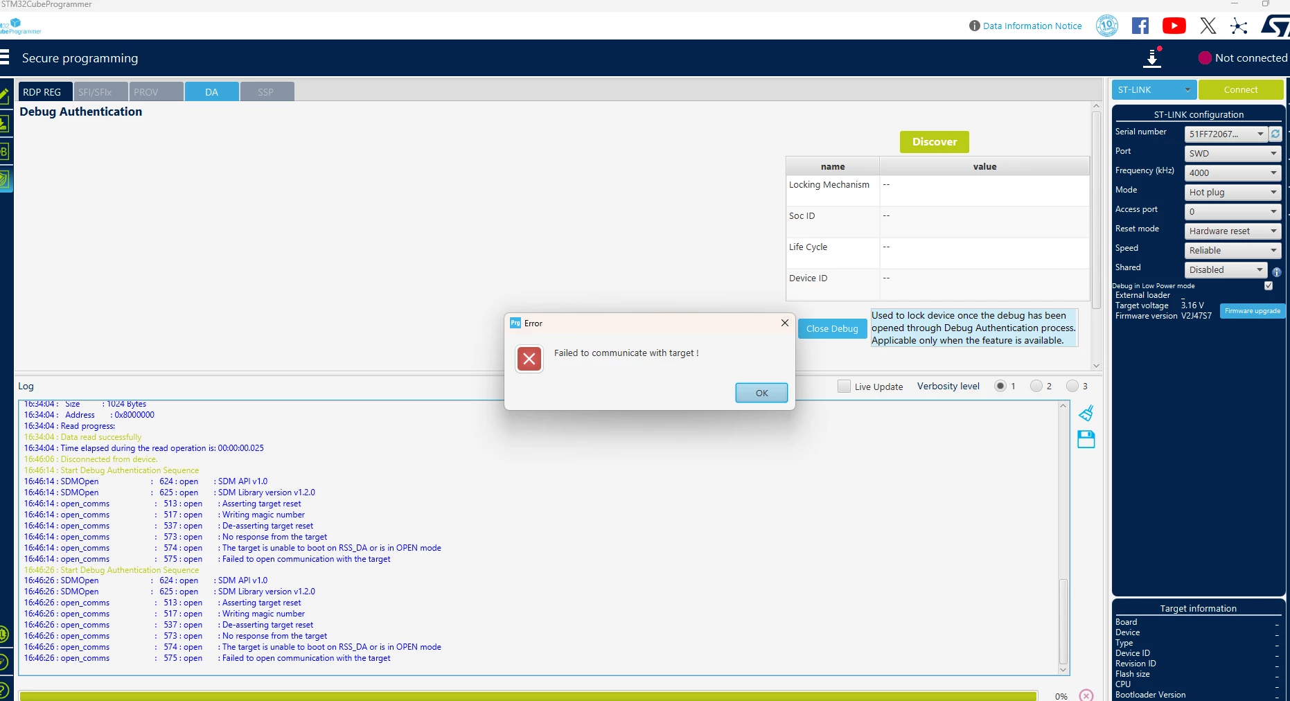

While doing Debug Authentication Discover, it shows error as above image:  The target is unable to boot on RSS_DA or is in OPEN mode. Will Debug Authentication requries RSS_DA access which needs to start from SECBOOTADD at 0xC000000?

Running regression.bat also failed now. It shows a similar error as doing Debug Authentication above:
Start Debug Authentication Sequence
Open SDM Lib
SDMOpen : 624 : open : SDM API v1.0
SDMOpen : 625 : open : SDM Library version v1.2.0
open_comms : 513 : open : Asserting target reset
open_comms : 517 : open : Writing magic number
open_comms : 537 : open : De-asserting target reset
open_comms : 573 : open : No response from the target
open_comms : 574 : open : The target is unable to boot on RSS_DA or is in OPEN mode
open_comms : 575 : open : Failed to open communication with the target
Error:
Debug Authentication Failed
"regression script failed"

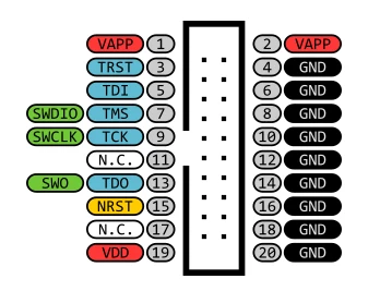

My first guess would be that you didn't connect the reset pin of your target to your STLink V2.
Can you check this?
Best regards
Jocelyn
February 6, 2026
Thank you for the reply Jocelyn.
I checked with our HW team, we haven't connected the reset pin in our ST-Link cable. Only these 4 pins are connected: VAPP, SWDIO, SWCLK and GND.
W/o connecting the reset pin of the target to ST-Link V2, could this be the reason that we failed to write 0xC000000 to SECBOOTADD, or the reason that while doing Debug Authentication, the MCU failed to boot on RSS_DA?
What is the purpoose of the reset pin here?
Thanks again!
Jocelyn RICARD
February 7, 2026
Hello @linglinqin ,
The reset pin control is necessary for the Debug Authentication procedure. To establish this communication with RSS_DA, the programmer writes a specific value at specific address and reset.
The fact that you see SECBOOTADD to 0 is because you are connected in non secure. In such state you don't have access to all the option bytes even in reading.
Best regards
Jocelyn
February 10, 2026
Hi Jocelyn,
Thank you so much. You're amazing! We connected the reset pin to ST-Link cable, RSS_DA access established, and Debug Authentication is successfully done. Much appreciated for your help!
