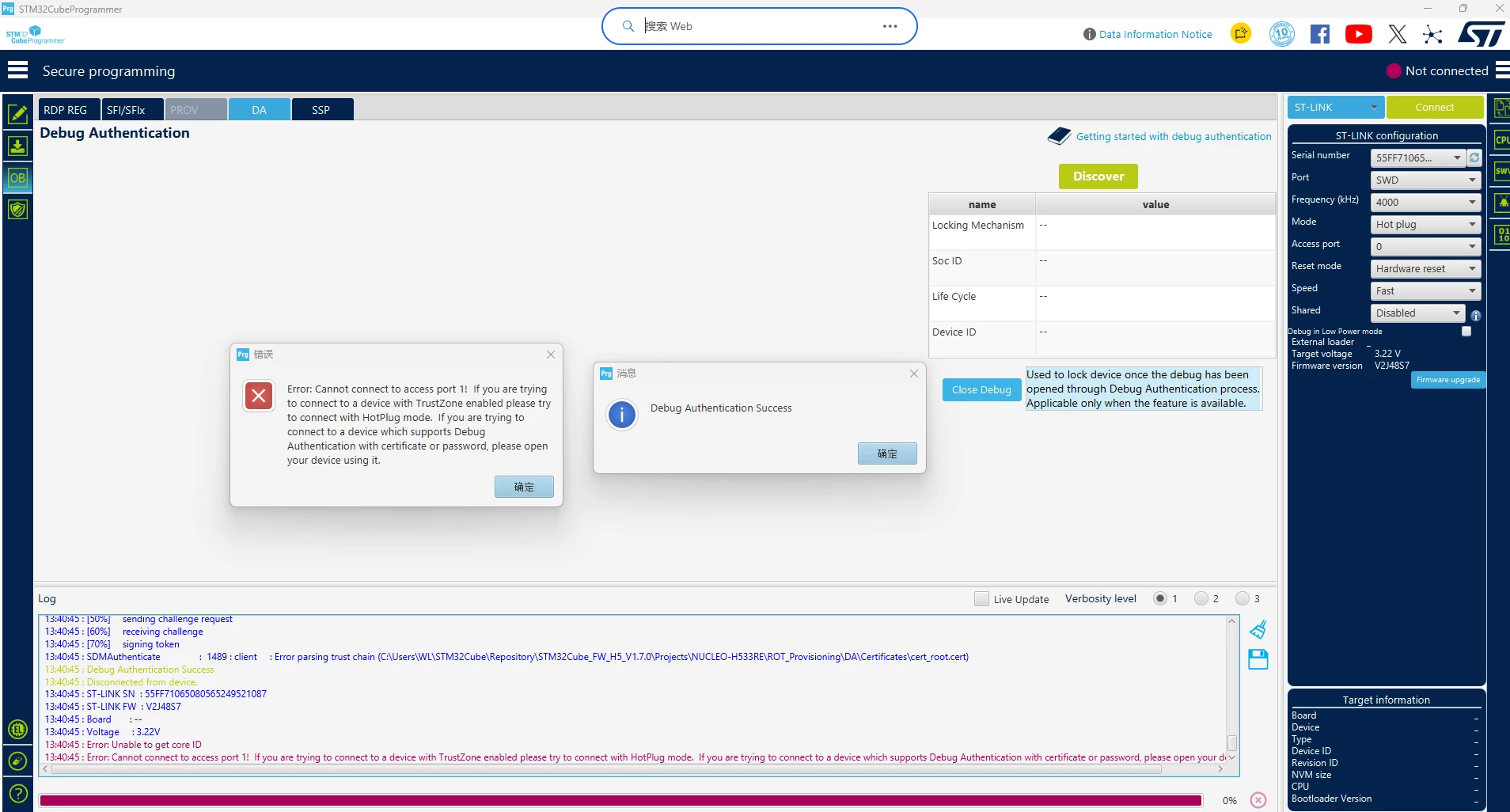

    When I try Debug Authentication (DA) now with STM32CubeProgrammer, the discovery phase shows the following:
    discovery: target ID: 0x478discovery: SoC ID: 0x00000000_39323639_31355117_0028002Adiscovery: SDA version: 1.2.0discovery: vendor ID: STMicroelectronicsdiscovery: PSA lifecycle: ST_LIFECYCLE_IROT_PROVISIONEDdiscovery: PSA verification version: 1.0discovery: Token Formats: 0x00000200discovery: Certificate Formats: 0x00000201discovery: Crypto system: Ecdsa-P256 SHA256discovery: ST provisioning integrity status: 0xEAEAEAEAdiscovery: ST provisioning integrity status message: VALIDdiscovery: Allowed with authorization: Full Regressiondiscovery: Allowed with authorization: To TZ Regressiondiscovery: Allowed with authorization: Level 3 Intrusive Debugdiscovery: Allowed with authorization: Level 2 Intrusive Debugdiscovery: Allowed with authorization: Level 1 Intrusive Debugdiscovery: Allowed with authorization: Level 3 Intrusive Non Secure Debugdiscovery: Allowed with authorization: Level 2 Intrusive Non Secure Debugdiscovery: Allowed with authorization: Level 1 Intrusive Non Secure Debug
    So the DA configuration now appears valid, and the device is in ST_LIFECYCLE_IROT_PROVISIONED with Full Regression permission.
    However, during the authentication step, the CubeProgrammer displays ‘Error:Debug Authentication Failed’. But when I choosed cert_root.cert file, I get this:
  6. [70%] signing tokenSDMAuthenticate : client : Error parsing trust chain (C:\Users\WL\STM32Cube\Repository\STM32Cube_FW_H5_V1.7.0\Projects\NUCLEO-H533RE\ROT_Provisioning\DA\Certificates\cert_root.cert)Debug Authentication SuccessDisconnected from device.Error: Unable to get core IDError: Unable to connect to access port 1! If you are trying to connect to a device with TrustZone enabled, please try to connect using hot plug mode. If you are trying to connect to a device that supports authentication using certificate or password, please use them to open your device.
    It seems that the tool reports Debug Authentication Success, but then it still cannot read the core ID or connect to access port 1.

Good news,
my device has fully recovered after passing DA certification.
When generating a private key through TrustedPacketCreator, an automatic backup of the old private key will be made in the directory, with a name similar to key_1_root.pem_12.08.2026_16_09_05.bak. If this backup still exists, it will not matter even if the public key and certificate are lost or overwritten. The specific method is as follows:
1. In the DA/Keys directory, copy a copy of key_1_root.pem_12.08.2026_16_09_05.bak, and then change the extension of this copied file to .pem format by removing the part after .pem in the name.
2. Use the openssl tool to generate the corresponding unique public key by executing 'openssl ec -in key_1_root.pem -pubout -out key_1_root_pub.pem'. On Windows systems, you can use the Git Bash tool, switch to the current directory, and execute the command.
3. Utilize the TrustedPacketCreator tool, navigate to the DA, Certificate Generation page, select the paths corresponding to the private and public keys, and then choose "generate certificate" in the lower right corner to regenerate the certificate.
4. Then, DA regression can be performed through CubeProgrammer.
