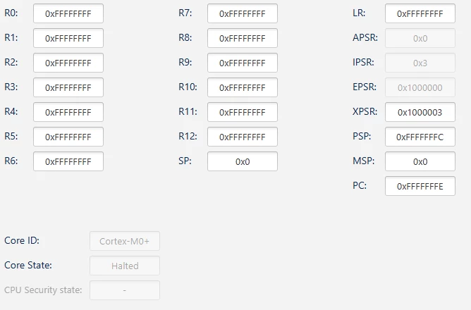

I have a unit in that state now; UART1TX appears to be floating (around 0v24) and the UART1RX pin is at 0V.  I tried connecting to the chip via STM32CubeProgrammer via UART and no luck (so I don't think it's sitting in the system bootloader - if it were, it should respond to a hard reset).
I will try diagnosing this further (e.g. toggling a GPIO during startup), putting a scope on Vdd, and I'll also hook up an STLink to see if that gives any more insight, but the failure mode is such that only a power cycle will exit, not a hard reset; that really shouldn't be possible with anything startup code might be doing.  Most importantly, this *never* happens when the RDP level is set to 0 - same hardware, same firmware.  This sure looks like a silicon problem with RDP level 1.  It behaves exactly the same way whether the nBOOT_SEL and nBOOT0 option bits are set or clear.  I think the errata is simply incorrect.
In terms of exactly what's going wrong with the part when configured for RDP level 1, I note that the condition is much easier to replicate when all bulk capacitance on the device has been given time to fully drain (or manually assisted in doing so).  i.e. the problem manifests more readily when Vdd has cycled all the way to 0V and then on.  However again, the issue never happens with RDP level 0; this is not a problem inherent in the power rail ramp.
DAlbe.3
DAlbe.3Author
May 24, 2024
Interestingly, I was able to connect using an STLinkV2 under SoftwareReset.
From the STM32CubeProgrammer, I can perform a core or hardware or software reset, but it always lands back  in the above configuration.  I can access the registers, and read OTP (flash is protected with level 1) so if there's something worth looking at, suggestions are welcome!

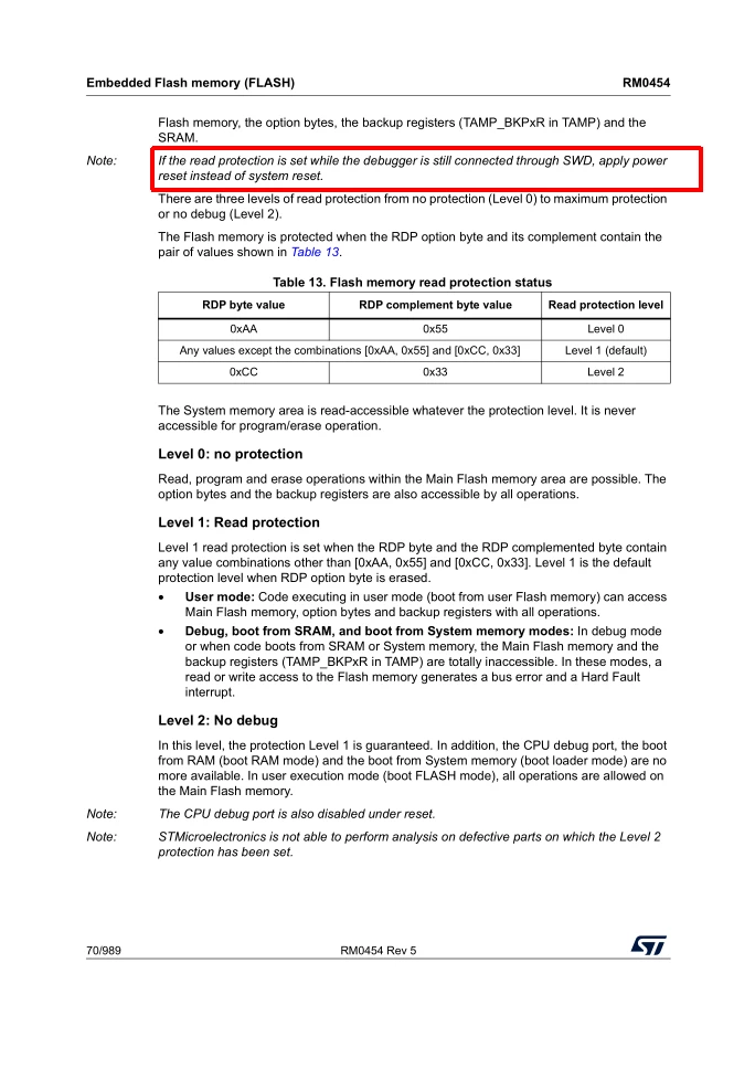

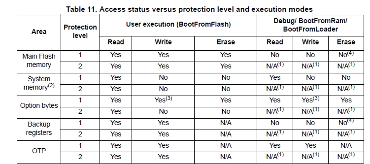

Ugh, I also just found that RDP level 1 does not protect the OTP from read access (at least not when using the STLink).
That's hummm.

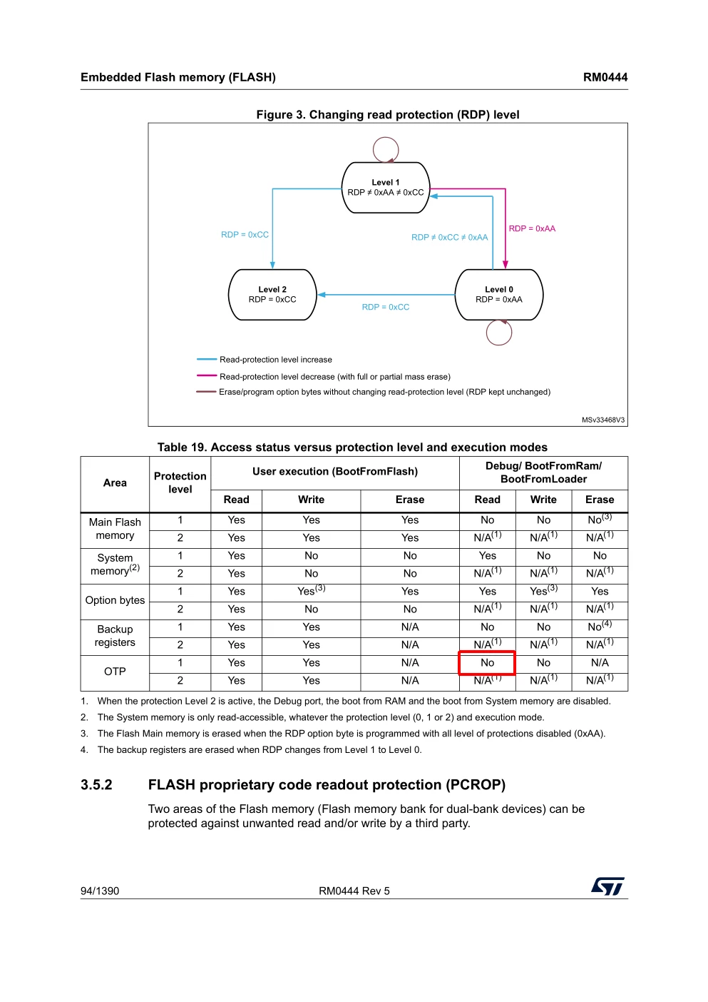

It turns out the OTP is expected to have read access under RDP level 1.
I think that's very undesirable and hope ST will change this in the future since OTP is the perfect place to store things like encryption keys, serial numbers, etc.
The table below is from RM0454 Rev 2:

All of our development units were built with rev Z chips (device ID 0x1001).
I will look through some other units.  If this is solved in newer versions, that would be great news.  I'll also check our stock and see if we have newer chips on hand...I think we have a few thousand of these.
As it is, with the rev Z chip, the option byte setting and RDP level 1 seem severely broken.
You can see from my last screenshot that you can indeed read OTP while RDP is set to level 1.
