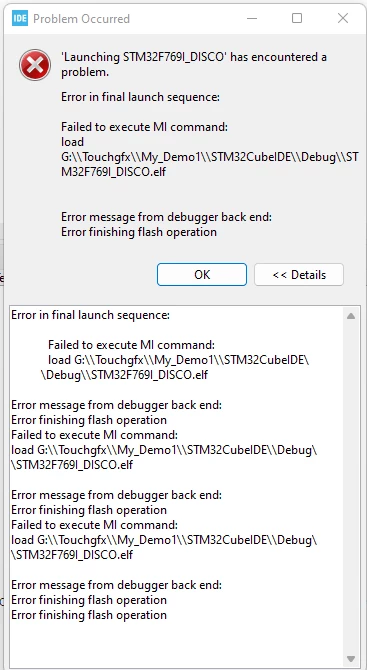

I am not able to flash, I am getting following error during flash,
I tried changing SWD freq and Connect mode: Under_reset

Erasing internal memory sectors [0 6]
Error: failed to erase memory
Encountered Error when opening C:\ST\STM32CubeIDE_1.12.0\STM32CubeIDE\plugins\com.st.stm32cube.ide.mcu.externaltools.cubeprogrammer.win32_2.0.600.202301161003\tools\bin\STM32_Programmer_CLI.exe
Error in STM32CubeProgrammer
Shutting down...
Exit.

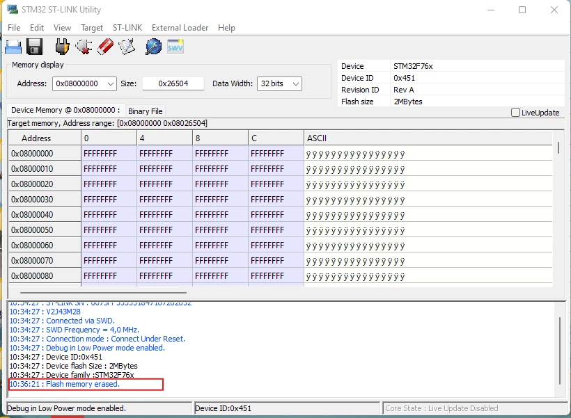

I tried with ST Cube Programmer but it didn't worked, later I tried with ST Utility, I Erased Chip memory. By setting option bytes
Now I am able to Flash the code. But MCU state is halted

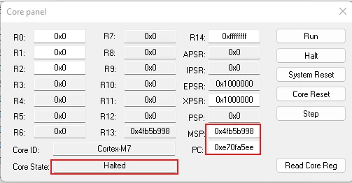

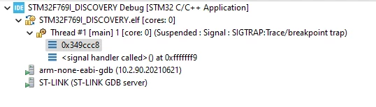

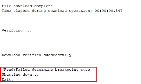

But code is not executing, I tried debug but
After flash I connected again to ST Utility to check MCU state.
PC should point to 0x80000000 it is pointing to some other address, How can i set it back ?
