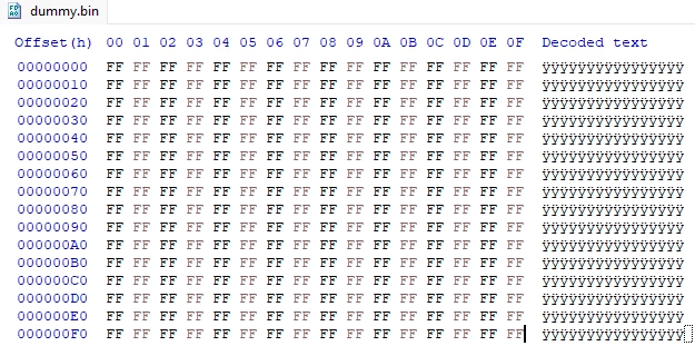

Create dummy.bin that is filled with 256 bytes of FF's. For example with HxD tool.
Sign it with no keys:

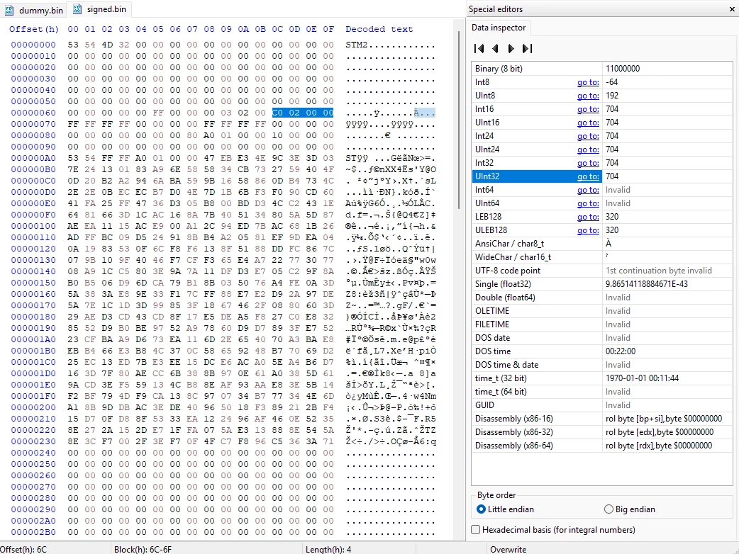

STM32_SigningTool_CLI.exe -bin dummy.bin --type fsbl --no-keys --option-flags 0x80000000 --output signed.bin --dump-header signed.bin --header-version 2.3 --align
View the signed.bin with hex viewer (e.g. HxD) at offset 0x6C which is Image length by UM3234 rev 2:
It is 0x2C0 = 704. This is 448 bytes more than original 256 bytes.

Version 2.3 FSBL image header is 576 bytes long and it has additional 448 alignment bytes which sum up as 1024. Executable image (FSBL itself) starts at the 1024th byte. Image length field (32-bits) at base header offset 0x6C is made of executable image length + alignment bytes (448). Image checksum field (32-bits) at base header offset 0x64 is sum of alignment bytes and executable image bytes. All info from UM3234 Secure boot.
