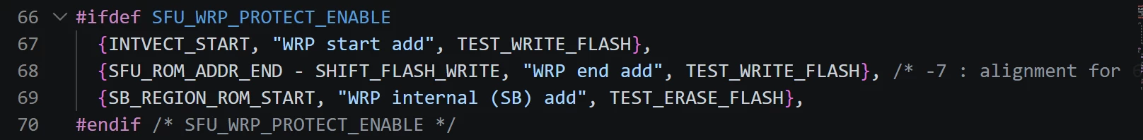

  1. I have enabled WRP and RDP Level 1 by setting the option bytes through cubeprogrammer and enabling SFU_WRP_PROTECT_ENABLE & SFU_RDP_PROTECT_ENABLE in app_sfu.h
  2. I have enabled SFU_TEST_PROTECTION in app_sfu.h
Note:
There are several test cases in sfu_test.c that I am using. The tests in questions are attached below:

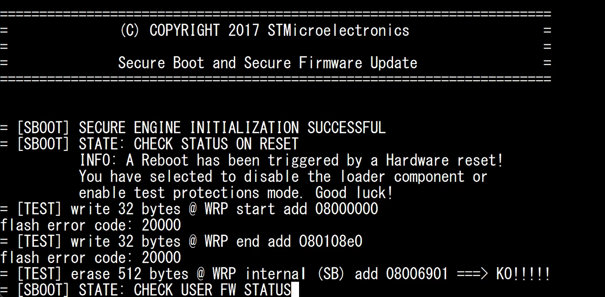

TEST_ERASE_FLASH is failing.
Output:
I am not sure why this would be. Does anyone have any advice?

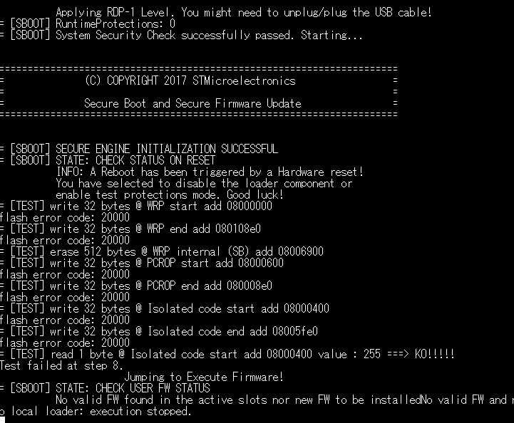

Update:
TEST_WRITE_FLASH and TEST_ERASE_FLASH are now working. However, TEST_READ_FLASH is consistently failing. I believe WRP is working but RDP is not.

Fixed. This was a misunderstanding on my part.
RDP protects against external attack while this test suite attempts invalid access internally.
Enabling the MPU protections (SFU_MPU_PROTECT_ENABLE ) triggers a reset on each invalid read/write which is what should happen.
