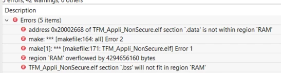

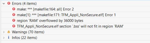

I have tried changing MEMORY region like below.
MEMORY
FLASH (rx) : ORIGIN = NS_CODE_START, LENGTH = NS_CODE_SIZE
RAM (rwx) : ORIGIN = _SRAM3_BASE_NS + 0x8400, LENGTH = 0X3C800
/*RAM (rwx) : ORIGIN = NS_DATA_START, LENGTH = NS_DATA_SIZE*/
And I have got compilation error as,
If it is because I have not performed "you will need to allocate..
part of your data in this area" I have to try this as I am not expert in LD files.
If issue is something else kindly advice me.
Thanks in advance.

NitinAuthor
April 30, 2024
Hi Jose, by getting some understanding of linker script I made it work. Thanks to your guidance in above reply. You are amazing as always:)
