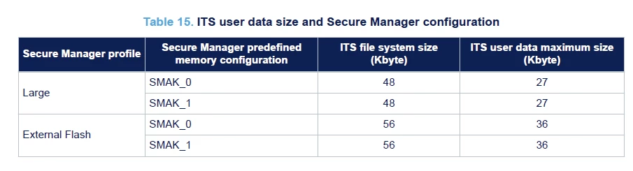

we have a question regarding the Secure Manager Internal Trusted Storage size on the STM32H73 series.
We have configured the following options:
  • external flash profile
  • 0 secure modules (=SMAK_0 ?)
According to UM3254 it is our understanding the ITS size can now be up to 56 Kbyte:
Our application project.py prebuild seems to extract value “9”, which means 9 * 8 Kbyte (Flash sector size) = 72 Kbyte?
Jul  8 13:27:10 2026 : [INF] Searching the parameter with <Name>ITS size</Name> element
2026-07-08 13:27:10,542 - DEBUG - Wed Jul  8 13:27:10 2026 : [INF] Parameter found. Verifying information of '<Value>0x9</Value>'
2026-07-08 13:27:10,543 - DEBUG - Wed Jul  8 13:27:10 2026 : [INF] The modification is not necessary
2026-07-08 13:27:10,543 - DEBUG - Wed Jul  8 13:27:10 2026 : [INF] The tag <Value> has already the correct content (0x9)
Is there a misunderstanding on our end about the profile, memory configuration, UM3254 table, the prebuild proccess or the conversion factor between the prebuild factor 0x09 and Kbyte?
Because 0x09 * 4 Kbyte would fit the 36Kbyte user data size from the table above.
However “ITS Factory size” is extracted as 0x02, and that expresses 2 * 8 Kbyte = 16 Kbyte according to documentation.
Thank you and best regards
Jakob

Hello ​@jjm ,
This size of 9 sectors provided in the xml configuration file (C:\ST\X-CUBE-SEC-M-H5_V2.1.0\Projects\STM32H573I-DK\ROT_Provisioning\SM\Config\Profile_External_Flash\SM_Config_General_Ext_Flash.xml) also includes the 2 sectors used by the Factory ITS (see paragraph 4.1.3.3) .
So, 7*8KB = 56KB for dynamic ITS + 2*8KB = 16KB of factory ITS.
The second column actually shows maximum available size for user. The ITS requires some spare sectors to manage robust updates.
Best regards
Jocelyn

Thank you, that resolves my confusion!
