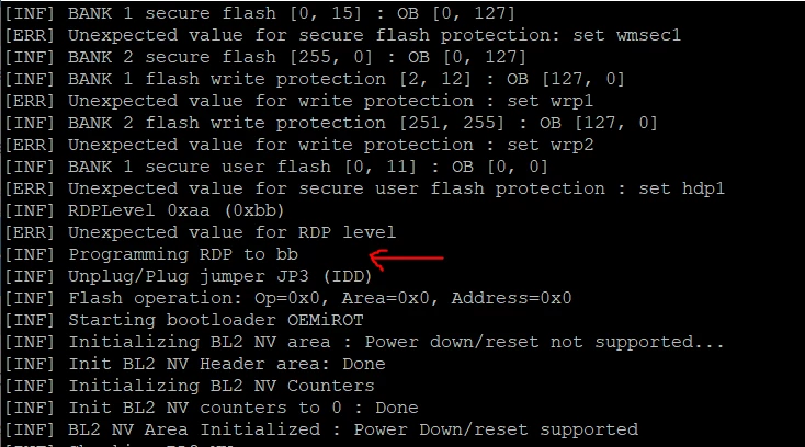

I adjusted the projects for STM32U5G9 target, disabled TAMPER since the pins aren't valid on the U5G9 EVK, compiled the 5 projects in the prescribed order and ran the `dataimg.sh` script.  Finally, I ran the regression and program script and rebooted my EVK.  The bootloader printed various things but stops after printing "[ERR] Unable to find bootable image".  With some additional logs added, it appears that the slot / image header is all 0xFF, which causes a failure in `Middlwares/mcuboot/loader.c : boot_validate_slot()`.  Not sure why this would be.

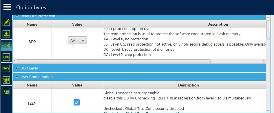

I did notice the bootloader sets Option Byte RDP to 0xBB, but STM32CubeProgrammer shows different values:
Maybe the RDP values are just different with TrustZone enabled?
