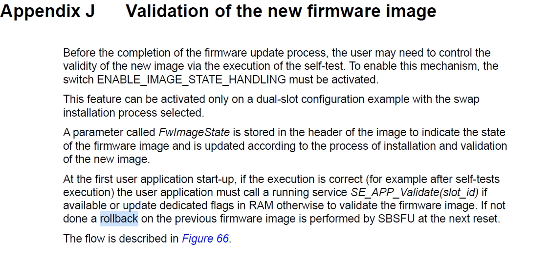

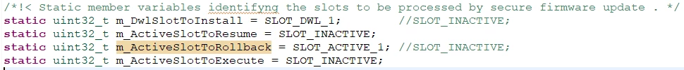

I am following the UM2262 document. I will add a screenshot. I enabled the ENABLE_IMAGE_STATE_HANDLING flag to enable rollback, but after updating UserApp.bin, the device continues to reset. I will add a debug log screenshot (it’s not jumping into the application). Please help me with any references for the rollback feature using the SBSFU package version 2.6.x.
Document image 1:
Debug image 2:

Hello @Kurien_Raju ,
as far as I remember, you need to add this flag to all projects (SBSFU, SECoreBin, appli), and perform a clean build for each one to make this work.
Is this what you have done ?
Best regards
Jocelyn

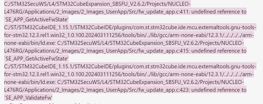

Hi @Jocelyn RICARD
I followed same step, but I am getting undefined reference error I added screenshot
 screen shot image1:
screen shot image 2: error log stm32 cubeide:
C:/STM32SecuWS/L4/STM32CubeExpansion_SBSFU_V2.6.2/Projects/NUCLEO-L476RG/Applications/2_Images/2_Images_UserApp/Src/fw_update_app.c:411: undefined reference to `SE_APP_GetActiveFwState'
C:/ST/STM32CubeIDE_1.15.1/STM32CubeIDE/plugins/com.st.stm32cube.ide.mcu.externaltools.gnu-tools-for-stm32.12.3.rel1.win32_1.0.100.202403111256/tools/bin/../lib/gcc/arm-none-eabi/12.3.1/../../../../arm-none-eabi/bin/ld.exe: C:/STM32SecuWS/L4/STM32CubeExpansion_SBSFU_V2.6.2/Projects/NUCLEO-L476RG/Applications/2_Images/2_Images_UserApp/Src/fw_update_app.c:415: undefined reference to `SE_APP_GetActiveFwState'
C:/ST/STM32CubeIDE_1.15.1/STM32CubeIDE/plugins/com.st.stm32cube.ide.mcu.externaltools.gnu-tools-for-stm32.12.3.rel1.win32_1.0.100.202403111256/tools/bin/../lib/gcc/arm-none-eabi/12.3.1/../../../../arm-none-eabi/bin/ld.exe: C:/STM32SecuWS/L4/STM32CubeExpansion_SBSFU_V2.6.2/Projects/NUCLEO-L476RG/Applications/2_Images/2_Images_UserApp/Src/fw_update_app.c:423: undefined reference to `SE_APP_ValidateFw'
collect2.exe: error: ld returned 1 exit status

Jan 7, 2025 5:00 AM UTC
Hi @jocelyn RICARD,
I Resolve the undefined refers error. after enabling flag. but when new firmware updated. not valid it should rollback to previous version. but it's not rollback.

Jocelyn RICARD
Jan 7, 2025 4:55 PM UTC
Hello @Prakash_Raj1994 ,
I made the test on STM32L476 Nucleo.
There are 2 issues related to the activation of the image validation feature
1) The file Projects\NUCLEO-L476RG\Applications\2_Images\2_Images_SBSFU\STM32CubeIDE\se_interface.txt is missing the calls to SE_APP_ValidateFw and SE_APP_GetActiveFwState.
Here is the what should be the content of this file:
SE_APP_GetActiveFwInfo
SE_APP_ValidateFw
2) With default configuration, the validation will trigger a reset.
Reason is MPU configuration setting all the active slot as read only.
An easy way to fix it is to comment #define SFU_MPU_USERAPP_ACTIVATION in app_sfu.h
Best regards
Jocelyn

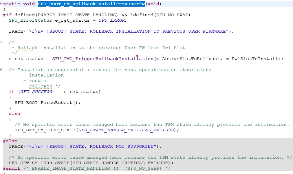

Jan 8, 2025 5:33 AM UTC
Hello @Jocelyn RICARD ,
I follow the same steps to resolve undefined refers and comment out the
// #define SFU_MPU_USERAPP_ACTIVATION in app_sfu.h
rollback function is triggering but rollback is not happening for next rest debug log  Backed-up fw not identified & waiting local download I attached Debug log:
Debug Log: -

Jocelyn RICARD
Jan 8, 2025 10:06 AM UTC
I don't have such issue.
Here you seem to have a new firmware that is not valid, so installation does not even occur.
Please check if you didn't change anything mode compared to original example
Best regards
Jocelyn

Jocelyn RICARD
Jan 8, 2025 10:52 AM UTC
You need to disable #define SFU_MPU_USERAPP_ACTIVATION in app_sfu.h
"I compiled only the SECoreBin and userApp (a new key is generated and added into UserApp.sfb), making the original UserApp.sfb invalid, and then updated it through UART."
First, you need to compile SECoreBin, SBSFU, and UserApp
There is never new key generated. Keys are located in SECodeBin/Binary. What is generated is se_key.s
Also, if you want to check the rollback, please rename the output binary files generated to avoid losing previous one.
Something like UserAppA.sfb/UserAppB.sfb
Best regards
Jocelyn

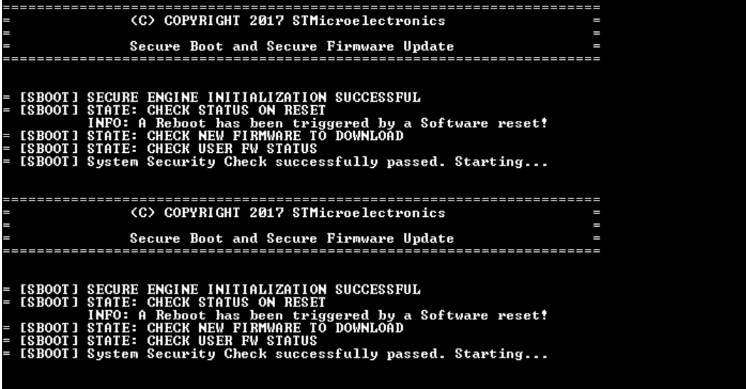

Feb 14, 2025 5:22 PM UTC
Hi @Jocelyn RICARD ,
I have tested SBSFU Example with NucleoL476RG board with not setting compiler flag ENABLE_IMAGE_STATE_HANDLING .
1. I have flashed the Bootloader application and changing the firmware version from A,(version 1,1)B(version      1,2),C(version 1,3),D(version 1,4),E(version 1,5).
  Working as Accepted.
2. When I have updated the ENABLE_IMAGE_STATE_HANDLING flag and commented  the SFU_MPU_USERAPP_ACTIVATION macro .
Updating the version A (version1.1) ,B(version 1.2) works fine .
when i am trying to update the C(version 1.3) Facing issue i will add the log below please help me out this
DEBUG LOG:-

= [SBOOT] SECURE ENGINE INITIALIZATION SUCCESSFUL
= [SBOOT] STATE: CHECK STATUS ON RESET
INFO: A Reboot has been triggered by a Software reset!
= [SBOOT] STATE: CHECK NEW FIRMWARE TO DOWNLOAD
= [SBOOT] STATE: CHECK USER FW STATUS
New Fw to be installed from slot SLOT_DWL_1
= [SBOOT] STATE: INSTALL NEW USER FIRMWARE
Image preparation done.
Swapping the firmware images.....................................................
========= End of Execution ==========
= [SBOOT] System Security Check successfully passed. Starting...
= (C) COPYRIGHT 2017 STMicroelectronics =
= Secure Boot and Secure Firmware Update =
A FW is detected in the slot SLOT_ACTIVE_1
= [SBOOT] STATE: VERIFY USER FW SIGNATURE
= [SBOOT] STATE: EXECUTE USER FIRMWARE
= User App #B =
=================== Main Menu ============================
Download a new Fw Image ------------------------------- 1
Test Protections -------------------------------------- 2
Test SE User Code ------------------------------------- 3
Multiple download ------------------------------------- 4
Validate a FW Image------------------------------------ 5
Selection :
================ New Fw Download =========================
-- Send Firmware
-- -- Erasing download area ...
-- -- File> Transfer> YMODEM> Send
-- -- Programming Completed Successfully!
-- -- Bytes: 22736
-- Image correctly downloaded - reboot
AFTER UPDATING C (1.3VERSION)
Installation not validated: rollback procedure initiated (SLOT_ACTIVE_1 / SLOT_DWL_1)
= [SBOOT] STATE: ROLLBACK INSTALLATION TO PREVIOUS USER FIRMWARE
Fw version rejected (anti-rollback)
= [SBOOT] STATE: HANDLE CRITICAL FAILURE
= [SBOOT] STATE: REBOOT STATE MACHINE
Slot SLOT_ACTIVE_1 not empty : erasing ...
No valid FW found in the active slots nor new FW to be installed
Waiting for the local download to start...
= [SBOOT] STATE: DOWNLOAD NEW USER FIRMWARE
File> Transfer> YMODEM> Send .........
