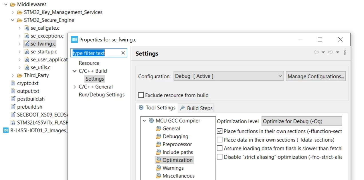

1) Change compiler option for se_fwimg.c
0693W00000QKT0OQAX.png2) Rebuild SECoreBin Project
3) Clean and build SBSFU project

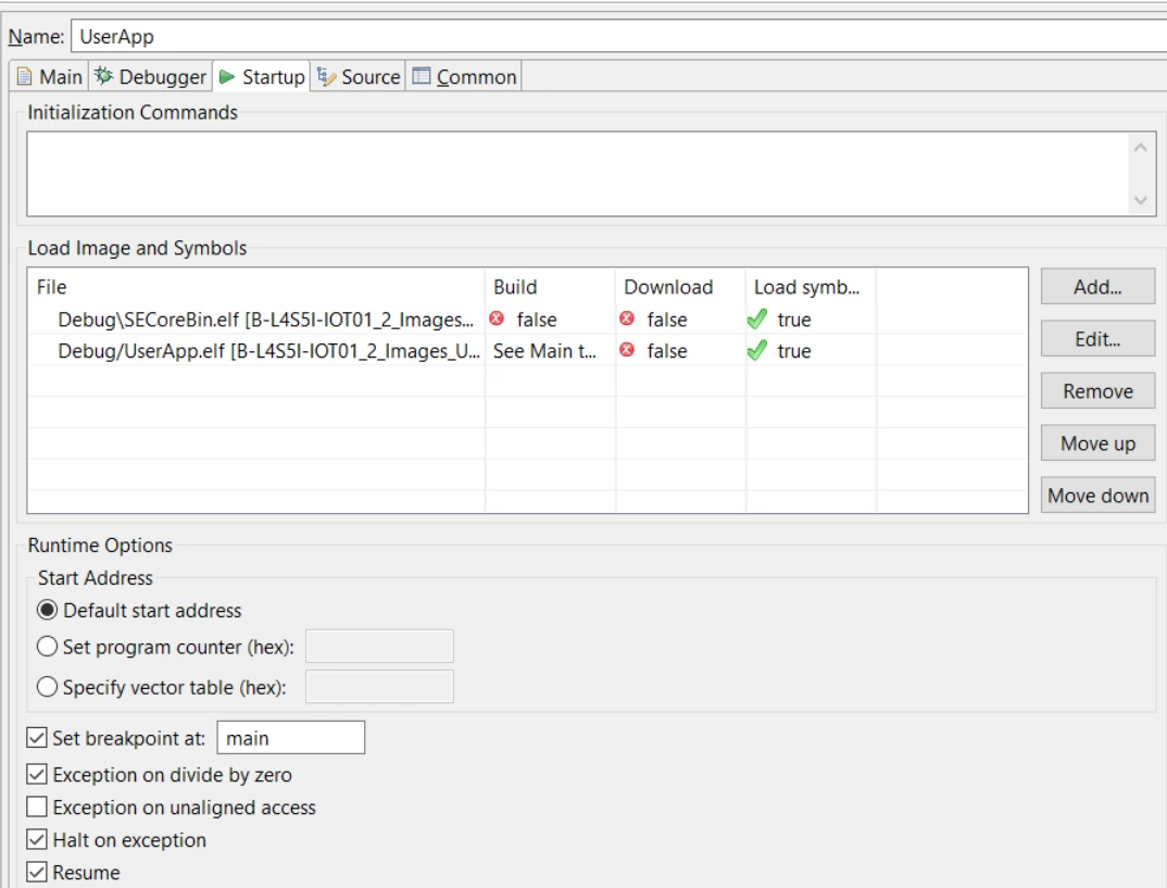

7) In main debug tab you can disable autobuild
8) go to startup tab, add SECoreBin and disable download:
0693W00000QKT2FQAX.pngThat's it !

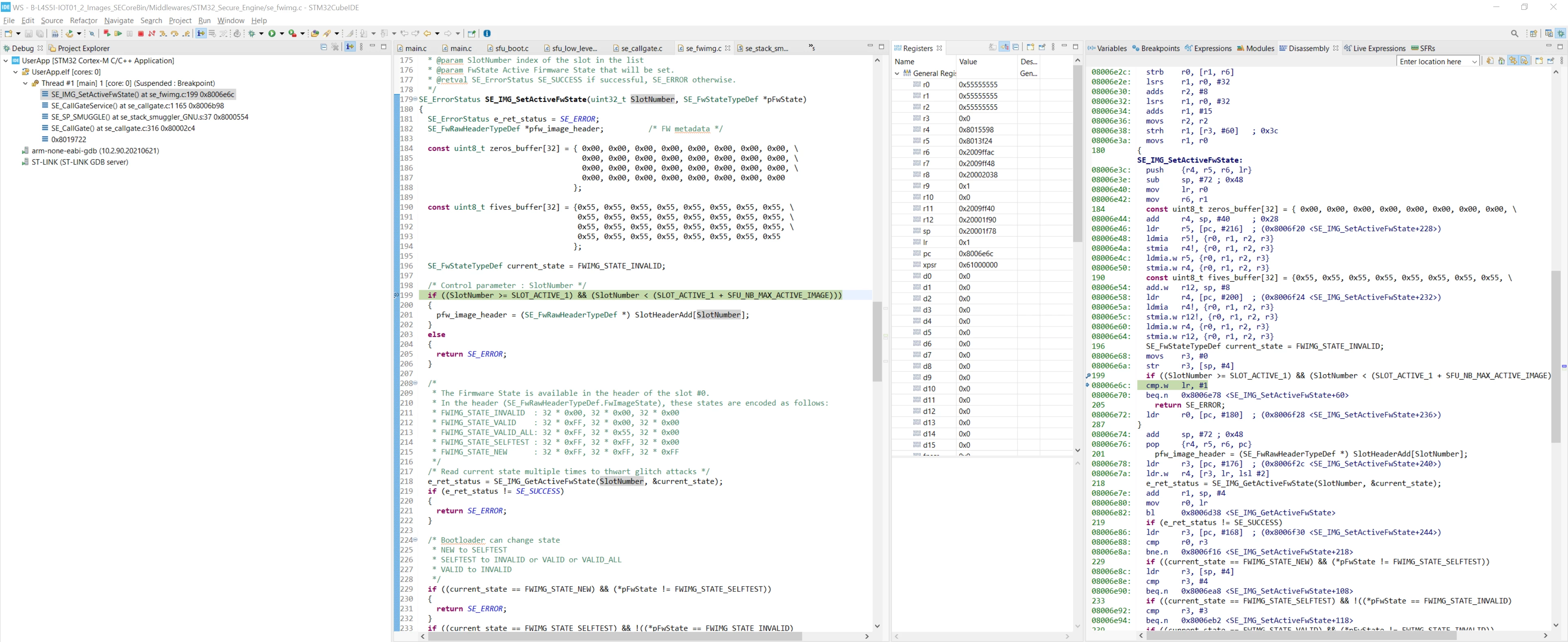

In debug session you should get something like:
0693W00000QKT59QAH.pngYou can check with assembly window that code is well aligned with instructions. This is an important if you are not 100% sure.
Then you can step in the code, and with debug optimization of this part you should follow the code order.

Hello @Community member​ ,
First, thank you for sharing your project and build details. Build went smoothly.
Regarding debug configuration. You added SBSFU in the picture.
To make things work with also SBSFU, the SECoreBin.elf should be in first place.
One possible reason for the issue you are facing (step debugging is going in random places) could be related to your USB cable or intermediate USB Hub.
