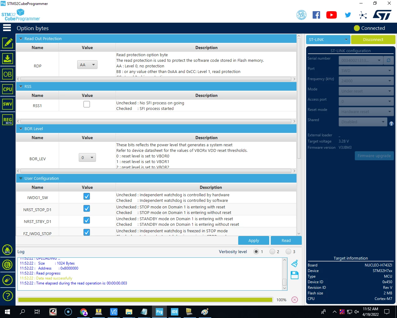

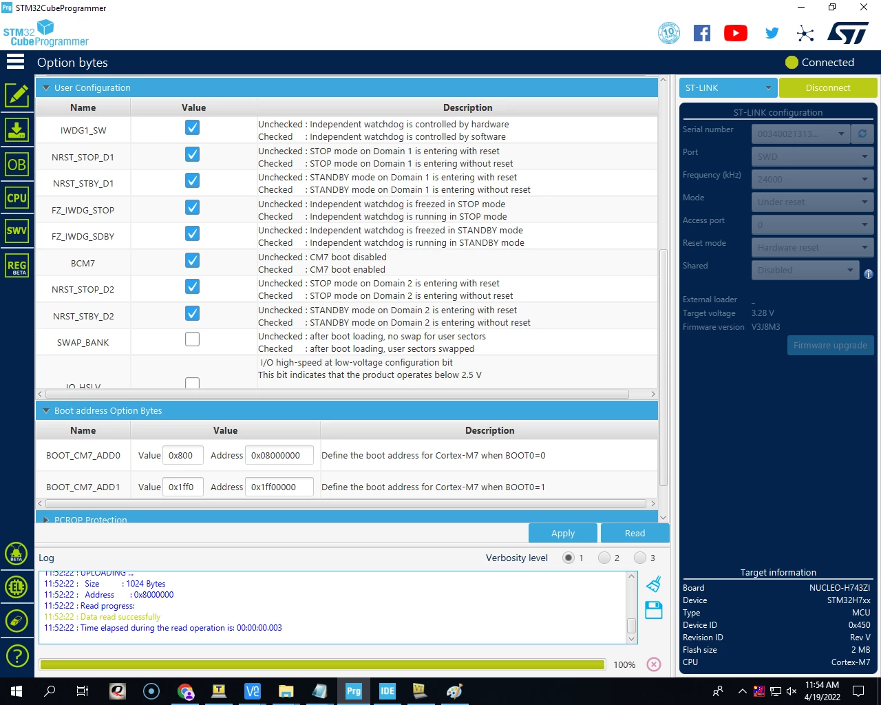

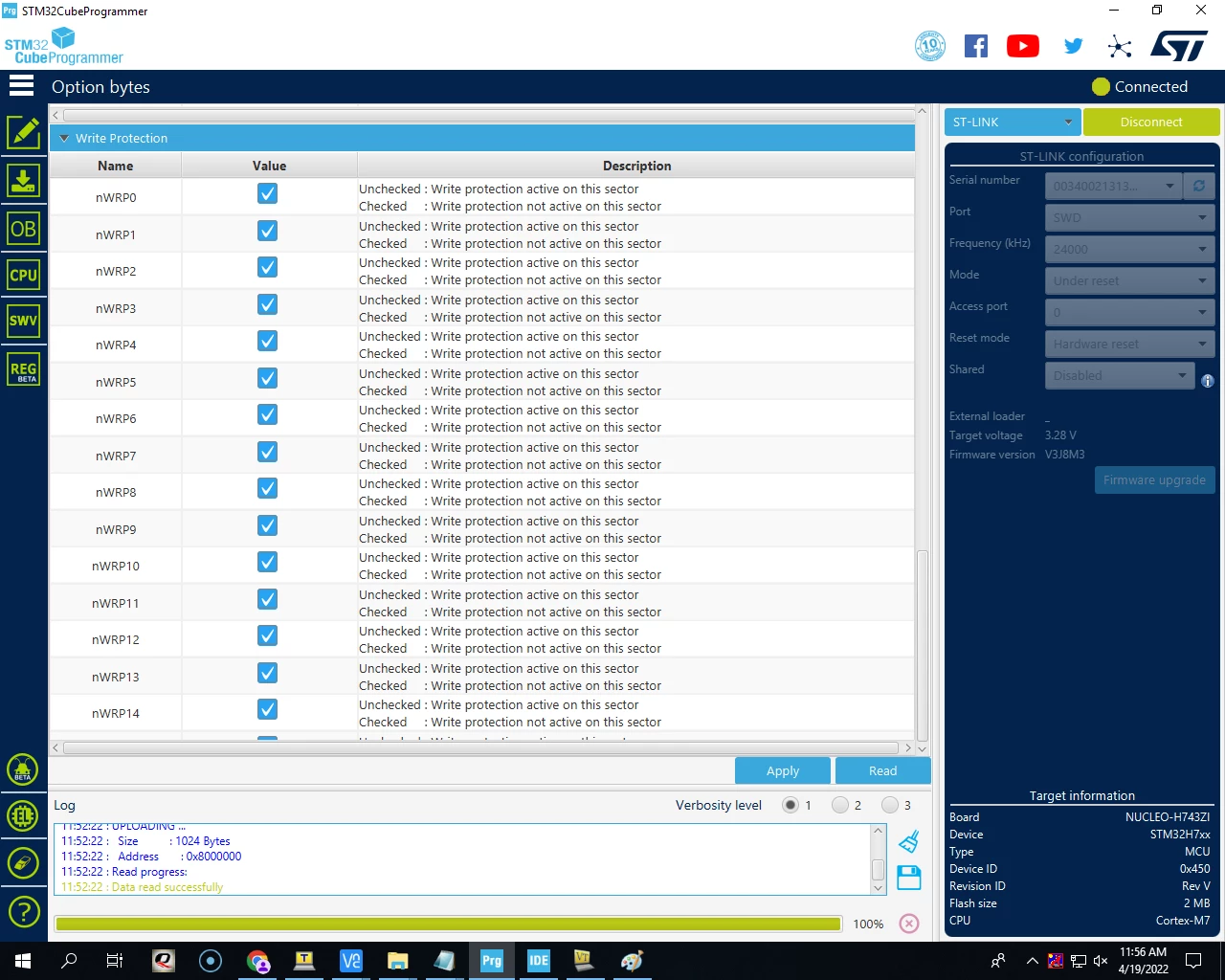

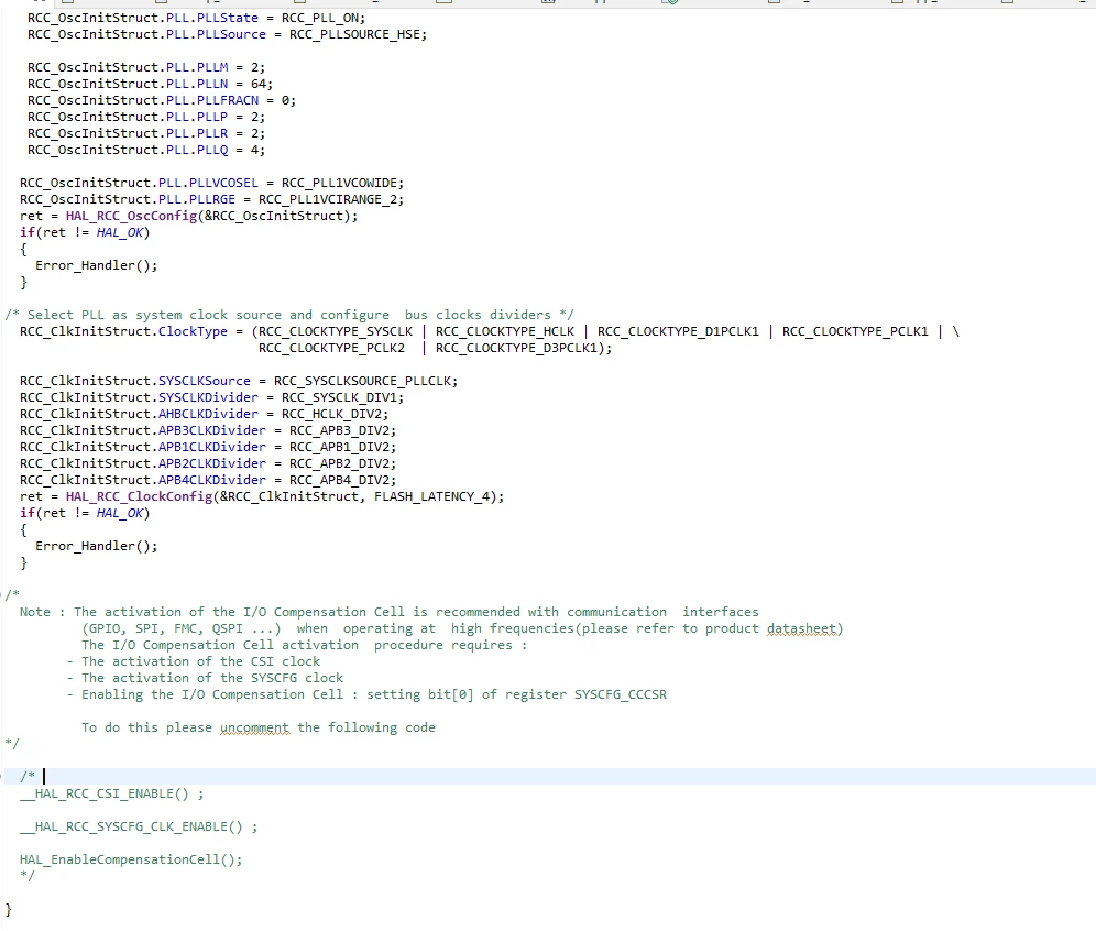

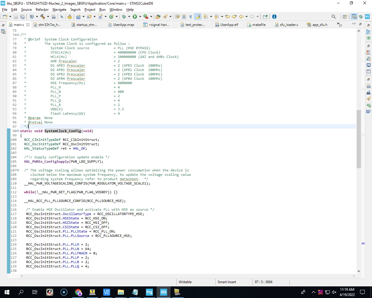

  1. My Nucleo STM32H743ZI board has a 25 Mhz External crystal, so I change the clock config in the SBSFU file STM32H753ZI-Nucleo_2_Images_SBSFU and STM32H753ZI-Nucleo_2_Images_UserApp as shown below images. Is it correct ? or not then please suggest the correct Clock Config as per 25 Mhz Crystal. 0693W00000LyHHDQA3.png0693W00000LyHG0QAN.png

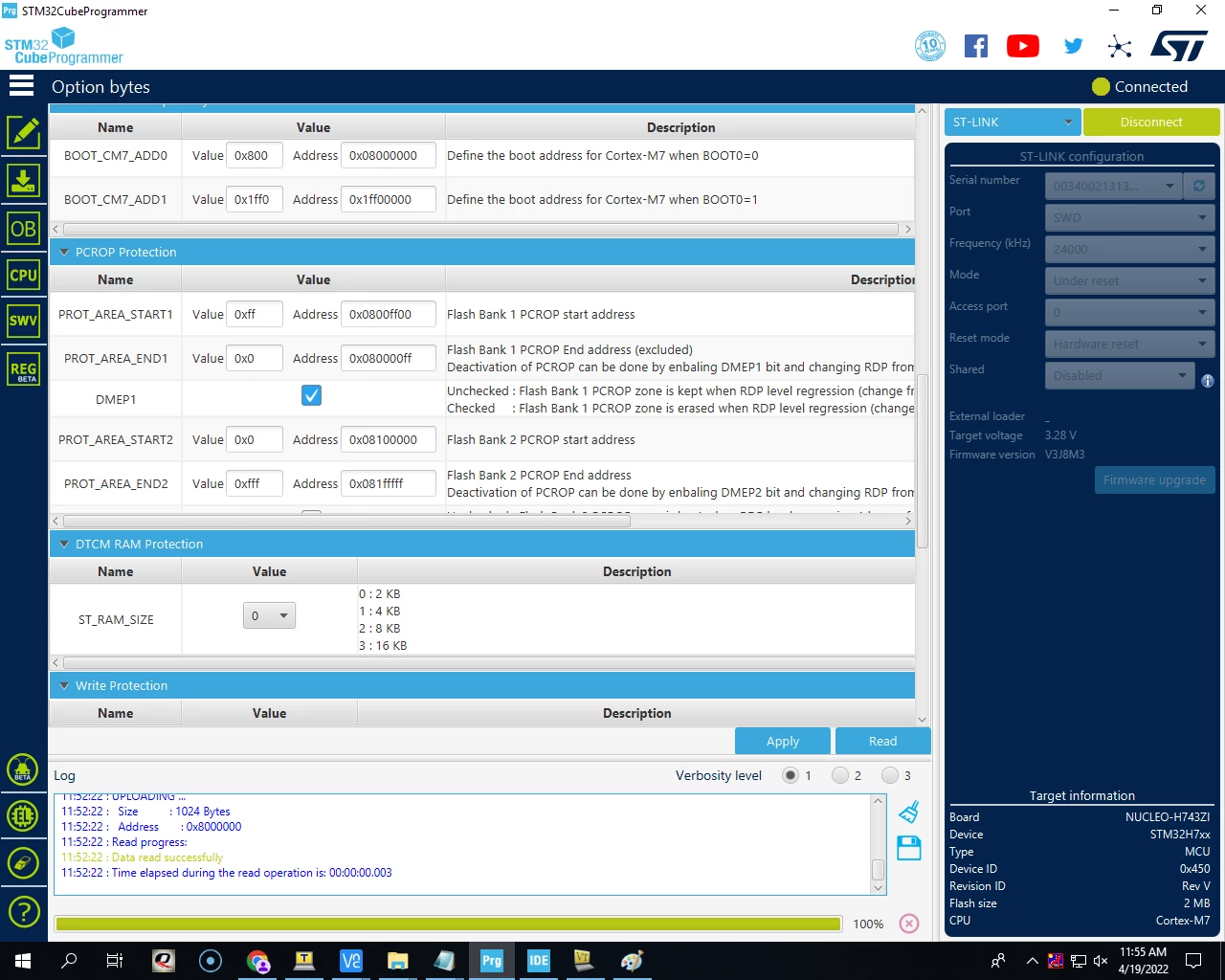

  2. What is the Option bytes configuration for Nucleo STM32H743ZI? I selected Option bytes as shown below image. Is it correct? If not then please suggest the correct Option bytes configuration for Nucleo STM32H743ZI MCU.0693W00000LyHebQAF.png0693W00000LyHevQAF.png0693W00000LyHa6QAF.png0693W00000LyHfAQAV.png

1. For the clock configuration, I recommend using CubeMX.
You can create a basic CubeMX project just to generate the clock as per your clock tree configuration.
Then you generate the oce and copy/paste only the clock configuration function form the generated CubeMX project to X-CUBE-SBSFU projects.
If you are not familiar with STM32CubeMX then you can follow this quick tutorial:
STM32StepByStep:Step2 Blink LED - stm32mcu
2. For the option bytes, you can refer to section 8.1 in this UM:
Getting started with the X-CUBE-SBSFU STM32Cube Expansion Package - User manual
It is not perfect but it gives a reference.
Then, if something goes wrong it should be captured by the SBSFU project when checking the option bytes at startup.
