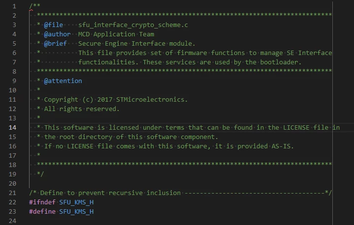

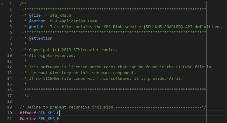

Hello all,
In both files sfu_kms.h and sfu_interface_crypto_scheme.h there is a header guard called SFU_KMS_H.
sfu_kms.h:
sfu_interface_crypto_scheme.h:
Is that a bug or intentional decision?
Best answer by Jocelyn RICARD
Hello Jakub,
it looks like a copy paste error!
Now, the 2 files are not related not used in same .c file so it works...
But I will raise the issue
Best regards
Jocelyn

Hello Jakub,
Best regards
Jocelyn
February 5, 2024
Thanks, much appreciated!
