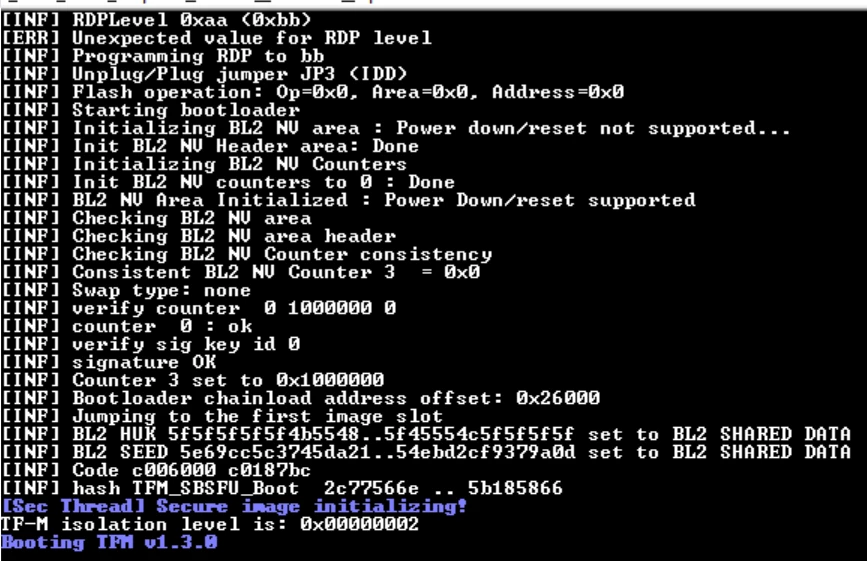

I was testing this as per the shared code and testing the package, the chip is resetting again and again, probably the access is wrong. Made changes as per the above comment but the access to secure area from the non secure area was not working properly and the TFM example is reset right from the bootloader and the action is repetitively happening. Please suggest the possible solution for this approach.

I have tried multiple steps that are described in different approaches as described below:
1. in the cube u5 firmware package v1.2 executed the same files as it is only compared and added the new changes that were mentioned in the new main.c(non secure) area and app_rot_test.c(secure) in the existing files(main.c and app_rot_test.c).
2. completely replaced the existing main.c file and app_rot_test.c with the files that are shared in this thread. One query is like there is a file testprotection.c in the non secure area with more or less same contents as app_rot_test.c. Could you please throw some light into the usage of testprotection.c and app_rot_test.c. There is one function in the file that was shared from your end:
void set_rcc(void);
this function doesnt have a definition in the file and the function was used in the below snippet: but this snippet is commented:
 { (uint32_t) &set_rcc, "RCC SEC Clock recovery fun call", TEST_PRIV_EXECUTE, NOT_APPLICABLE, ALLOWED},
when commenting these statements and executing the package the reset error is not visible but the secure function is not being called.
The following is the output when commenting the function set_rcc() and commenting the above snippet.
One more query - is initialisation of RTC required for testing these steps.
Both these approach are giving same errors. going into reset. If i am commenting the new test that has been added and executing the TFM Example, the example runs fine without any issues.
