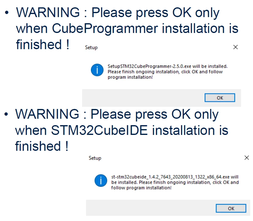

    In the installation instructions:

    Hello Andrew,
    Explanation : the installer launch installation of STM32CubeProgrammer but installer can't detect this installation is finish to install the next software component. This is to explain the warning.
    What you need to do :
    launch installer
    first it will launch STM32CubeProgrammer installation. When installation of STM32CubeProgrammer is finished click on OK.
    Then it will launch installation of STM32CubeIDE installation. When installation of STM32CubeIDE is finished click on OK
    If you still face issue, let us know and we can organize a quick help session

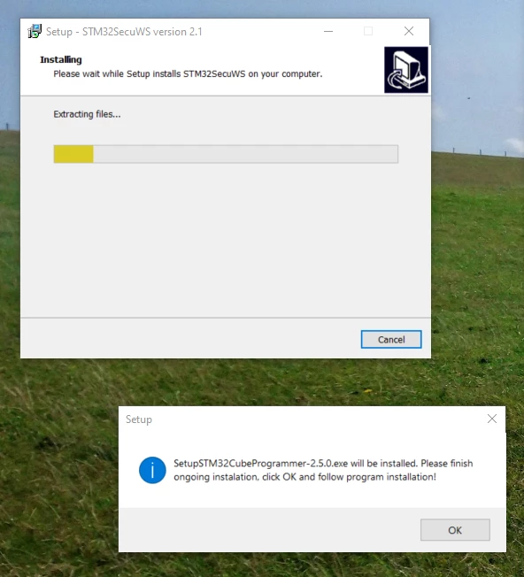

    Andrew Neil
    Nov 19, 2020 10:20 AM UTC
    "the installer launch installation of STM32CubeProgrammer but installer can't detect this installation is finish"
    I guess that's the intention - but it's not working that way.
    The installer is not launching the installation until I OK the message!
    This is on Windows10-Pro.
    I ignored what the message says, and just pressed 'OK' - and all the installations appear to have completed.

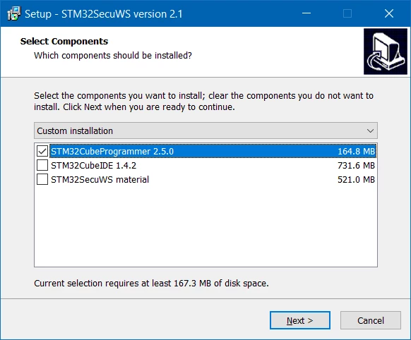

    So I ran the STM32SecuWS setup again, and selected only the Cube Programmer:
    Again, this message appears:
    0693W000005BxIfQAK.pngBut that stalls the installation - nothing happens so long as that message is displayed.
    I have to click the 'OK' to get the installation to start.
    But, once I click OK, it does seem to proceed.

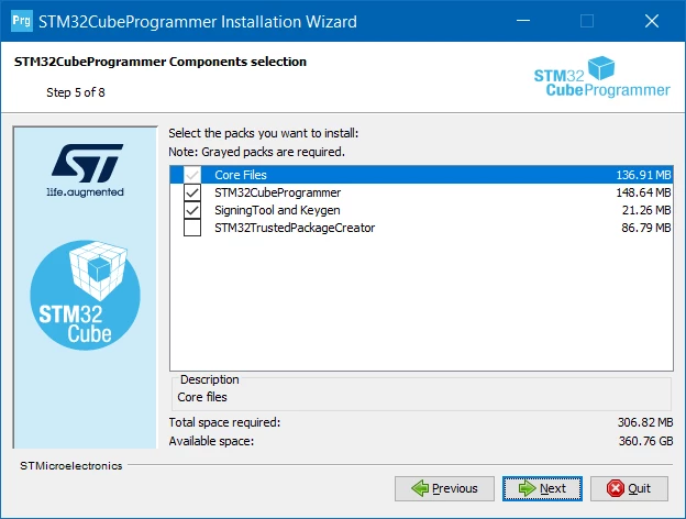

    0693W000005BxJsQAK.pngShould the 'STM32TrustedpackageCreator' be checked?
    (I did check it, just in case...)
