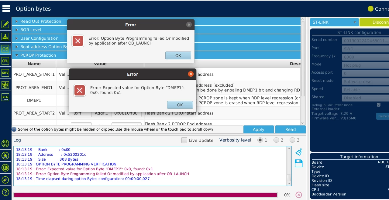

Hello everyone,

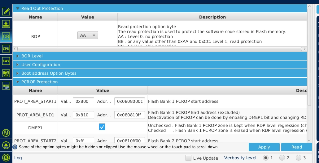

I'm experimenting PCROP activation on stm32h743 following this ST-tutorial: https://youtu.be/7Wr90XFA8_Q?si=tDpqUtMdin9Oyn-P
The activation works fine but i cannot disable PCROP using CubeProgrammer.
I did a RDP1 to RDP0 regression with DMWP1 checked but the PCROP is still active

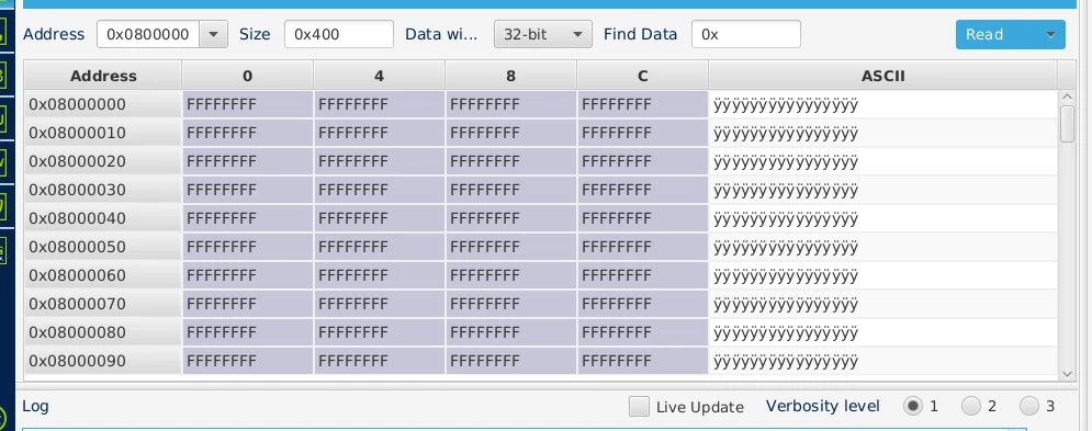

After RDP regression i can se that the unprotected flash are is erase:

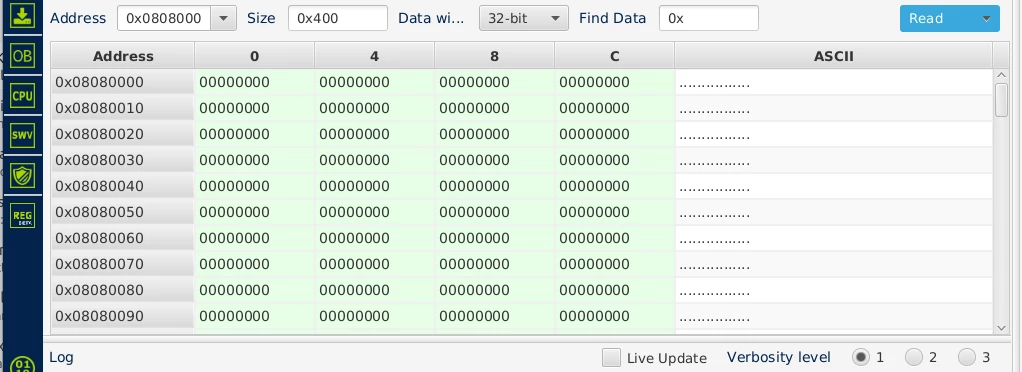

But not the protected one:
I can also not change the option bytes anymore, even RDP0 to RDP1 does not work
How can i recover from this situation ?

Hello @aco990 ,
Try to do a power on reset (unplyg and replug the board basically) and connect under reset.
If it does not work, please dump the option bytes here using programmer CLI
Best regards
Jocelyn

Jocelyn RICARD
June 5, 2024
STM32_Programmer_CLI.exe -c port=SWD mode=UR -ob displ

Jocelyn RICARD
June 5, 2024
Hello @aco990 ,
I reused exact same setting and didn't face any issue.
Could you please check you are using latest version of CubeProgrammer (2.16) and also recent version of STLink firmware (Firmware Upgrade button on right side of programmer panel)
Are you using a Nucleo board ?
Best regards
Jocelyn

Jocelyn RICARD
June 5, 2024
Hello @aco990
Here is what I get with same board:
Setting the option bytes identical to yours:

 PCROP Protection:
 PROT_AREA_START1: 0x800 (0x8080000)
 PROT_AREA_END1: 0x810 (0x80810FF)
 DMEP1 : 0x1 (Flash Bank 1 PCROP zone is erased when RDP level regression (change from level 1 to 0) occurs)
 PROT_AREA_START2: 0xFF (0x810FF00)
 PROT_AREA_END2: 0x0 (0x81000FF)
 DMEP2 : 0x0 (Flash Bank 2 PCROP zone is kept when RDP level regression (change from level 1 to 0) occurs)
██████████████████████████████████████████████████ 100%
PROGRAMMING OPTION BYTES AREA ...
 Bank : 0x00
 Address : 0x5200201c
UPLOADING OPTION BYTES DATA ...
 Bank : 0x00
OPTION BYTE PROGRAMMING VERIFICATION:
Option Bytes successfully programmed
Time elapsed during option Bytes configuration: 00:00:04.561
So, could you please try using same commands an show the traces?

aco990AuthorBest answer
June 6, 2024
Hi @Jocelyn RICARD ,
now PCROP is removed and the device is working fine! :)
If you encounter the same problem a "bank mass erase with automatic protection-removal" as described in the reference manual could help you:
__HAL_FLASH_CLEAR_FLAG_BANK1(FLASH_FLAG_ALL_ERRORS_BANK1);
HAL_FLASH_OB_Unlock();
SET_BIT(FLASH->PRAR_PRG1, FLASH_PRAR_DMEP);
uint32_t temp = ~((0xFFF << 0) | (0xFFF << 16));
FLASH->PRAR_PRG1 &= temp; // Clear bits 11:0 and 27:16
FLASH->PRAR_PRG1 |= (2 << 0);
FLASH->WPSN_PRG1 = 0xFF;
HAL_FLASH_Unlock();
SET_BIT(FLASH->CR1, FLASH_CR_BER);
SET_BIT(FLASH->CR1, FLASH_CR_START);
while (READ_BIT(FLASH->SR1, FLASH_SR_QW) > 0) {} // Wait for erase completion

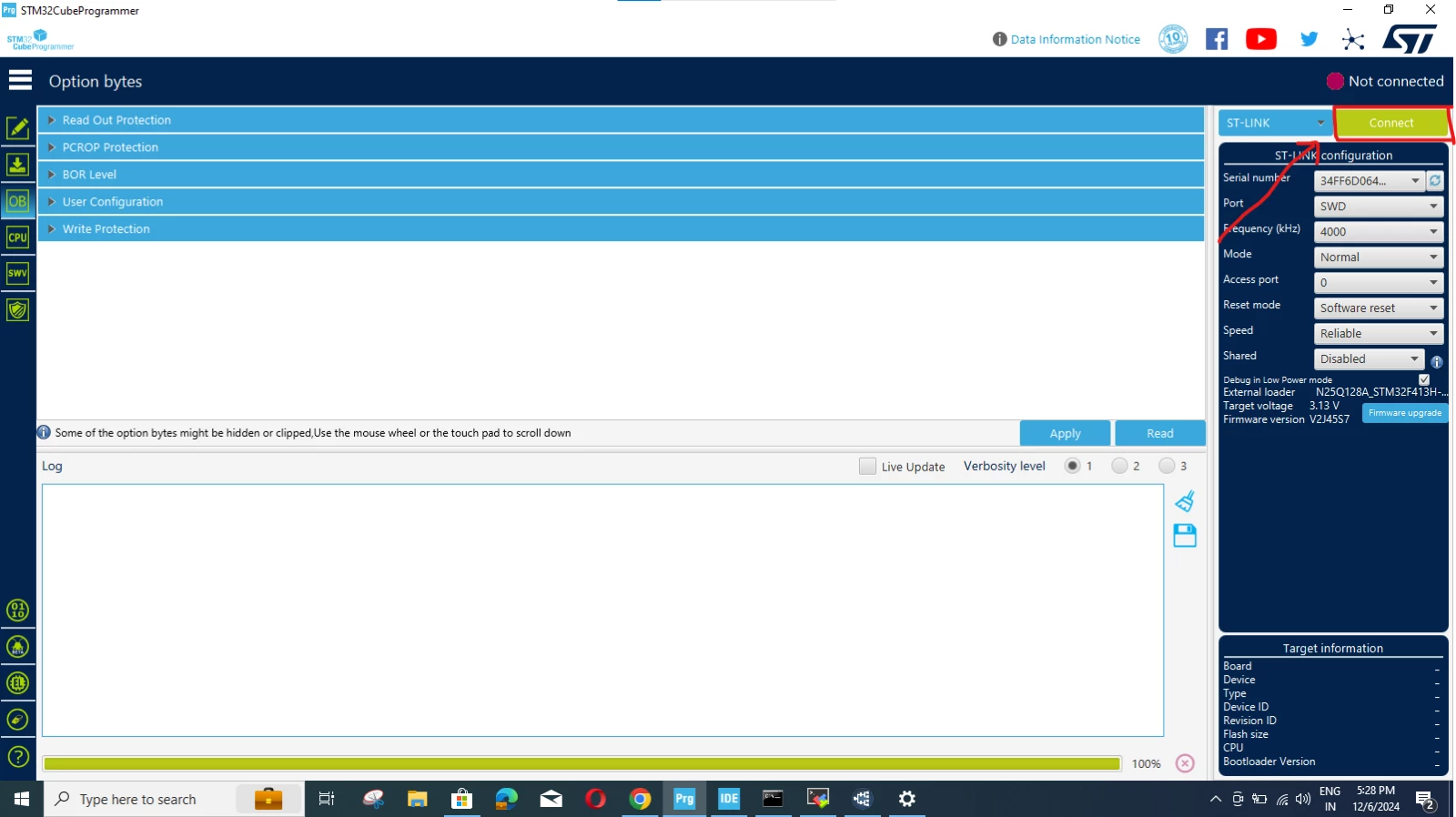

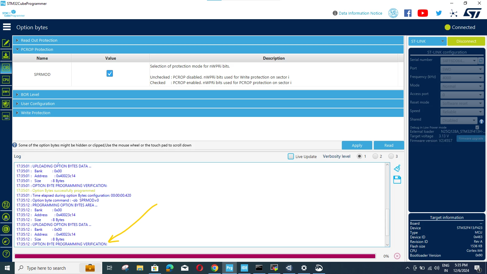

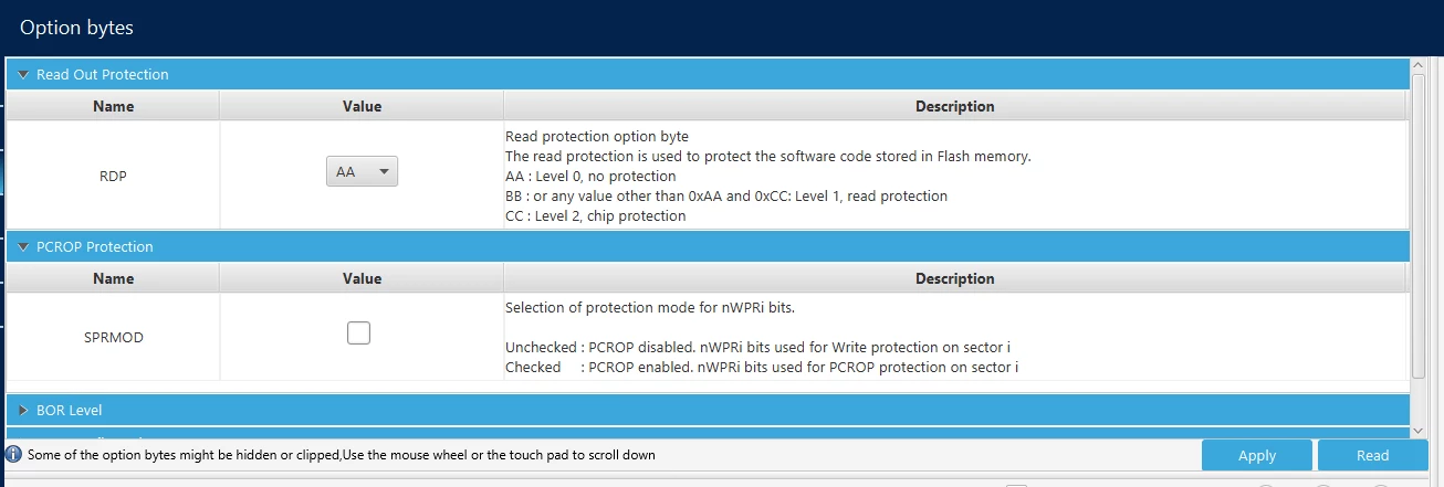

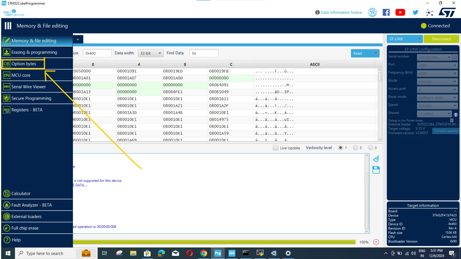

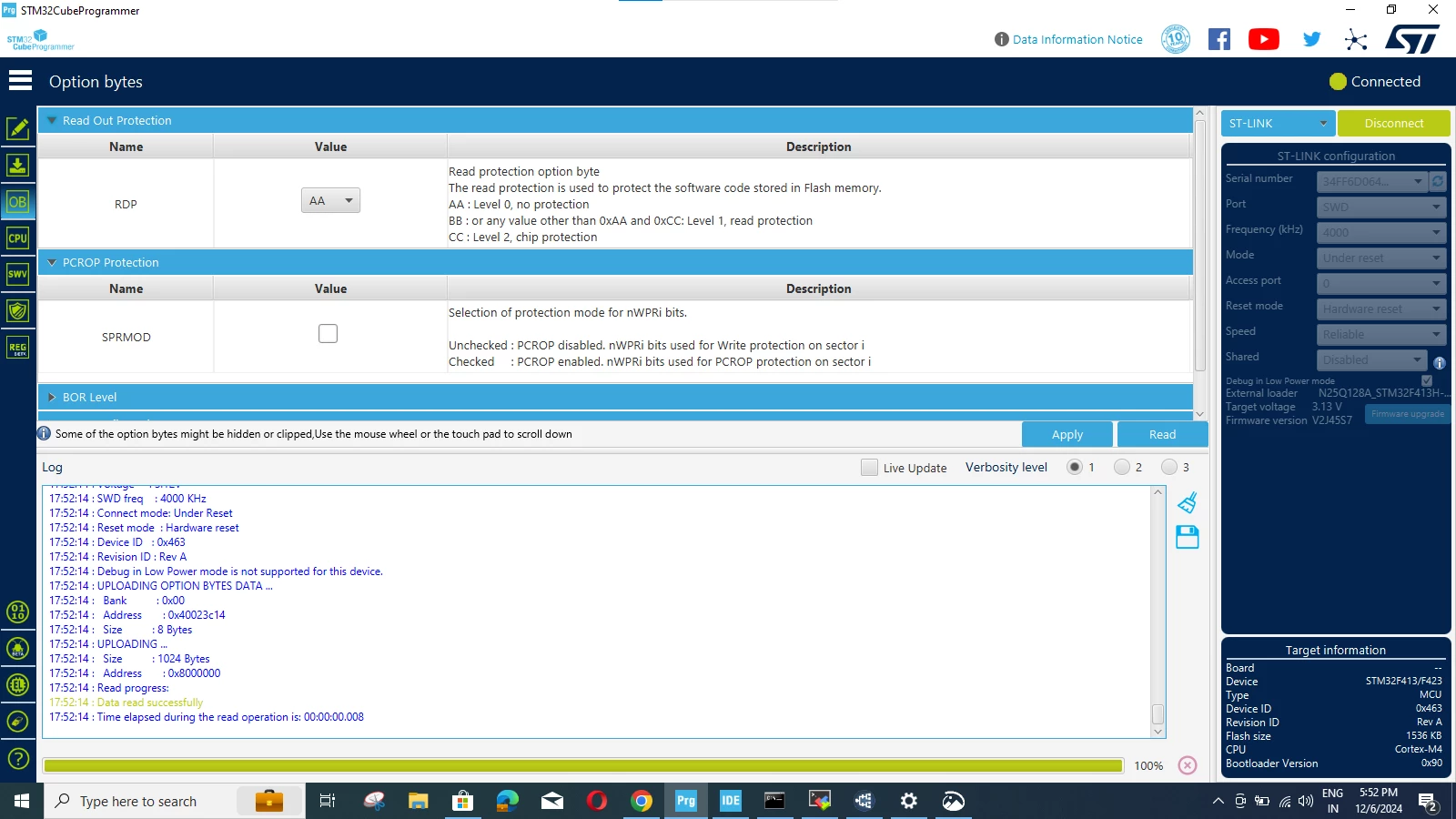

December 7, 2024

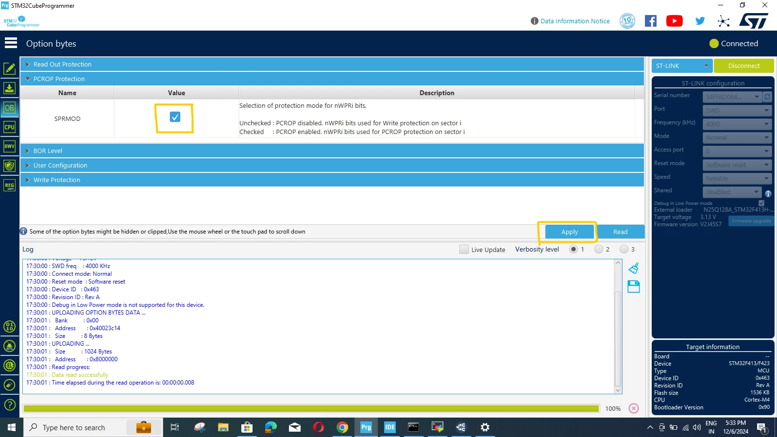

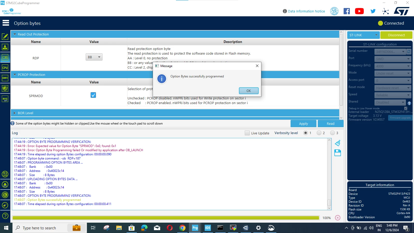

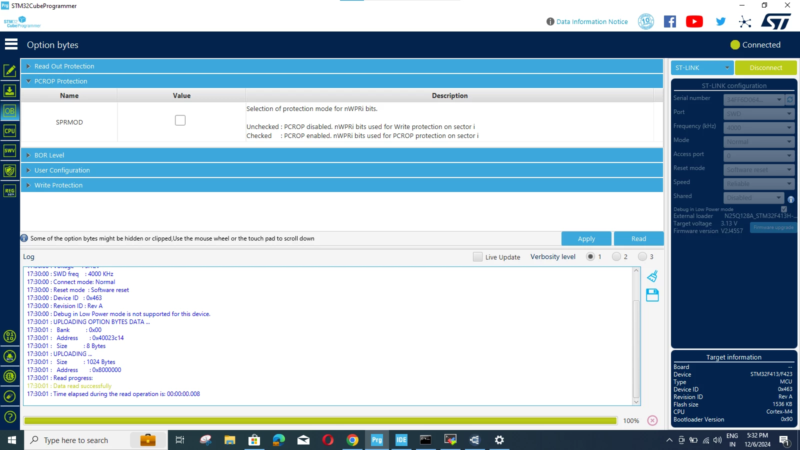

Enable and Disable the SPRMOD check box
ENABLE the SPRMOD:
Step1: Connect the MCU via JTAG/SWD
Step 2: Open the STM32CubeProgrammer or Download the STM32CubeProgram- Link: https://www.st.com/en/development-tools/stm32cubeprog.html
Step 3: Open STM32CubeProgrammer and press the Connect button.
Step 4: Go to Option bytes
Step 5: Check the SPRMOD
Step 6: Successfully Enable the flash protection

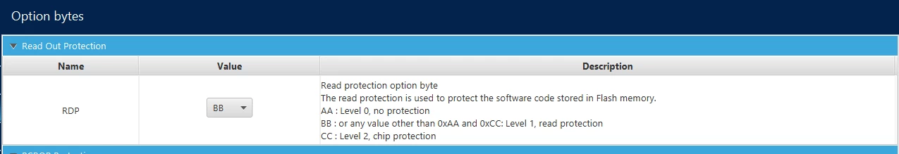

Disable the SPRMOD:

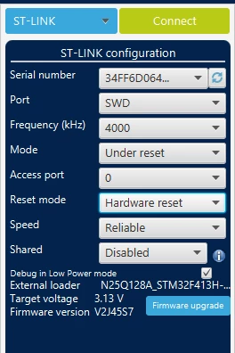

Step 1: MCU has RESET switch (SW 1). Press the Switch (Hardware Reset Switch)
Step 2: Disconnect the ST_Link
Step 3: Change the Mode to Under reset and Change the Reset mode to Hardware reset.
Step 4: After Connect the MCU via ST_Link

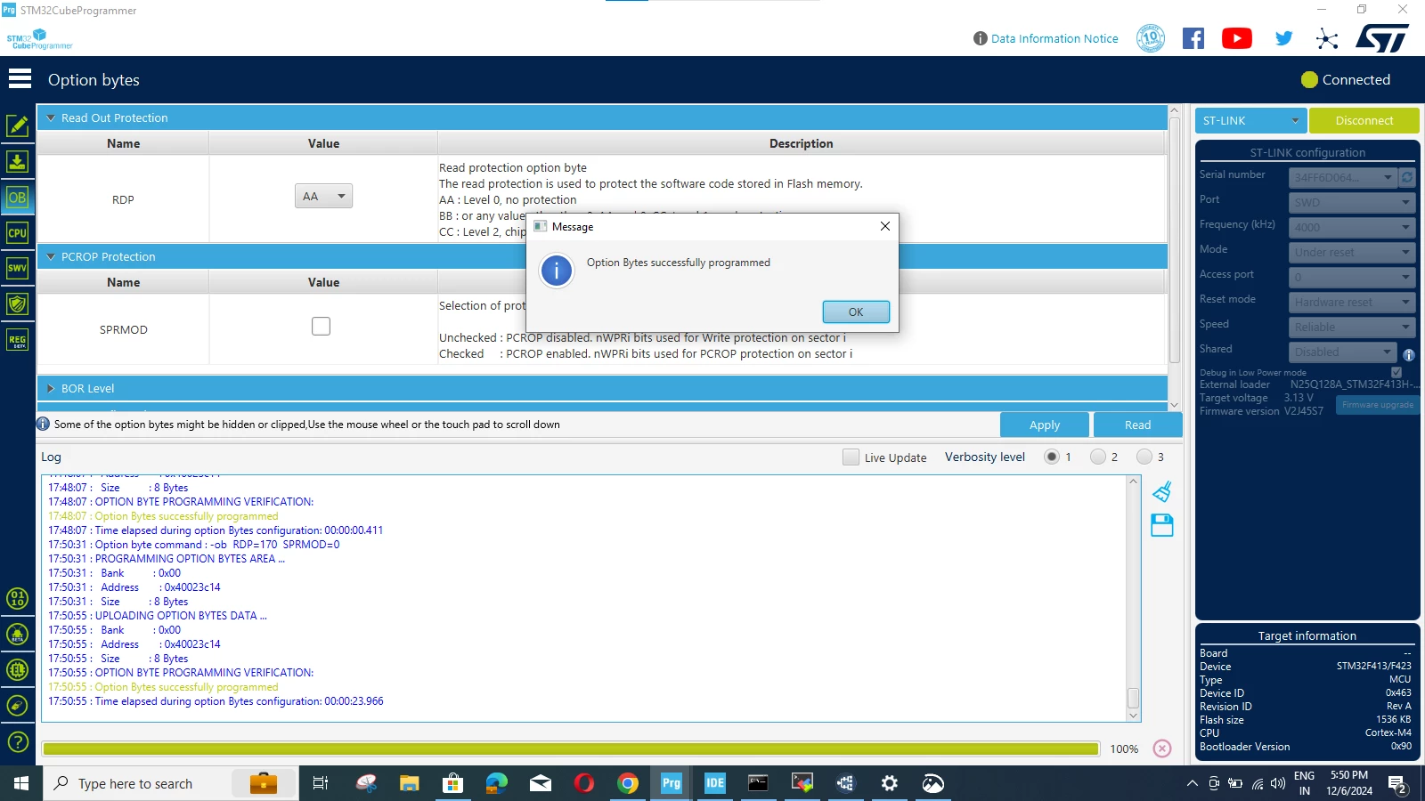

Step 5: Change the RDP from AA to BB
Step 6: Click Apply
Step 6: Change RDP to AA and Uncheck the SPRMOD
Step 7: Click Apply
Step 8: Finally Disconnect and Connect the MCU for checking process.
