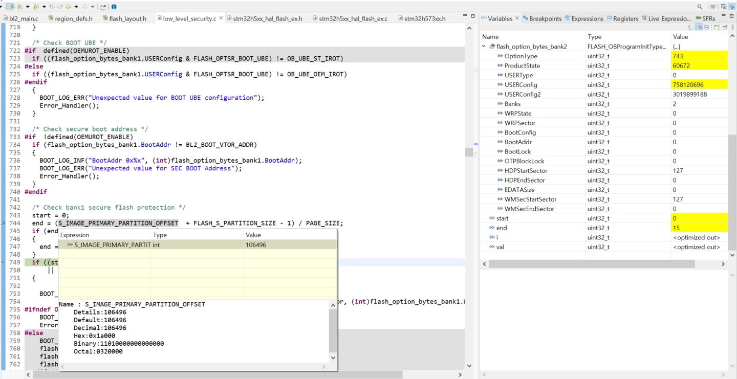

In the ob_flash_programming.bat file, sec1_end was set to 0x0E.
but In the code end value is set to 0x0F
end = (S_IMAGE_PRIMARY_PARTITION_OFFSET + FLASH_S_PARTITION_SIZE - 1) / PAGE_SIZE;
( end = 0x1E000 / 0x2000 = 0x0F )

S_IMAGE_PRIMARY_PARTITION_OFFSET = 0x18000
FLASH_S_PARTITION_SIZE = 0x6000
This makes 18000 + 6000 - 1 = 0x1DFFF
Divided by sector size 0x2000, I get 0xE

but I find diffrent points.
S_IMAGE_PRIMARY_PARTITION_OFFSET = 0x1a000
==>  FLASH_AREA_BEGIN_OFFSET = 0x18000
        FLASH_AREA_4_SIZE = 0x2000
and FLASH_S_PARTITION_SIZE = 0x6000.
is this issue causing from configuration?

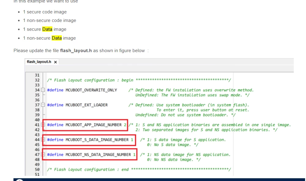

if FLASH_AREA_4_SIZE = 0x2000, this means you have changed the configuration in flash_layout.h adding the secure data image setting MCUBOOT_S_DATA_IMAGE_NUMBER to 1 instead of 0.

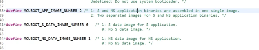

you mean. should I MCUBOOT_S_DATA_IMAGE_NUMBER  set to 0?
but according to example  MCUBOOT_S_DATA_IMAGE_NUMBER is set to 1
and I set the MCUBOOT_S_DATA_IMAGE_NUMBER to 0.
occured the following problem

I guess you set MCUBOOT_S_DATA_IMAGE_NUMBER = 1 or something equivalent.
Setting this changes the flash mapping.
To make your life easy, the new flash mapping is automatically computed and the scripts setting the options bytes configuration are updated.
The point is that, when using STM32CubeIDE, only .sh scripts are updated, not bat scripts that are used in case of IAR or Keil.
So, if you launch provisioning.sh instead of provisioning.bat it will work.
