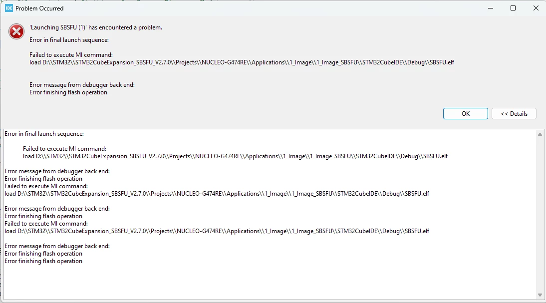

1.In STM32CubeIDE
'Launching SBSFU (1)' has encountered a problem.
Failed to execute MI command:
load ...\SBSFU.elf
Error finishing flash operation

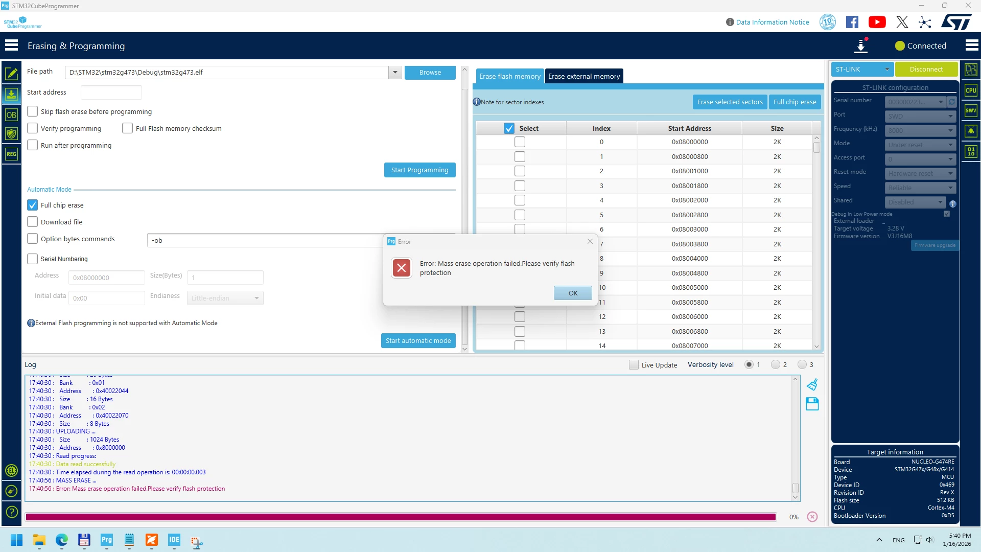

2. In STM32CubeProgrammer
  • Full chip erase fails
  • Mass erase fails with error:
  • Error: Mass erase operation failed. Please verify flash protection

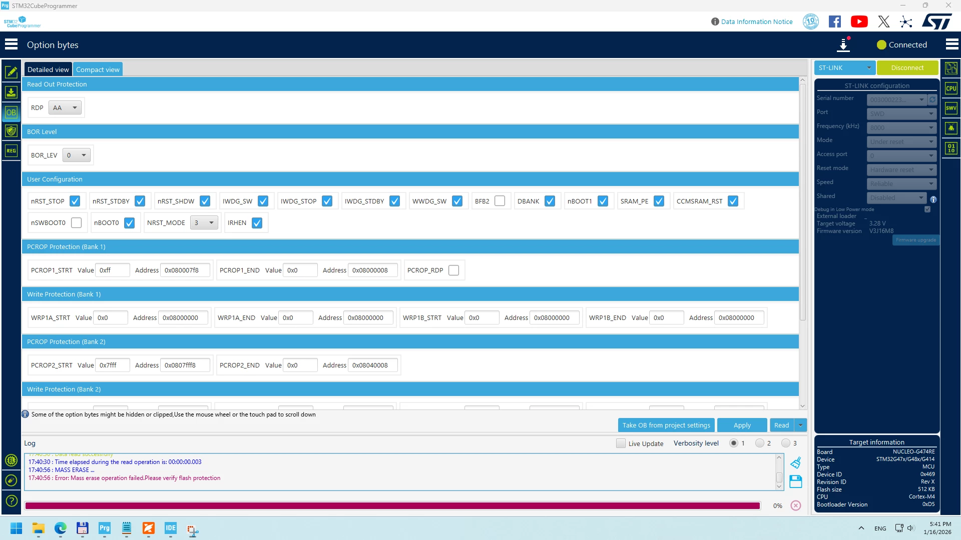

Option Bytes status
  • RDP = AA (Level 0)
  • PCROP and WRP were modified for SBSFU
  • After this change, the device seems to be locked and refuses erase/program operations

RogueOneAuthor
Jan 18, 2026 4:07 AM UTC
How to ensure STM32  FUS is Idle?
Jocelyn RICARD
Jan 26, 2026 6:55 PM UTC
Hello @RogueOne,
I notice that WRP START and END are all set to 0.
Could you try setting up Start values to 1?
Best regards
