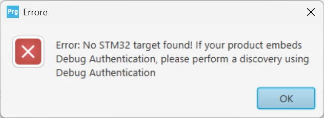

Hello ST Community,
Following your suggestion @Onizuka09, I developed a software program as per the example STM32H753_SecureMem_ExampleV1.1.
After updating the software, I noticed that the part for printing strings via UART (printf) was missing, but it had already been downloaded to the MCU and the software was started. After correcting the code for the printf prints, I no longer want to connect via ST-LINK to download the software to the MCU.
So, I try connecting with the STM32CubeProgrammer to attempt to erase all the flash memory. This popup appears:
Even if I change modes such as "Under Reset" and "Core Reset," this popup appears:
I'm afraid that when the software started, even without seeing the strings in printf via UART, it may have set some security parameters, or option bytes, or disabled Boot for CM7 and CM4.
The software had an option that allowed you to reset those parameters and return to the ST-LINK connection mode without any problems.
So, is there a way to connect to the STM32CubePRogrammer and reset the above parameters to default?
I also tried entering the bootloader by setting VDD for boot0 to high, but the bootloader doesn't activate.
Any ideas for resetting everything?
Thanks for your valuable support.

I suspect a bad power configuration:
“no stm32 target found! if your product embeds debug authentication, please perform a discovery using debug authentication on STM32H755”
“ I developed a software program as per the example STM32H753_SecureMem_ExampleV1.1.”
What board are you using? Nucleo-H755? if yes what power configuration you set in your software for that board? SMPS or LDO? for that board you need to set it to Direct SMPS.
If you set it to LDO you’ve temporarily broken the target and you need to recover it by following this knowledge base article:
How can I recover my STM32H7/STM32H7RS board after facing a power configuration deadlock?

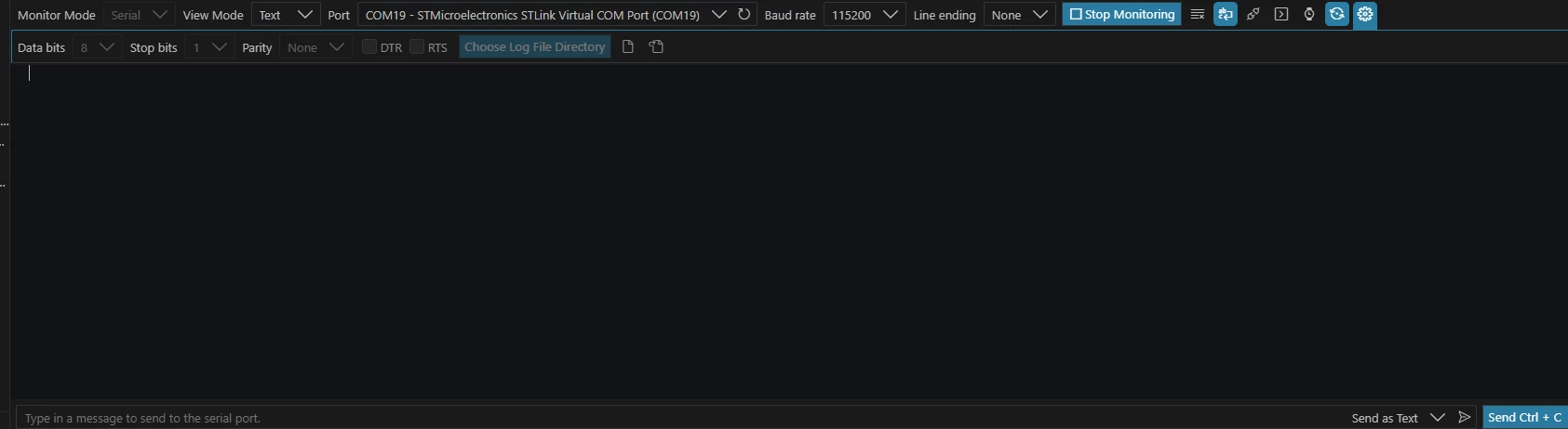

    Using a UART terminal, configure the UART settings and then send s to reset the security bit.
  • Wait a while.
  • Then power-cycle the board again and try connecting with STM32CubeProgrammer .
B.R
Domy_STAuthor
Jun 10, 2026 12:23 UTC
hello ​@Onizuka09 ,
The problem is that without having included this function in the code:
int _write(int file, char *ptr, int len)
HAL_UART_Transmit(&huart3, (uint8_t *)ptr, len, 1000);
return len;
Since then, I haven't even seen the options to configure bit security on the UART terminal. I know that you have to reset the security options by typing the s. command to connect an STM32CubeProgrammer, but the UART terminal won't display anything due to the lack of the above code.
Is there another way to reset bit security?

Yes, you will be sending the 's' character without any visual feedback.
Although you haven't added the proper code to configure the UART transmission, the reception part should still work — so the board should be able to receive the 's' character correctly.
There isn’t another way to deactivate the security bit.
Domy_STAuthor
Jun 10, 2026 14:03 UTC
hello ​@Onizuka09,
I've already tried sending the character "s" even without any visual feedback, and it didn't change anything.
If there's no other way, then this card should basically be thrown away.

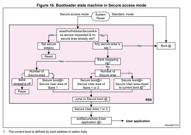

At boot, the system jumps to RSS first. If it detects that a secure area is enabled, it will automatically jump to that secure area before even executing the bootloader or the user application (as shown in the state machine diagram above). Once in secure memory the board is closed.
I would recommend keep trying. When an led should be blinking however when the board is receiving, the LED that turns off,  did you notice that happening ?
Also, you can try the following recovery options using the menu commands:
  • RDP Regression: Set the board to RDP Level 1 by sending 'P', then send 'R' to trigger the regression. When running the regression command, make sure to give it some time to complete.
  • Jump to application: If you have already downloaded your application, try jumping to it by sending 'e'.
  • Download application: You can also download the user application by sending 'd'. Note that this uses the YModem protocol, and then jump to it.
 Also when sending the characters make sure you configured the serial monitor properly. In my case i used vscode serial monitor extension:!-->
