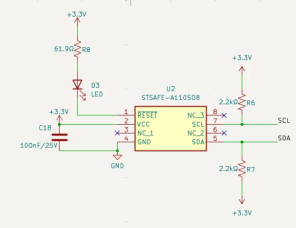

We currently have a prototype based on a custom STM32H5 MCU, and for testing purposes we have used an X-NUCLEO-SAFEA1B board. The testing was successful, and we are now moving forward with the design of the actual product, which will be a custom PCB containing both the STM32H5 MCU and the STSAFE-A110 chip.
I have two questions:
  1. Can we reuse the current code generated using CubeMX and the X-CUBE-SAFEA middleware on our custom PCB?
  2. Are the connections for the STSAFE-A110 correct?
Any help would be much appreciated. Thank you.

2. STSAFE-A110 Connection diagram
The connection diagram looks correct, and the STSAFE-A110 should function properly. A few comments below:
  • /RESET line
If the /RESET pin is not driven by the host, which appears to be the case in your design, we usually recommend tying it directly to VCC.
In the current implementation, the LED would never switch on, which may introduce unnecessary BOM cost.

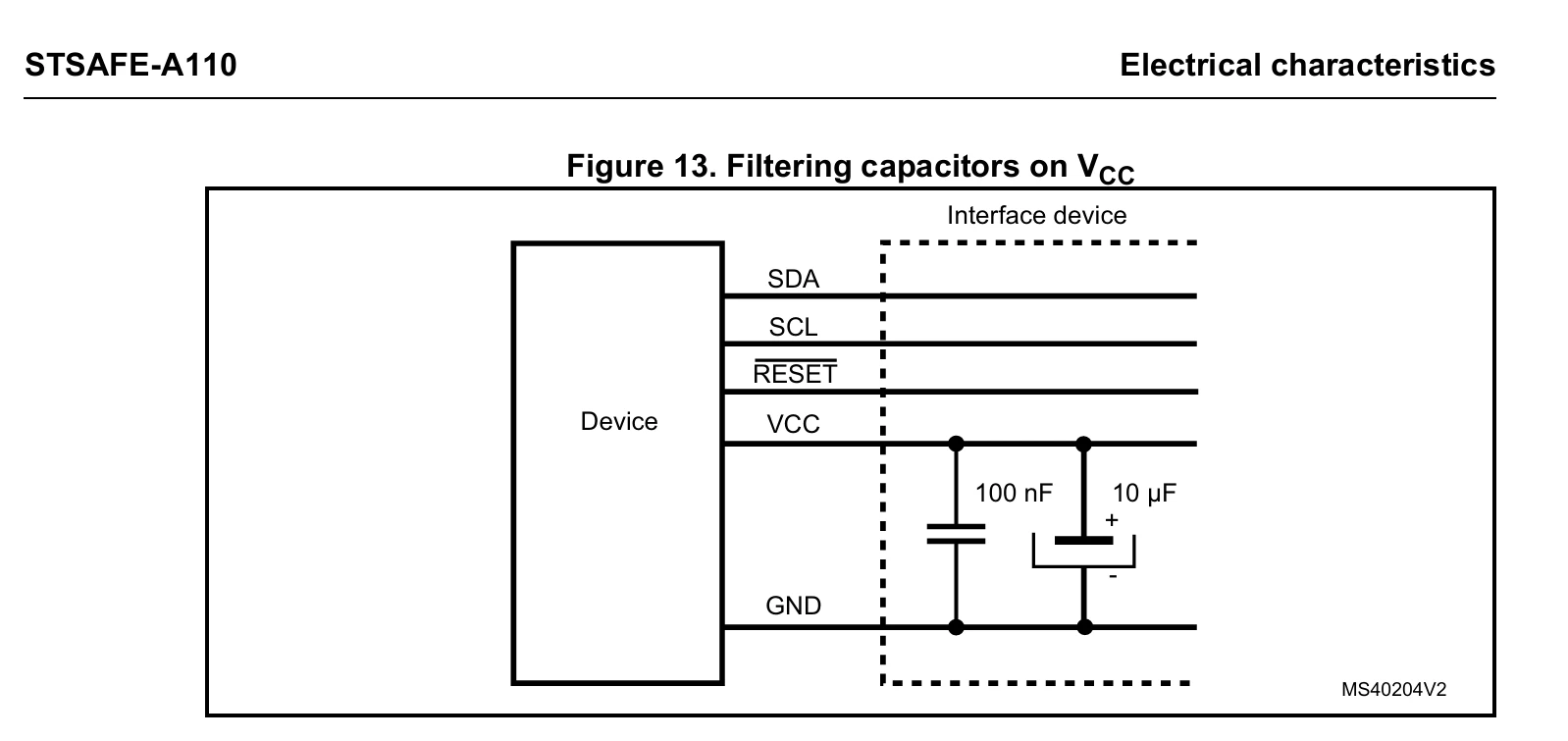

  • Decoupling capacitor
As recommended in the datasheet, standard decoupling capacitors should be placed very close to the VCC and GND pins.
This helps stabilize the supply rail, especially when the power source is not local or when multiple transient events occur.
Please see the datasheet extract below.
