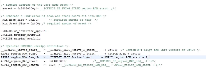

Hi Team,
I resolved the issue by changing the compiler optimization to -none, and it started working as expected. However, I'm facing one more issue: the application launches when SFU_MPU_PROTECT_ENABLE is disabled. Otherwise, the bootloader keeps launching every 5 seconds as the watchdog timer resets.
Could you guide me on this issue? This happened after I changed the User Application RAM region to 512KB.
Regards,
Prakash
I have attached screenshot of the user App linkerfile I have changed
