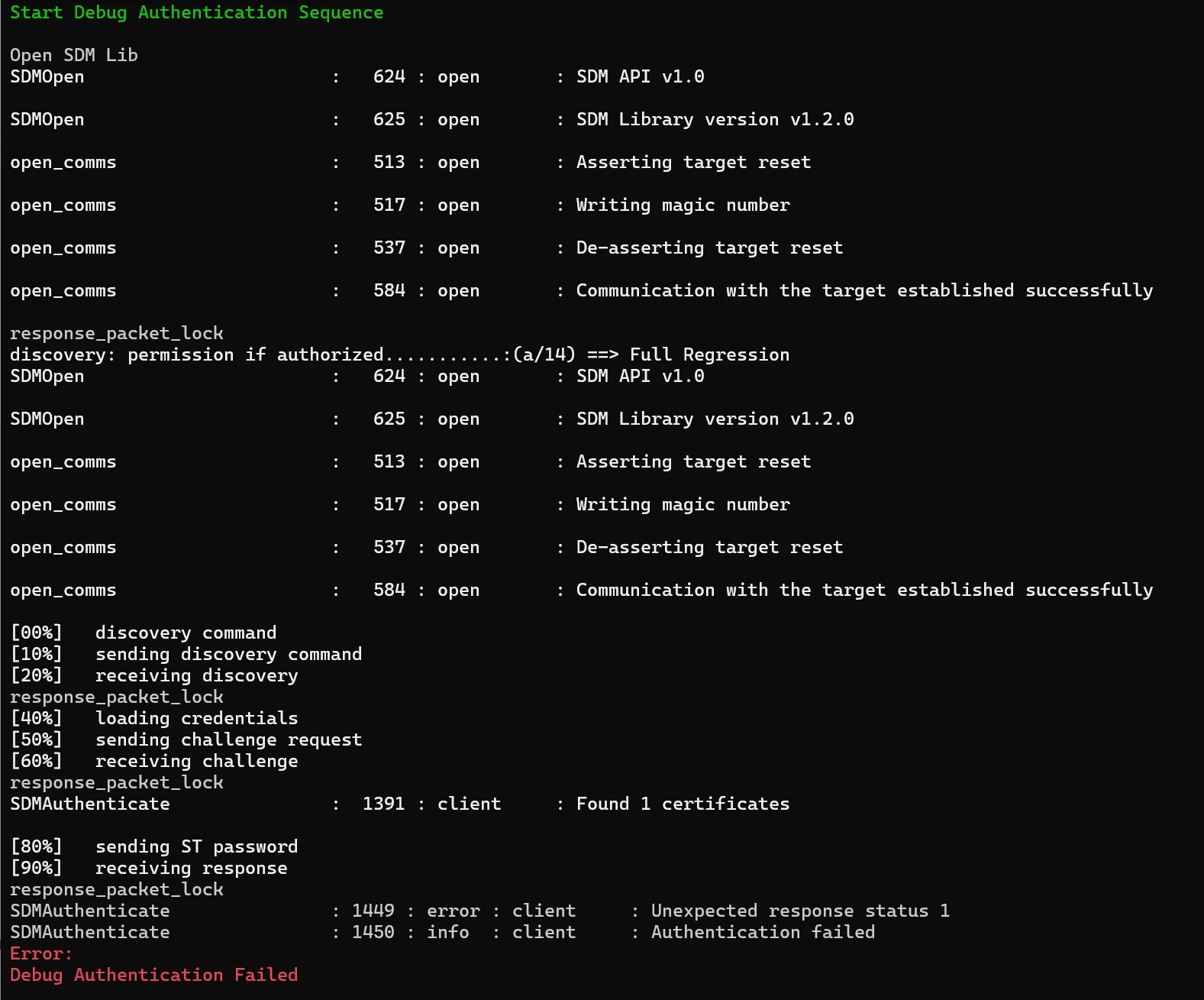

But i also tried to open a debug session. Without success. CubeProgrammer says, that I am able to make full regression only, while Cube IDE asks for certificate DA.
I know, that certificate auth method is valid with TZEN=1 only, but I tried to provision that obk with TZEN=0.
As a result, I Have this:
The default ST password from CubeProgrammer's folder is not working,
I tried to provide all-zeros and all-FF password without success.
But maybe I need to change something in the header. Or change a password length.

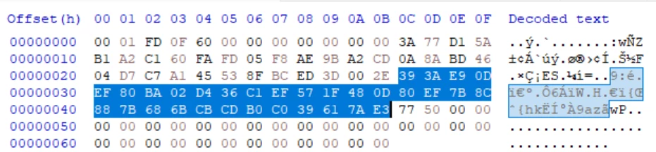

  3. Open ConfigWithCertificate.obk  with Hex Editor and take 32 bytes from 0x2C offset: hash in OBKhash in OBK
     this is a hash, stored in stm32 chip.

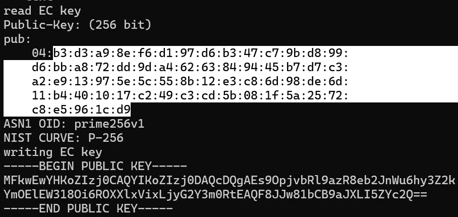

  4. run shell command openssl ec -pubin -in Da_root_key_pub.pem -textKonstantin_Z_0-1758201323813.png,
    You will see 65 bytes of the public key. We need the 64 bytes from the second byte only. Copy them to your Hex Editor and give a filename password.bin
  5. Check the SHA-256 hash of this file. Here, for example. The hash should be the same as one at the 3rd stage.

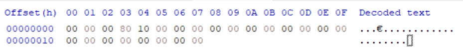

  6. Add the header "00 00 00 80 40 00 00 00" to your password.bin
  7. Use this password.bin with the DA autentification and make a full regression.
