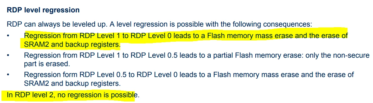

I am working on RDP programming on STM32U575 . My query is how can i perform RDP 2 to RDP 1 regression(or RDP 1 to RDP 0) using OEM keys in my firmware ?
I found an application note for regression of RDP level using OEM keys via STM cube CLI .
But my use case is to do it by firmware .
Can it be done ?
/Jaroslav HOUDEK​  @zqizh.1​
2 replies
Apr 18, 2022 1:19 PM UTC
RDP2 is irreversible.
RDP1 to RDP0 is possible, but causes your chip to be erased which makes it difficult/impossible to do within your firmware while still retaining control.

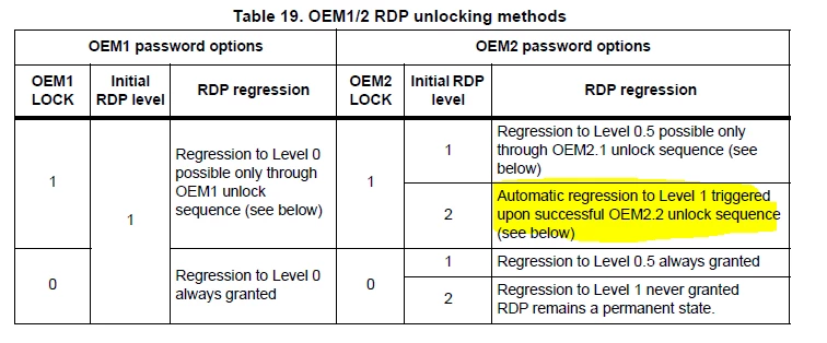

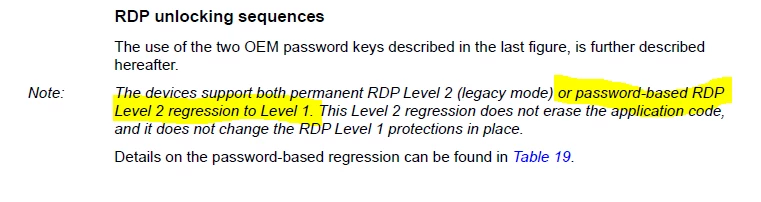

@TDK​  This snip is from rm0456 application note for STM32U5x5
They have supported a regression from RDP2 to RDP 1 using passwords
