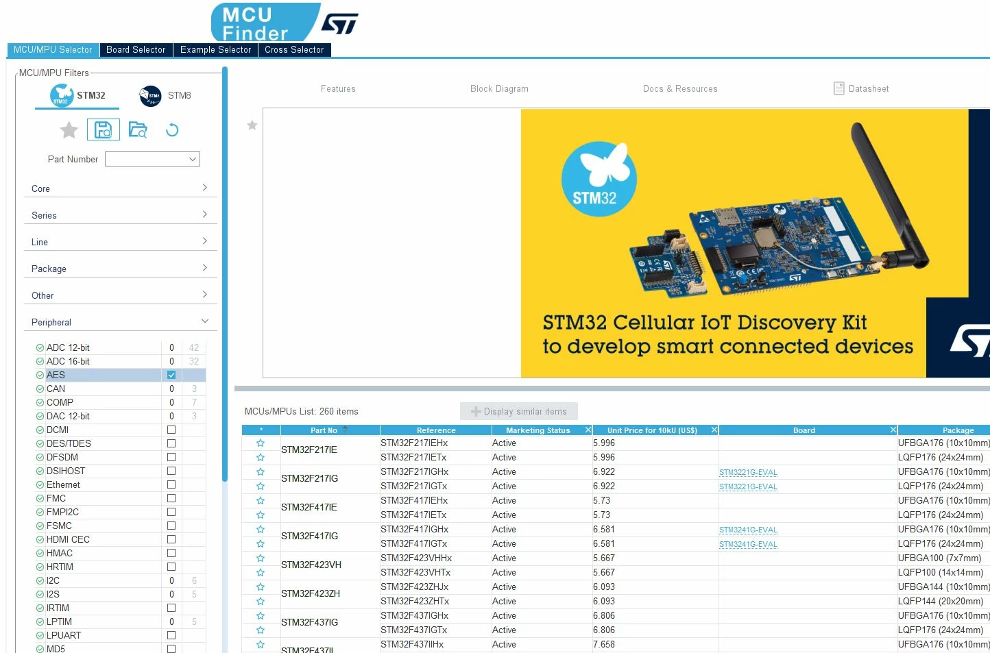

I recommend you to use the "MCU Finder" tool (mobile version, PC version) or the one integrated in STM32CubeMX, to fine tune your choice based on multiple criteria and select the suitable one(s).
You can also compare MCU/MPU characteristics using "Cross selector" feature.
Regarding STM32F410 it's doesn't contain cryptographic functions.

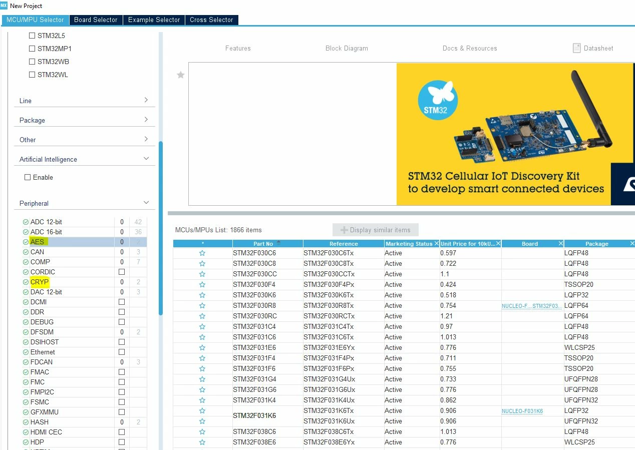

Alsa I don't have CRYP in list..
