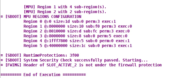

I am trying STM32CubeExpansion_SBSFU_V2.4.0 with 2 Active images and 2 Download areas and assigned the LOcation in mapping_fwimg.icf. Code is building but i am getting error = "[FWIMG] Header of SLOT_ACTIVE_2 is not under the firewall protection"
0693W00000ANle9QAD.pngPlease guide me how to add SLOT_ACTIVE_2 to firewall protection.

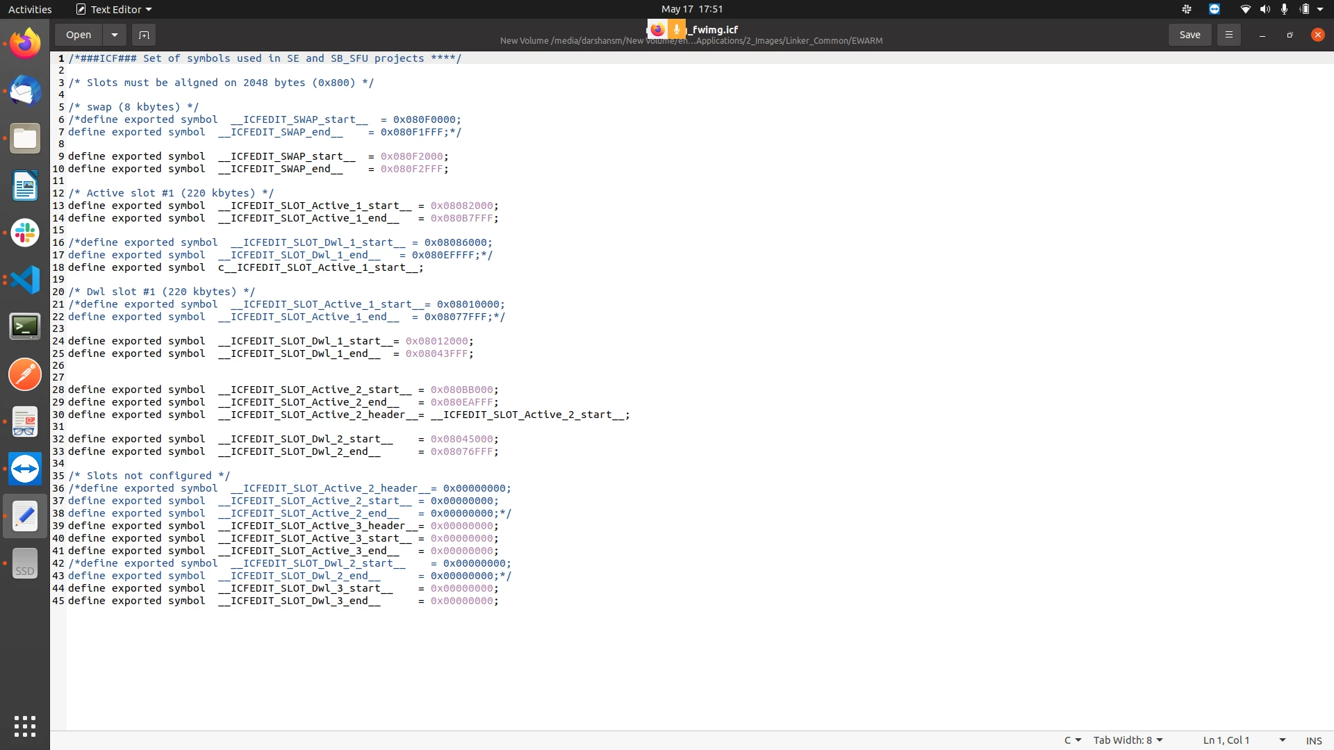

0693W00000AOdXMQA1.pngThere is only one project on L476RG in​ STM32CubeExpansion_SBSFU. It is working with out any issue. But I added 2 active and 2 download slots by modifying Macros SFU_NB_MAX_ACTIVE_IMAGE and SFU_NB_MAX_DWL_AREA. And even i added memory locations in mapping_fwimg.icf. Please refer the image attached. I am getting error SLOT_ACTIVE_2 is not under firewall protection.

while SBSFU 2-image code supports automatic configuration of up to 6 slots, you cannot have more than 3 slots of one kind automatically configured by the code. Please see the declarations in sfu_fwimg_regions.h
So while 3 active and 3 download works without any modification to the provided SBSFU, to actually get 4 slots of one kind you need to change the SBSFU code significantly. I believe it's possible to make it work in the end, but to be honest, I see no practical use for 4 active slots.
