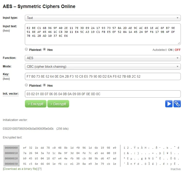

Ok, this online calculator was written by someone competent
http://aes.online-domain-tools.com/

nanotronicsnss
May 1, 2020 2:11 AM UTC

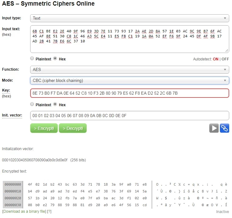

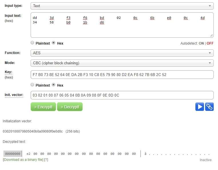

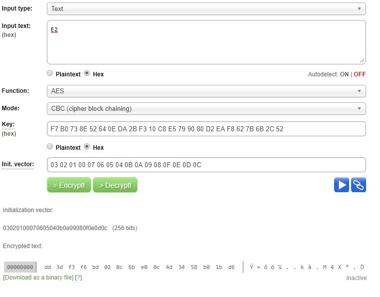

0693W000000WmEAQA0.jpg0693W000000WmE5QAK.jpgThanks for your reply .. i just need some more clarifications..
1.when I give a 1 byte(8 bit) of input data the output encrypted text is about 16 bytes(128 bits).. Is the length of encrypted data has a minimum length of 16 bytes?.. i have cross verified the result and its correct(inserted as images)
2. In the stm32h7xx library example the encrypted text array does not match with the encrypted text obtained from the website..kindly help for a clarification
FROM LIBRARY EXAMPLE:
uint32_t AESKey192[6] = {0x8E73B0F7 ,0xDA0E6452 ,0xC810F32B ,0x809079E5 ,0x62F8EAD2 ,0x522C6B7B};
/*Initialization Vector*/
uint32_t AESIV_CBC[4] = {0x00010203 , 0x04050607 , 0x08090A0B , 0x0C0D0E0F};
/* Plaintext */
 uint32_t Plaintext[16]     = {0x6BC1BEE2 ,0x2E409F96 ,0xE93D7E11 ,0x7393172A ,
                   0xAE2D8A57 ,0x1E03AC9C ,0x9EB76FAC ,0x45AF8E51 ,
                   0x30C81C46 ,0xA35CE411 ,0xE5FBC119 ,0x1A0A52EF ,
                   0xF69F2445 ,0xDF4F9B17 ,0xAD2B417B ,0xE66C3710};
/* Expected CBC Ciphertext with AESKey192*/
uint32_t CiphertextAESCBC192[16] = { 0x4F021DB2 ,0x43BC633D ,0x7178183A ,0x9FA071E8 ,
                  0xB4D9ADA9 ,0xAD7DEDF4 ,0xE5E73876 ,0x3F69145A ,
                  0x571B2420 ,0x12FB7AE0 ,0x7FA9BAAC ,0x3DF102E0 ,
                  0x08B0E279 ,0x88598881 ,0xD920A9E6 ,0x4F5615CD};

Not sure I can invest that much time into this. Would probably look to see if there are some endian issues with the settings.
Tesla DeLorean
Guru
May 1, 2020 5:41 PM UTC
hcryp.Init.DataType  = CRYP_DATATYPE_32B; // Takes data Big Endian format
