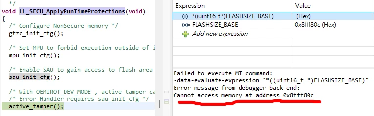

I am using STM32H563 with OEMiROT_Boot example project, I got a problem to read the FLASH_SIZE register (0x08FFF80C).
I found two issues,
(1) the value of this register is 0 at begining of OEMiROT_Boot main() function.
(2) the register become not accessable after sau_init_cfg().

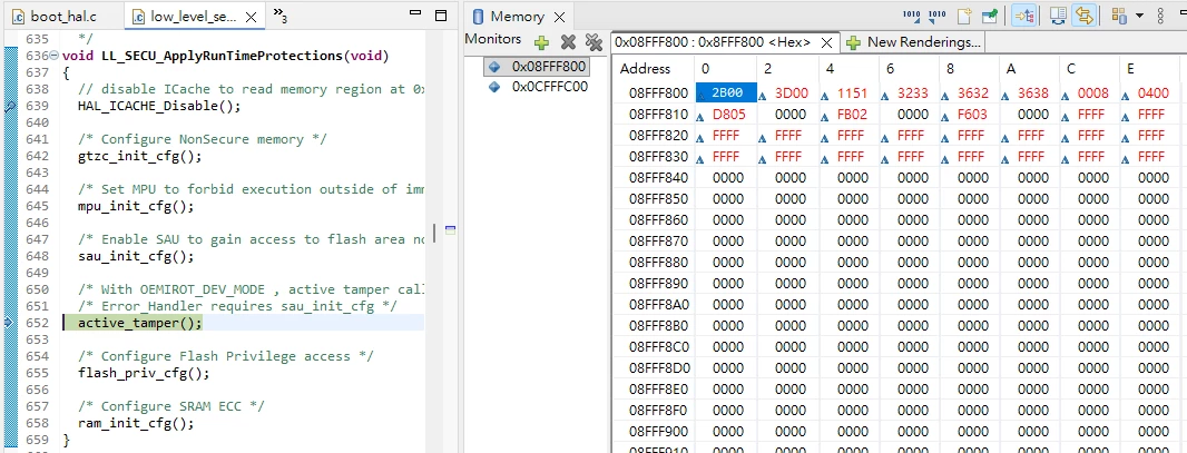

SnakuAuthor
Dec 8, 2025 2:16 AM UTC
Hi Jocelyn,
After I disable the ICache, I can read the memory region at 0x08FF_F800 now.
I follow your instruction,
(1) reuse original configuration for MCU and SAU initial settings in the OEMiROT_Boot Project (i.e., no change in the region_cfg_init_s[ ] and region_sau_init_cfg[ ] array).
(2) I just add 'HAL_ICACHE_Disable();' at line 639.
then the data of the memory 0x08FF_F800 can be read correctly when the CPU run to the line 652.
Thanks for your support.
