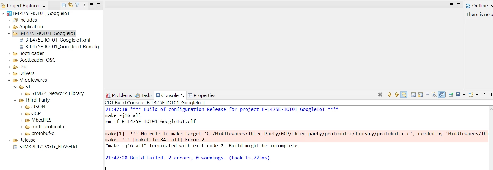

How to import and build X-CUBE-GCP 2.0 in STM32CubeIDE Ver 1.9.0??
  • March 19, 2022
  • 1610 views
As title. I imported project and try to build code. But got error as below:
21:47:18 **** Build of configuration Release for project B-L475E-IOT01_GoogleIoT ****
make -j16 all
rm -f B-L475E-IOT01_GoogleIoT.elf
make[1]: *** No rule to make target 'C:/Middlewares/Third_Party/GCP/third_party/protobuf-c/library/protobuf-c.c', needed by 'Middlewares/Third_Party/protobuf-c/library/protobuf-c.o'. Stop.
make: *** [makefile:84: all] Error 2
"make -j16 all" terminated with exit code 2. Build might be incomplete.
21:47:20 Build Failed. 2 errors, 0 warnings. (took 1s.723ms)

Updated status. Any idea how to fix this error???
Description Resource Path Location Type
cannot use executable file '../../../../BootLoader_OSC/2_Images_SBSFU/STM32CubeIDE/B-L475E-IOT01_2_Images_SBSFU/Debug\se_interface_app.o' as input to a link B-L475E-IOT01_GoogleIoT C/C++ Problem
Thanks.​

Hello @AHuan.9​ ,
This is a known issue for which I made a dedicated post here:
https://community.st.com/s/question/0D53W00001PwBDDSA3/issue-building-sbsfu-with-latest-stm32cubeide-190-here-is-the-solution
Best regards
